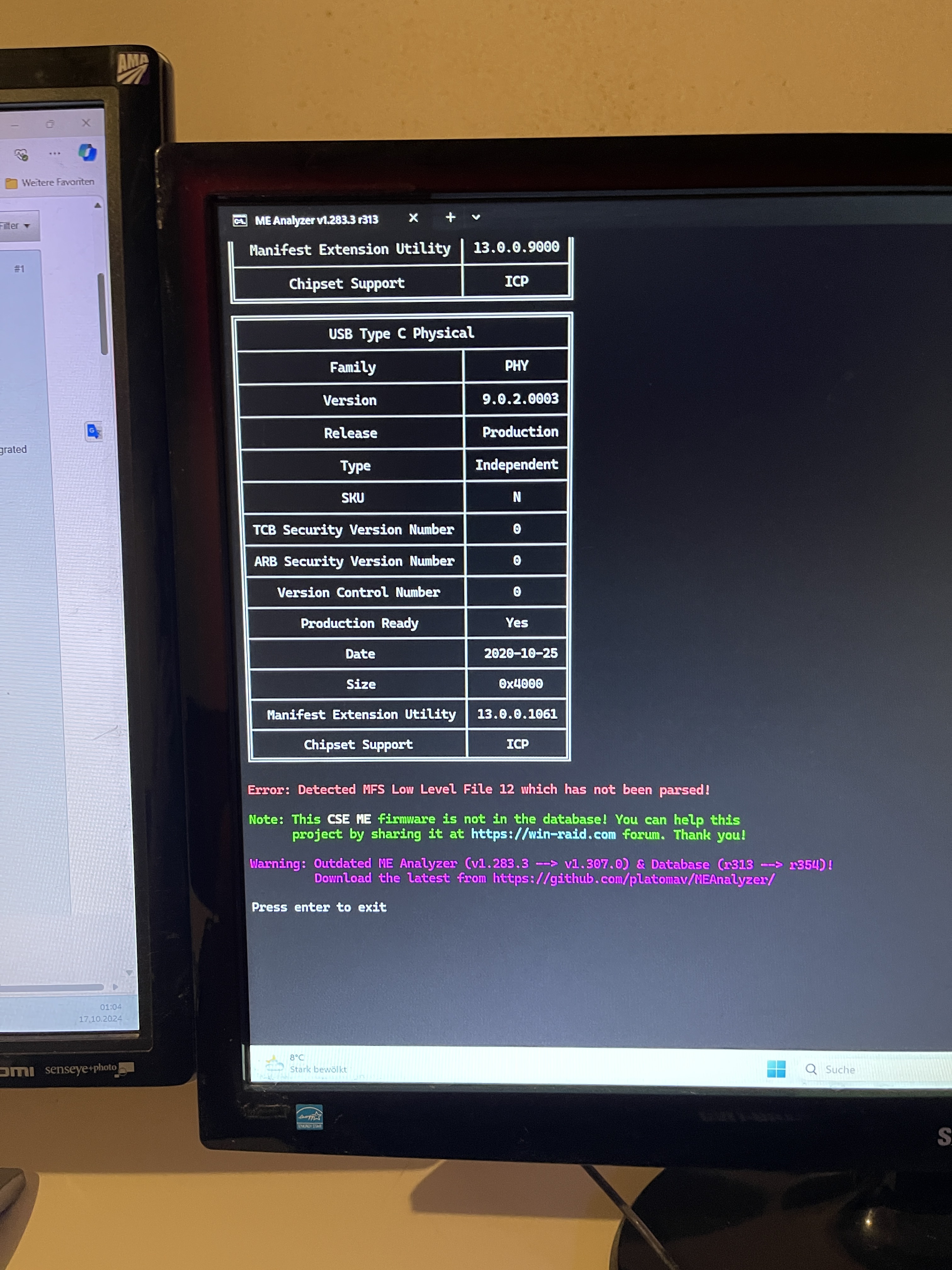

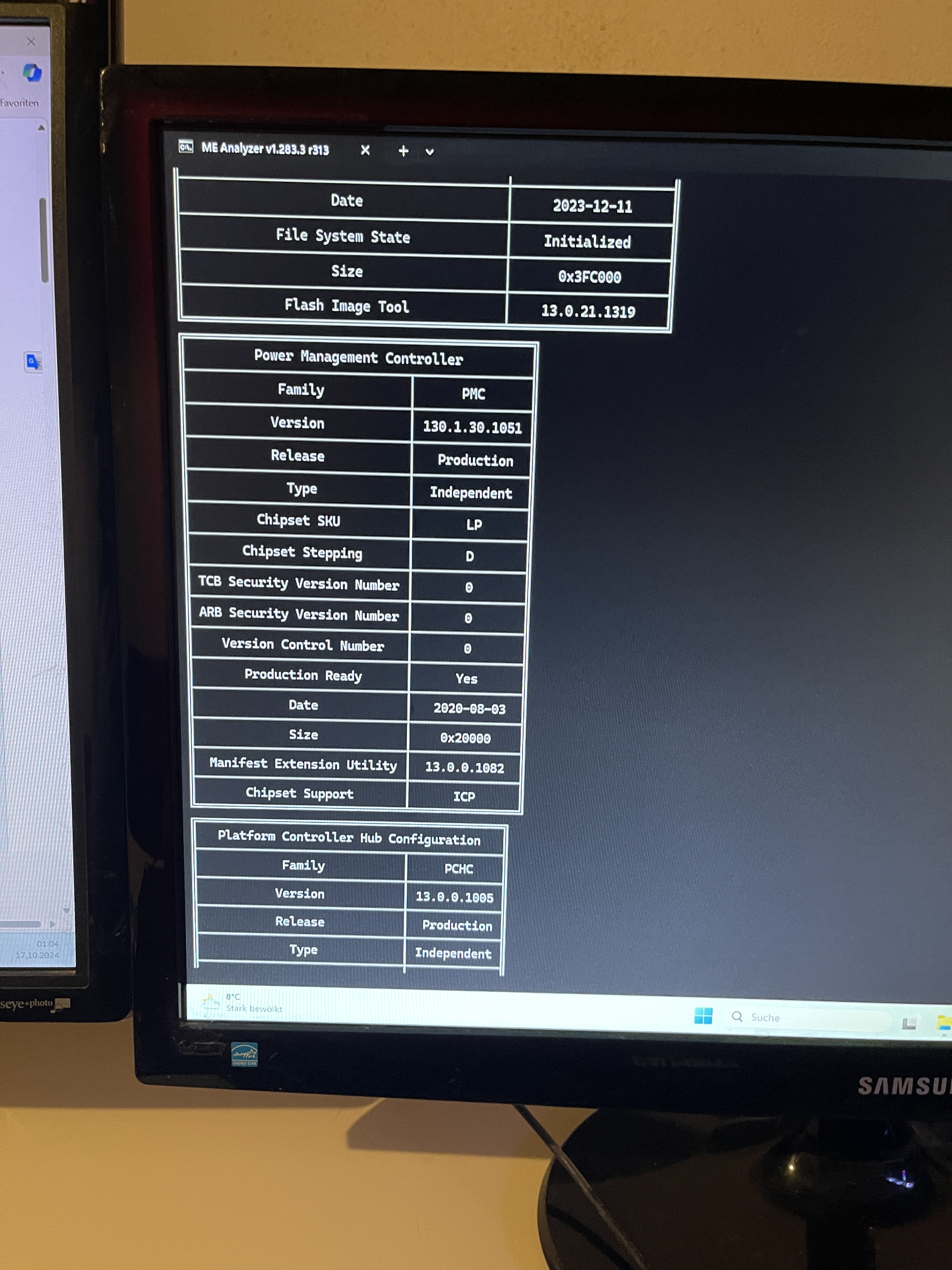

        Hello Community,
        I'm experiencing an issue with my touchscreen. My Surface had a broken display, but the touchscreen was working perfectly fine. After replacing the display, the touchscreen initially worked on the new one, but a day later, it stopped functioning completely. It doesn’t even work in the UEFI menu anymore.
        I’m not sure if an update was downloaded in the meantime, or if it just stopped working on its own. I've tried several solutions: resetting the tablet multiple times, reinstalling the drivers, and even doing a full recovery reinstallation of Windows from a USB stick.
        Could performing an ME Clean help? The touchscreen issue isn’t mentioned as symptom in guides on this forum.
        Attached is the BIOS dump of my Surface Pro 7, in case anyone has any ideas on what might be causing this.
        Surface Pro 7 i5/256GB/8GB
        Model:1866
        S/N: 058020604853​

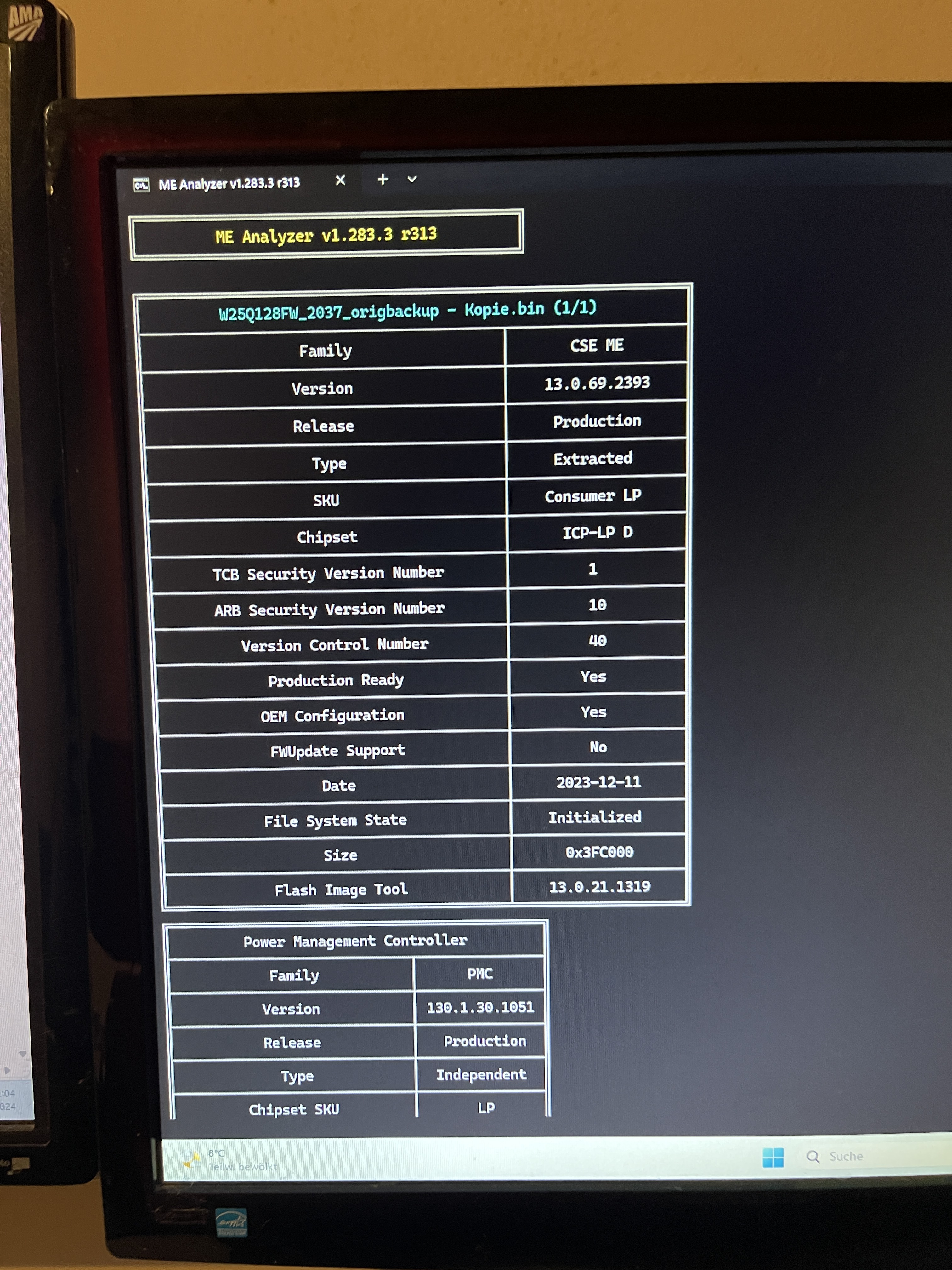

              #326
              Im so sorry , i am stupid again i read the whole time the wrong flash. I testet the file by me analyzer, but i think it was encryptet. Now i have the right one.
              Issue: at start only 3 seconds Windows logo
              Model: Surface 7 Pro 1866
              SN: 051464104753
              Thx

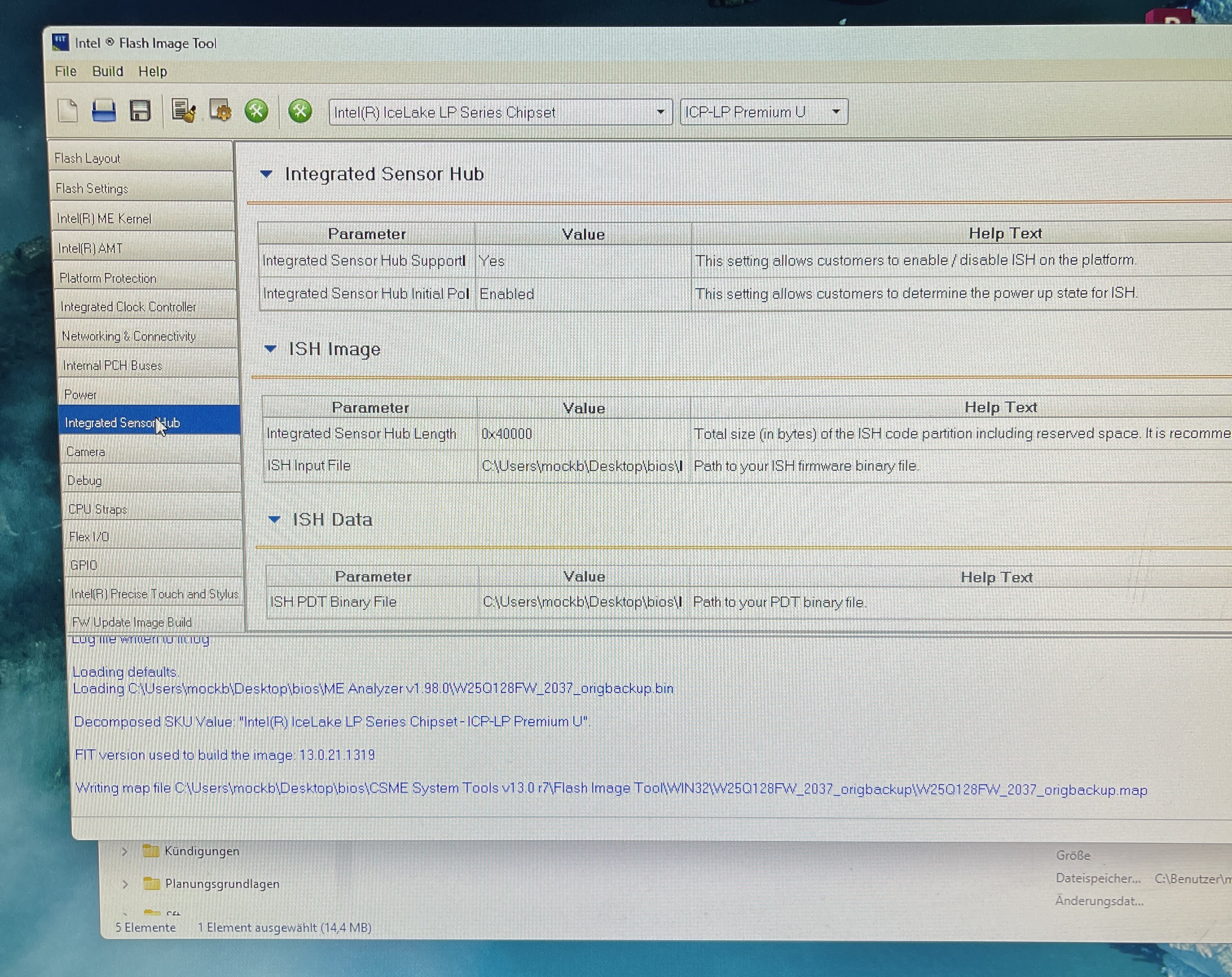

                #327
                Originally posted by peste
                Hello again,
                I followed this guide ("https://www.badcaps.net/forum/troubl...e-fix?t=104153") (in my case, it's number 2 (-> "Integrated Sensor Hub Supported" is set to "YES")), and I cleaned the ME following this guide (https://www.badcaps.net/forum/troubl...cleaning-guide).
                My problem is that in step 5, I need to overwrite the new "ME Region.bin" with the existing "ME Region.bin" in the decomp folder, but I don’t have an original "ME Region.bin" in the decomp folder at all. I tried just placing the new ME Region in the decomp folder, but now I’m stuck in a boot loop (Windows logo for 3-5 seconds, then the Surface turns off).
                What am I doing wrong?
                Thanks in advance for your help!

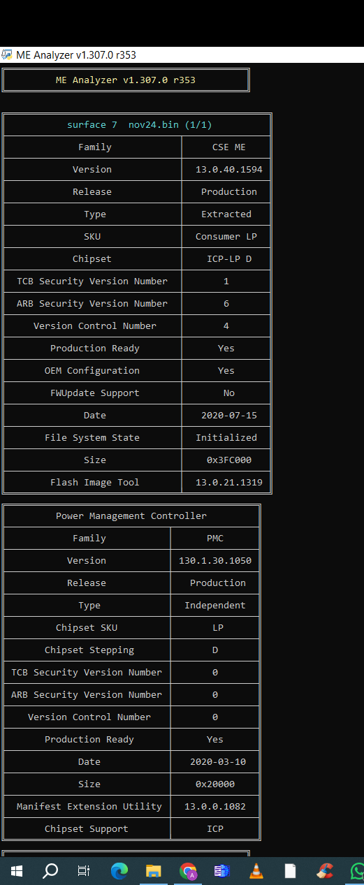

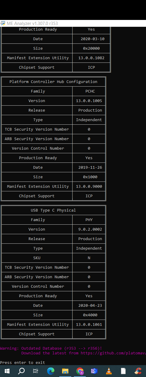

                        #331
                        Hello from Spain.
                        My Surface Pro 7 is blocked in logo screen for a few seconds and then turn off. I`ve tried to flash spi chip with a bios bin take from the here, but the result is thee same. I believe that my bios is corrupted, but I can´t manage to fix ME region.
                        Can anybody help me to clean ME Region from my bios Surface Pro7?
                        I`ve tried with ME Inject and with Fit tools, but ever with error message?
                        Surface M 1886
                        S.n. 010285504053
