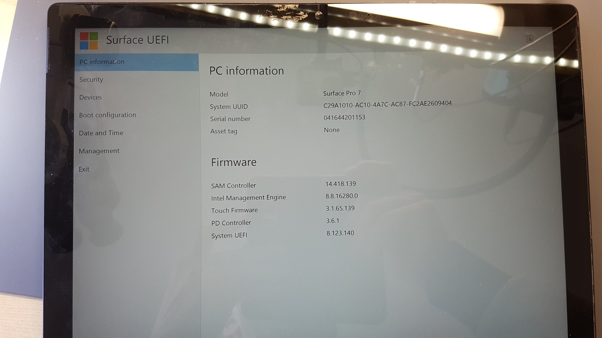

      Device booted with your dump!
      I can see now the touch firmware version also, but touch still does not work.
      Device was brought to me already disassembled, even if screen not broken, touch could be defective itself.
      Regarding the MDM/DFCI , I suppose I should try to update firmware in windows to see if everything is good?
      Ive seen that bitlocker is active, so I couldnt get to login screen
      Thanks again for your help!

        @magneh
        Try to check Touch connector, ripped flat cable, etc.
        Have you tried to use your own "bkp.zip" (post #29) file? to me seems to have the correct structure, have patched the SetOEMString UEFI variable too on this one.
        (The other "original.zip" file from post #29 is damaged)

          Hello AAAC!
          Thanks for checking that bkp.zip dump.
          Ive just tried it, and it works!
          Same touch firmware version, but now works perfectly.
