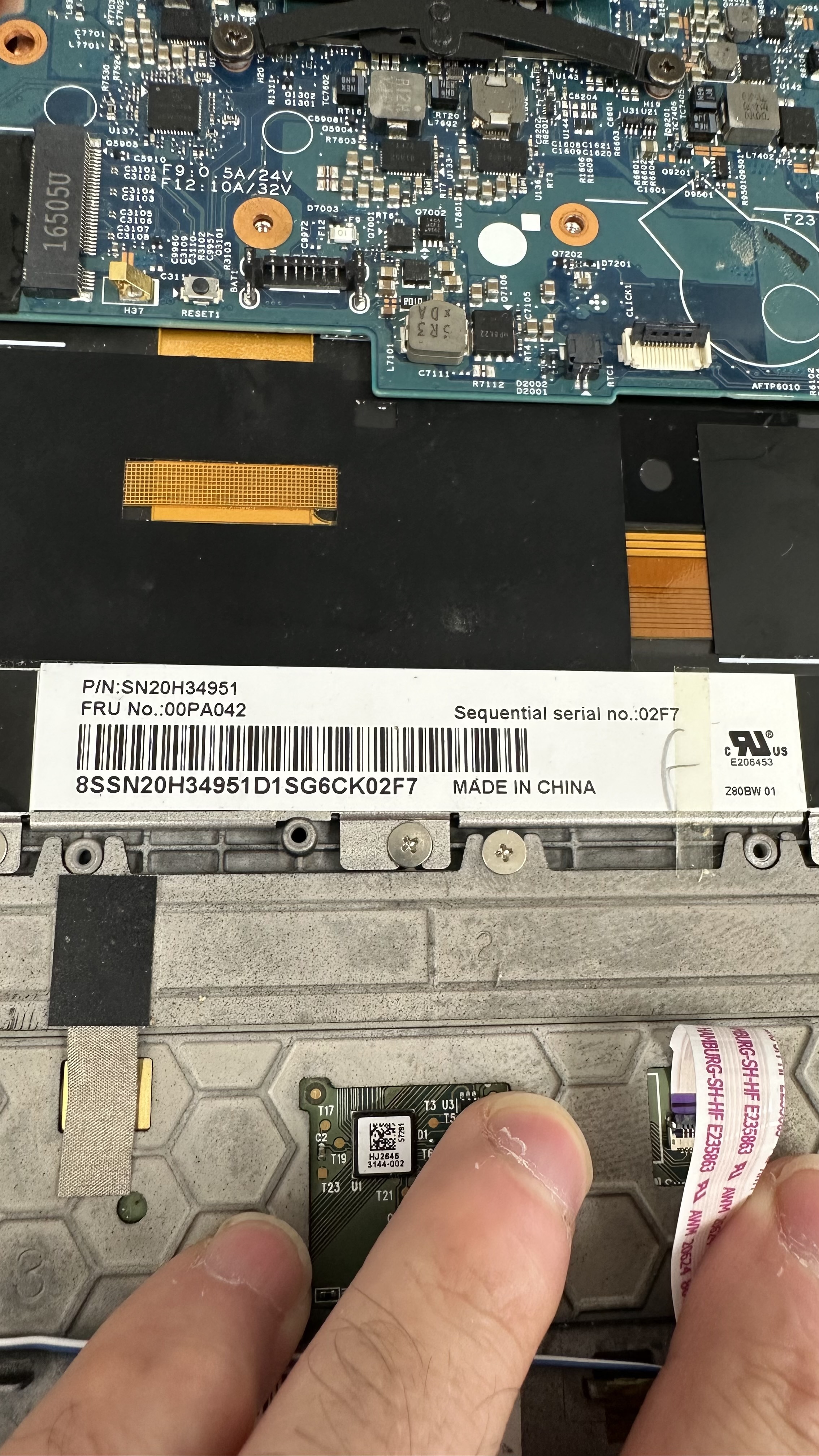

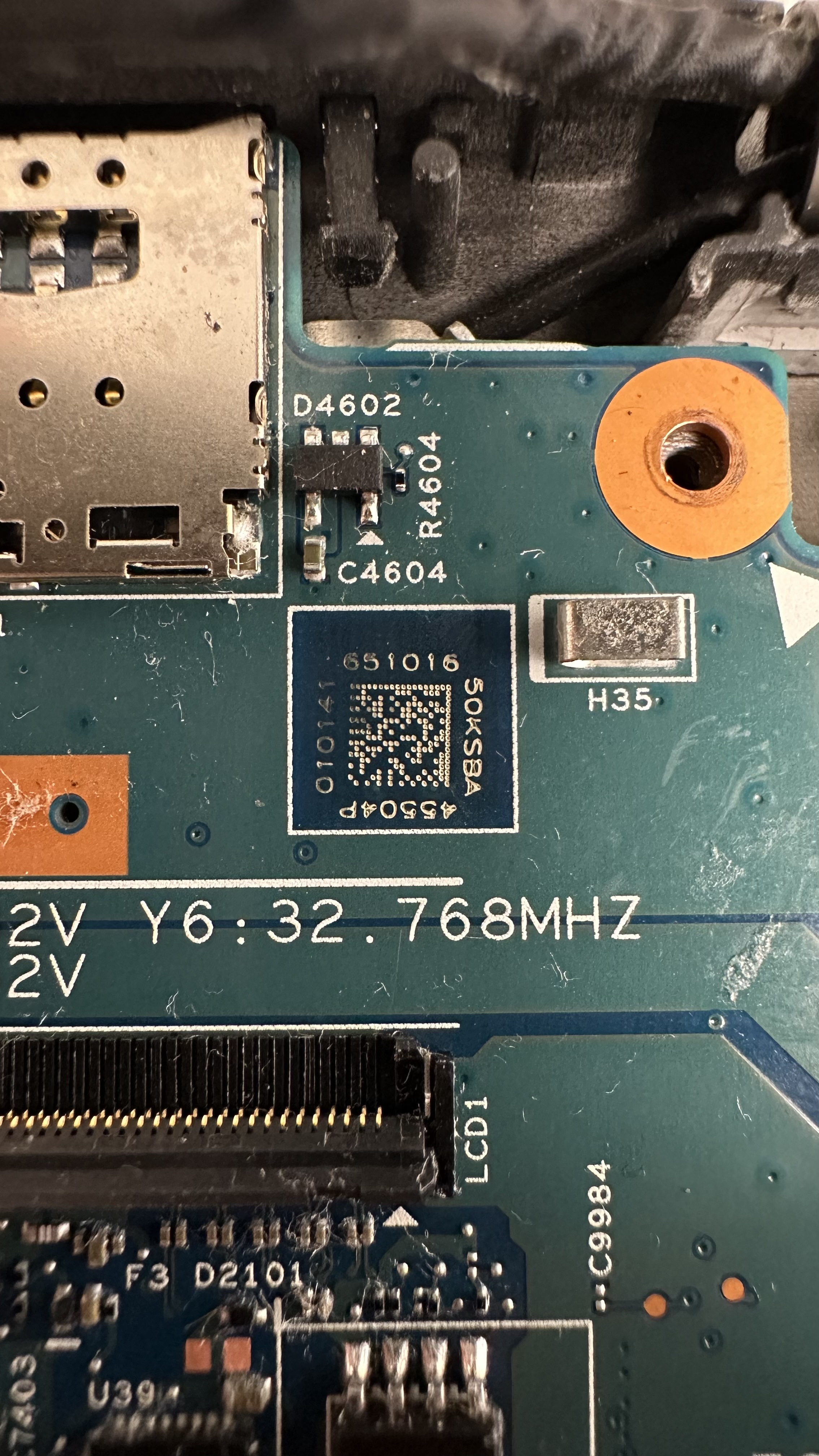

                          Hello to all the geniuses out there
                          I need some help with a Lenovo Thinkpad Yoga X1 Gen 1.
                          I can't find the serial number on it.
                          The bios is corrupted i think, when i start it's just a black screen and not caps lock light or anything.
                          Can anyone fix the bios dump for me so i can reprogram it?
                          Thanks!

                            Hello
                            Have you tried cmos reset?
                            Remove power adapter, disconnect main battery, disconnect cmos battery and hold power button for 30 seconds, then connect power adapter and wait 3 minutes.

                              #3474
                              Originally posted by Andreasbest
                              Hello
                              Yes. I have tried that. Didn’t work.
                              I found someone’s dump on here and tried that and that finally came up with Lenovo logo and tells me to press F1 but when I do nothing happens. Says press enter and I press that and nothing happens. I need my bios dump fixed because from what I read I have to have the original dump back on in order for it to work? But my dump is messed up. Must have done a bios update and crashed mid update. Bricked bios maybe? Any solution?

                                #3475
                                need snid

                                  #3476
                                  Originally posted by shiyab
                                  need snid
                                  Where would it be located? There’s no sticker with serial number on it. Can’t figure out where it is on the board either.
                                  I uploaded photos in post 3474. That’s all I got.

                                    #3477
                                    Try other dumps...
                                    The DMI data is stored in EC chip so a clean ME and new BIOS will do the job.
                                    BTW your posted dump serial and type (Serial R90ML8P7 and model 20FRS2KG00) does not match the picture...

                                      #3478
                                      laptop back cover

                                        #3479
                                        Originally posted by Stefan Steff
                                        Try other dumps...
                                        How can I get another dump for this model?
                                        and where are you getting those serials from?
                                        sirry I’m still new to all this. I’d like to learn. 😁

                                          #3480
                                          laptop back cover
                                          No sticker with serial. It was removed. 🥲
