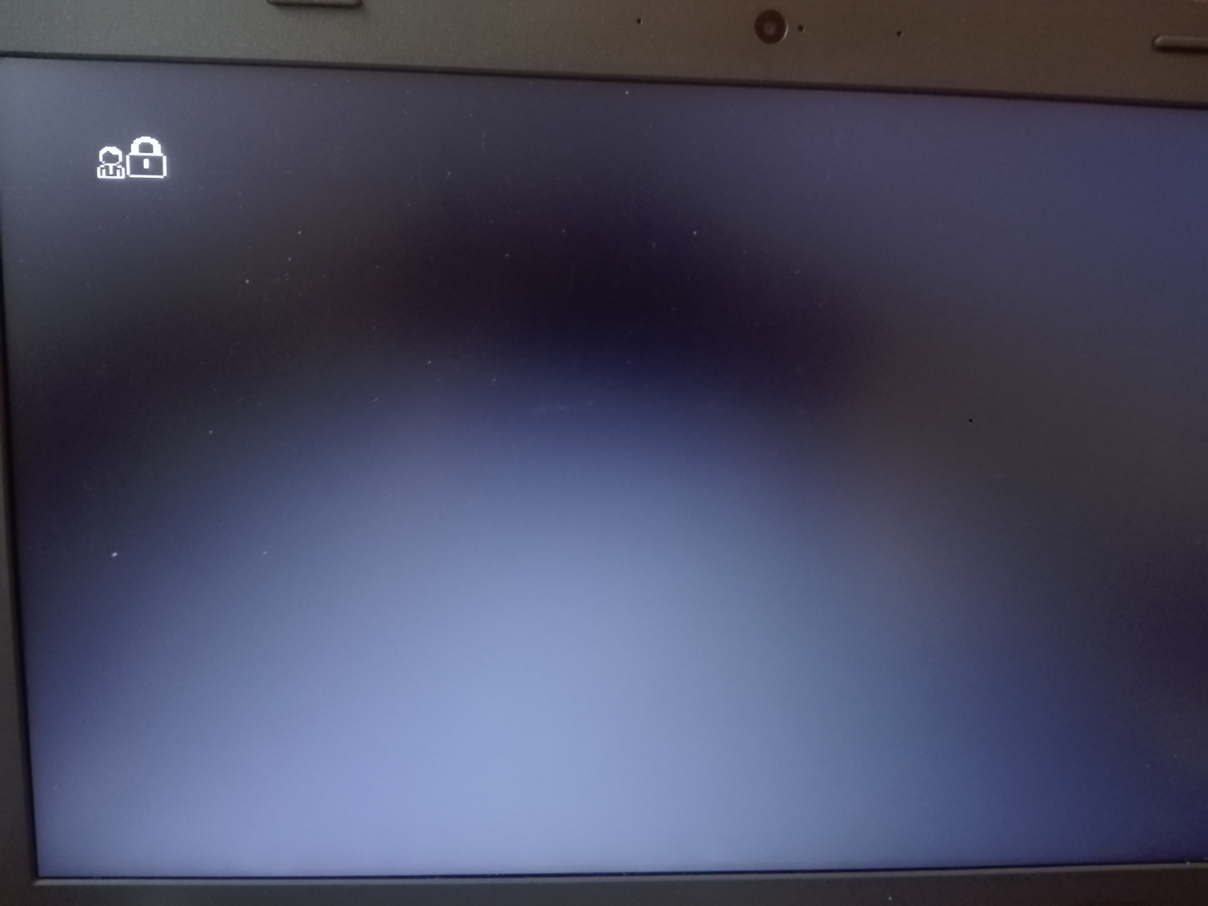

          Hi! I'm not very tech savvy but I have a few questions, so I apologize and would greatly appreciate it if anyone would help me/give me pointers.
          I recently obtained a 20Y0S26L00 (ThinkPad X1 Yoga Gen 6) and can no longer contact the original owner.
          It has an 11th Gen Intel so I am kind of worried this method will not work.
          When I boot, it complains about the date and time in the BIOS and I replaced the CMOS battery.
          However, it still complains and I tried to set the date and time in the BIOS and it seems there is some supervisor password. I can still access the BIOS without a password when prompted (enter with a blank password) but all of the options are greyed out.
          The machine can still boot to disk but is there any way for me to recover/reset/disable the supervisor password so I can set the date and time?
          Any and all help is appreciated!

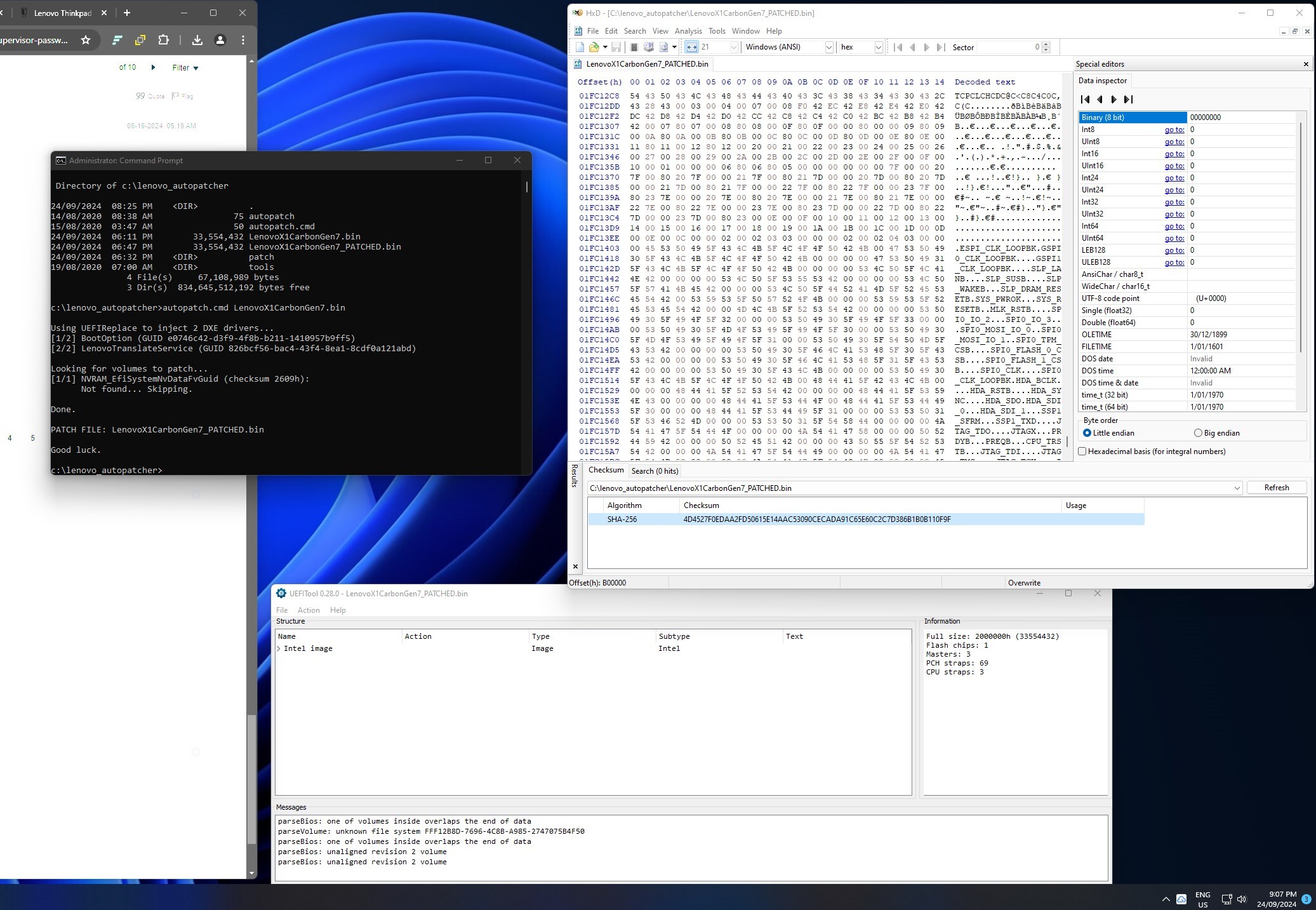

            LENOVO X1 CARBON 7th generation
            serial number : pf1cew2x
            TYPE :20QE-S2W303
            1. TRIED AUTOPATCHER. CHECK OUTPUT SCREENSHOT.
            2. flashed with new file LenovoX1CarbonGen7_Patched.
            3. Keep beeping and repeating
            4. Replaced Original bin .
            How can be fixed? is it SHA mismatch? i don't know how to check. have a look at screenshots. Attached. both files.
            Thx for any help.

              Originally posted by alpitvraj
              Cliquez sur l'image pour la voir en taille r?elle   Nom : 		LenovoX1carbonGen7SVpassword.jpg  Affichages :	0  Taille :		527,5 Ko  ID : 			3467542
              TYPE :20QE-S2W303
              SHA mismatch?
              corrected but doesn't work on it 32Mo
              try maybe

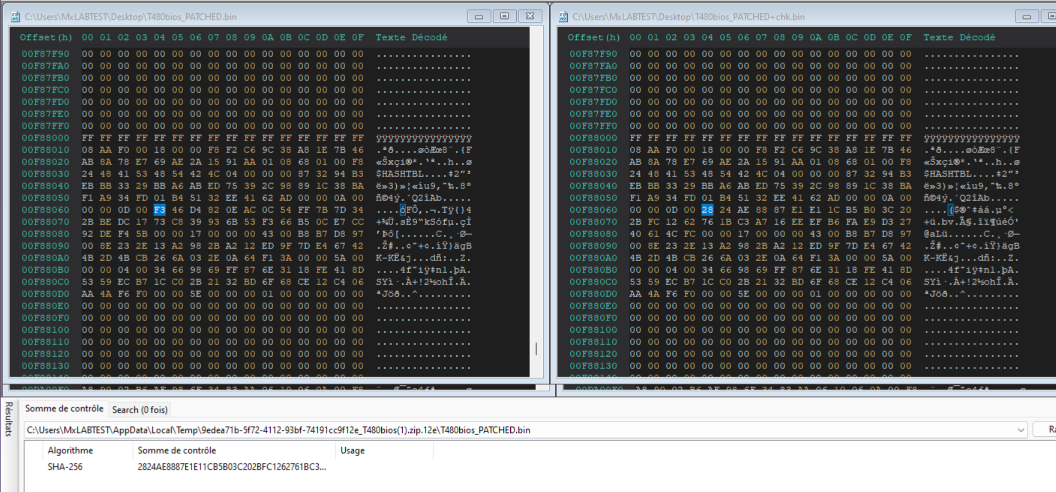

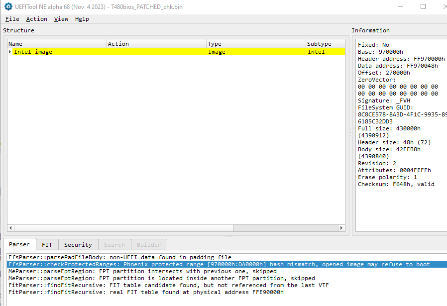

                          Hope someone can help - I followed your guide and created a patched Bios for my T480 20L5-CTO1WW S/N PF-1LT39A but when i tried to turn back on i got no LENOVO logo and only the beep code 01288 for a bad display so could not run the normal commands to complete the supervisor password deletion - checked the programming was done properly and verified also tried resoldering the chip but no change - i then returned progam on the bios to original .bin and it worked fine so i'm guessing the patch is not created correctly attached is my original and patched Bios .Bin file if someone can fix it please?
