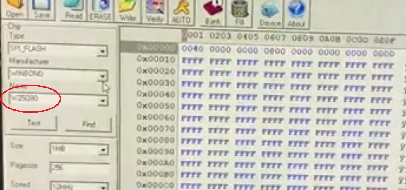

    Originally posted by freesofia
    Hello, I did a dump on this exact chip, on a Lenovo X1 Carbon gen 5!
    The Verify also passed without any errors and I think the dump is correct!​
    that's not bios chipset, see pic

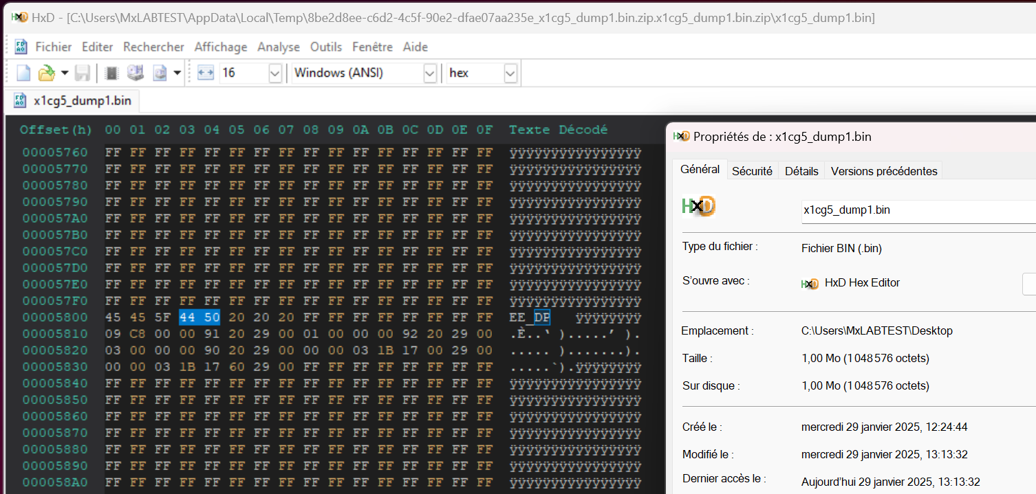

      Originally posted by strasharo
      Did a few dumps, all of them are the same, but fail on autopatching with:
      Am I doing something wrong there?
      please remove thunderbolt password
      Click image for larger version  Name:	image.png Views:	0 Size:	368.9 KB ID:	3559482
      W25Q80
      Click image for larger version  Name:	406939719_907500864311308_3119104718927673419_n.jpg Views:	0 Size:	169.6 KB ID:	3559485

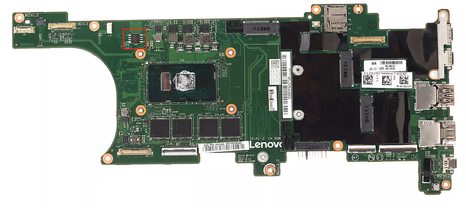

        Click image for larger version  Name:	x1_5.png Views:	0 Size:	1.15 MB ID:	3559465
        Wow, I dumped the wrong chip! Could you give me a joker, what is the model of the correct one, because it is erased and I can't see what it says! And EZP2019+ says this:
        Click image for larger version  Name:	image.png Views:	0 Size:	257.2 KB ID:	3559500
        Edit:
        Maybe this model!
          Yep, it worked with that one. Thanks a lot for the hint, really appreciated.
