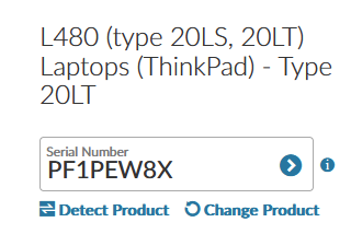

                      #3510
                      Originally posted by SMDFlea
                      The posted BIOS it's a ThinkPad L480 with Intel(R) Core(TM) i5-8350U CPU @ 1.70GHz so the autopatcher works OK but I don't think this BIOS will work on a T480...
                      Click image for larger version  Name:	image.png Views:	0 Size:	20.1 KB ID:	3507395

                        #3511
                        That's correct. My mistake, laptop is L480, I don't have SN as laptops came as job lot, and they have mixed bases is there any other way to find SN?

                                #3515
                                There is a sticker on motherboard OR enter bios read only mode by simply pressing enter key when ask for password

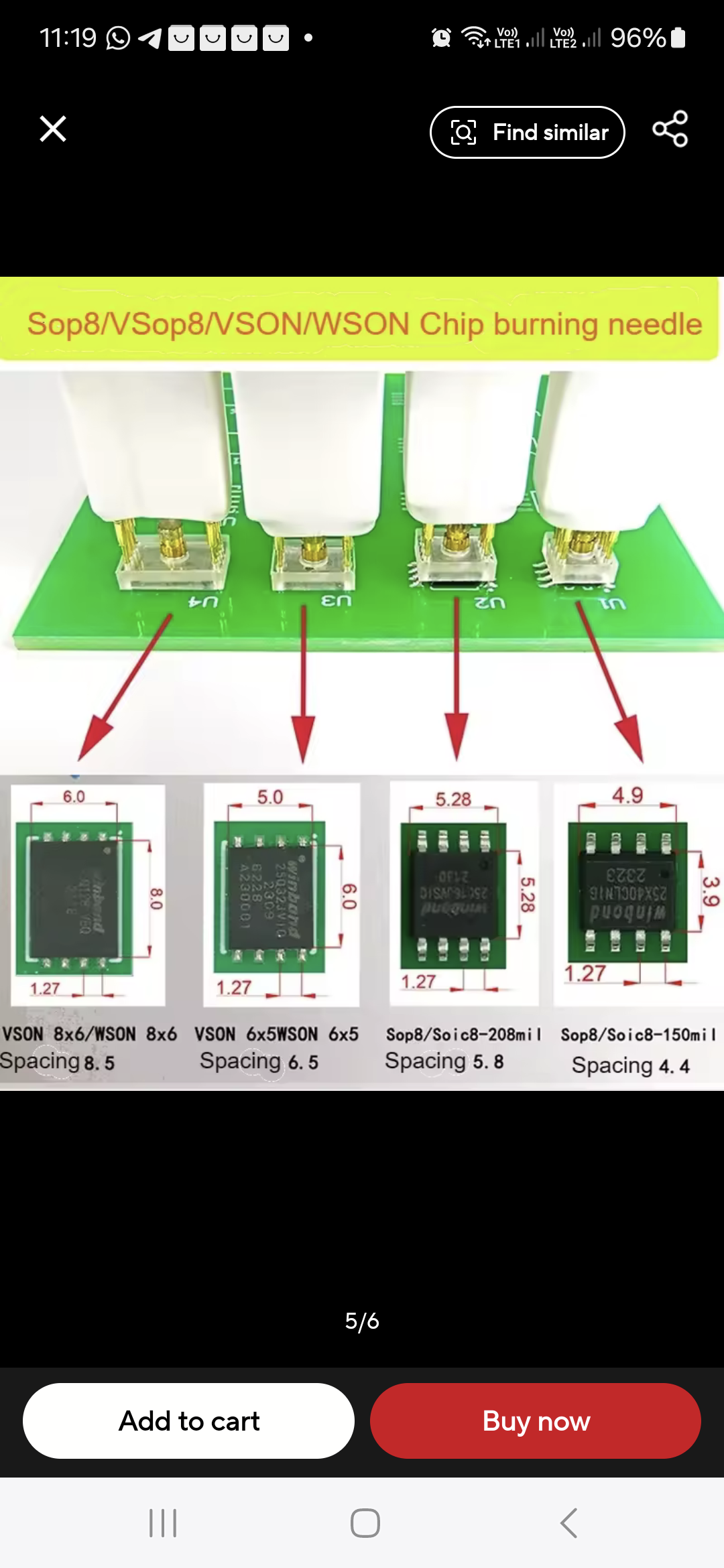

                                  #3516
                                  Can it be done with a pendrive or you need a clip-on chip reader of some sort? if the reader is needed can you give me a recomendation? i will probably use it only once i have a p51 to patch

                                    #3517
                                    Hi, I have a Lenovo X390 Yoga, Type: 20NN-002AGE​ S/N: R90WZWSJ. I tried the auto patcher, but the laptop starts once, then reboots and beeps...doesn't post, if I put back the original BIOS it's all good again. What gives? I included the original and the patched BIOS.

                                    #3518
                                    Try to buy this clip
                                    https://a.aliexpress.com/_EvoJWbL

                                      #3519
                                      Originally posted by ezazuk
                                      I have all of those clips and a Xgecu T48....
                                      Hm, so only bypass will work, I will try that then.
