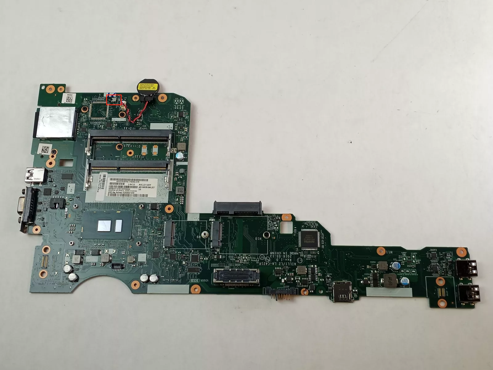

            Hello everyone. I will need your help please. I tried everything to unlock my L560 but the patched bios file will not work for me. The patching process was successfull but I only get a black screen and no fan noise after writing the patched file. After I write back the original bios file everything works fine - but with my bios password set.
            Can anyone try to patch my original bios file correctly that you can find attached?
            Thanks a lot for your help!

              serial number?

                #3307
                serial number?
                The number is: MP19V05G

                  #3308
                  write this file and follow steps described in autopatcher:
                  [ HOW TO USE THE PATCH ]
                  STEP 1: Flash and replace current BIOS with the generated patch file
                  STEP 2: Boot the machine
                  STEP 3: Press ENTER/F1/etc. to enter BIOS settings
                  STEP 4: Enter any character when asked for Supervisor Password
                  STEP 5: Press enter when it shows Hardware ID
                  STEP 6: Press space bar 2x when asked
                  STEP 7: Turn off machine
                  STEP 8: Restore original BIOS
                  STEP 9: Reset BIOS settings to factory default
                  [ NOTES ]
                  When booting the patched BIOS you might have to:
                  - Hold the anti-tamper switch down the whole time (use tape)
                  - Remove the hard disk or replace it with a locked one​

                    #3309
                    [ NOTES ]
                    Thanks a lot - but what is the anti-tamper switch? Is it something I need to do if I am not want to put on the backcover?

                      #3310
                      yes

                        #3311
                        yes
                        Sadly it is like before. The screen is black and nothing happened. I dont know whats the problem
                        Did I have to write back the original bios and start the system before I write back a patched one?

                          #3312
                          let it run for 2 mins, it will restart few times with no image, just wait

                            #3313
                            Sorry for my late reply. I let it run for more than 10 minutes but the screen keeps black and no restart so far. I tried with power supply and also with battery.
                            It is so strange. It is not the first time that I managed to unlock a L560. Maybe my bios dump is corrupt? Or can it be something else?

                              #3314
                              you said that if you put back original backup it works. Only thing to do is to clean ME

                                #3315
                                Thats right. But after I write back the original dump, the bios password is still there.
                                i dont know how to clean ME. Do you have a tutorial?
                                i will give it another try tomorrow.
