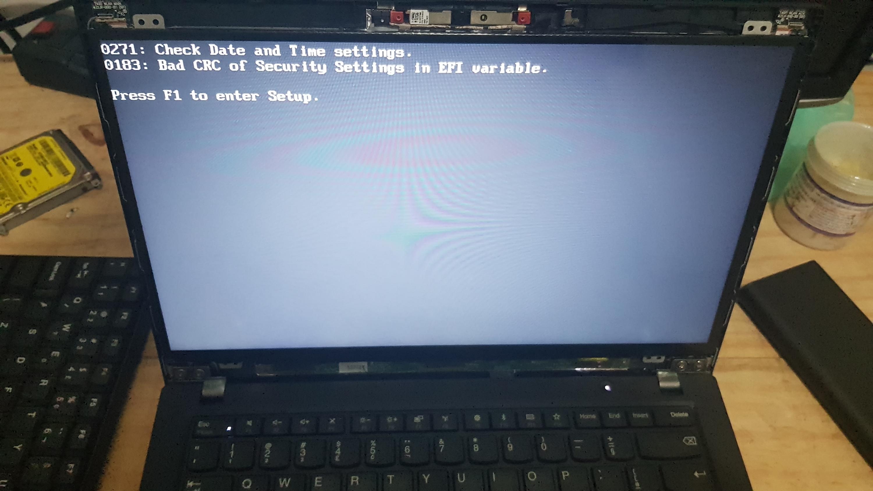

      what to do when you don't have the supervisor password, and you get error 0183? model T490..
      *** As I said, I don't have the supervisor password***
        How about Press F1, change some setting in BIOS and save/reset?
        also set the correct date and time.

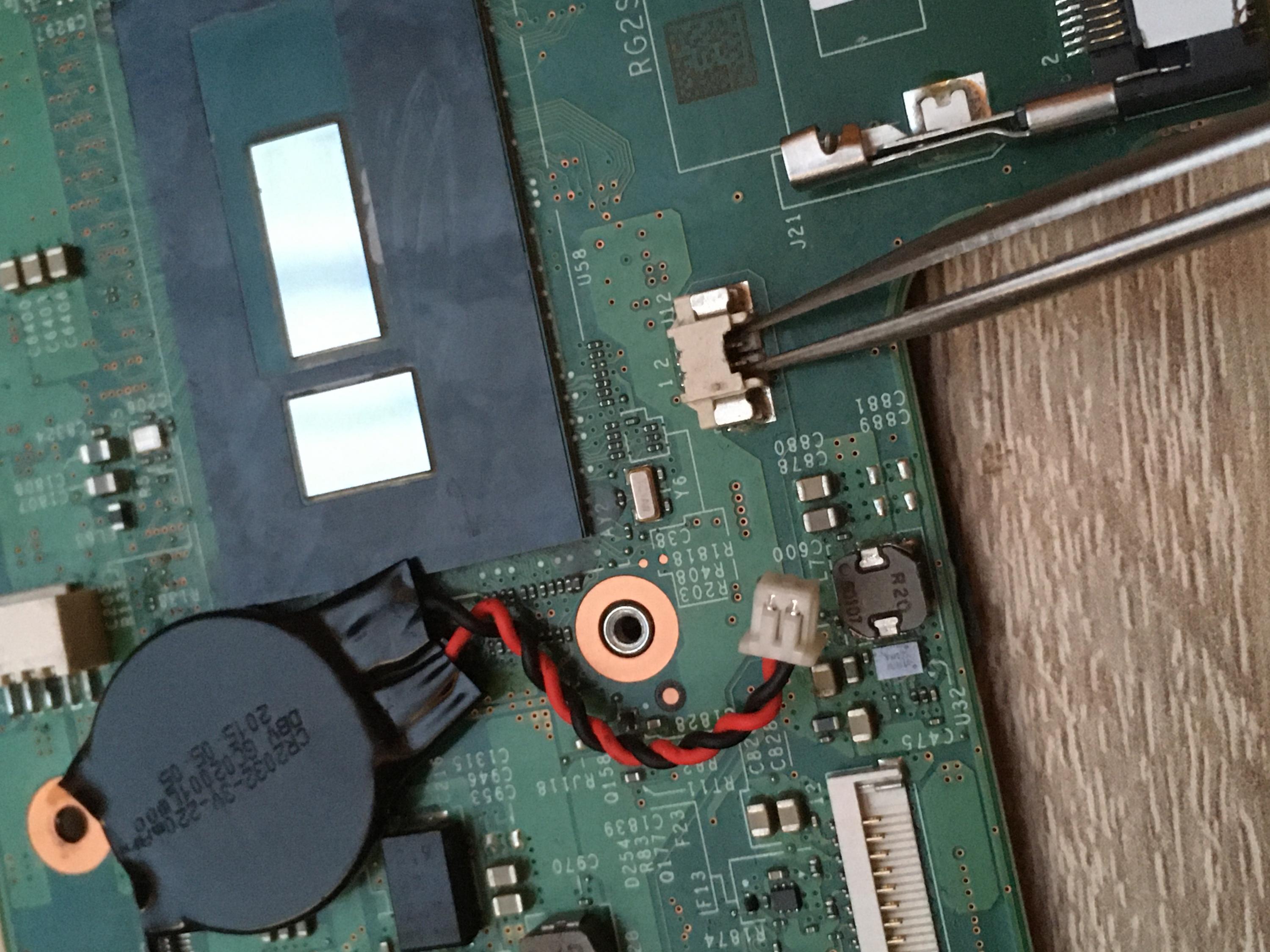

                      Hello, I generally do it by removing the CMOS battery and before I start a
                      newly installed patch, I delete the NVRAM by short-circuiting the two pins of the
                      CMOS battery for a few seconds, so all capacitors and controllers are
                      discharged.
                      Just so my opinion has been very much preserved.
