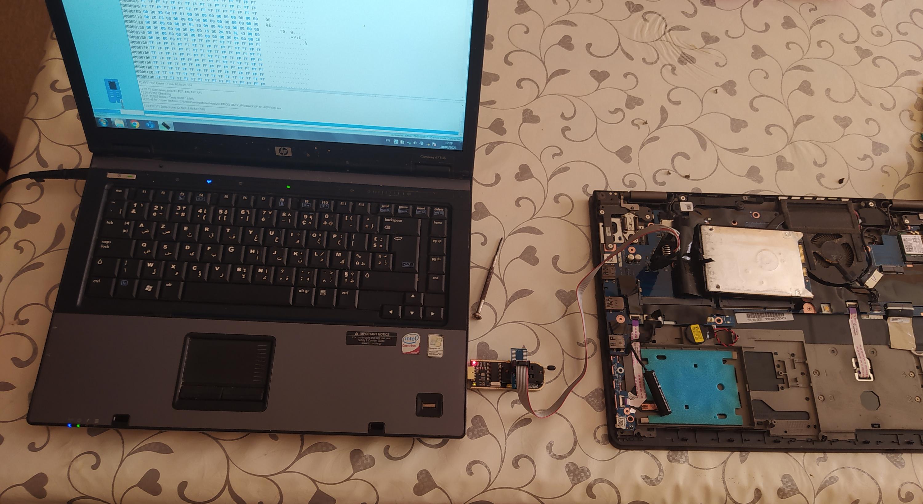

                      Thinkpad yoga 15 with Winbond 25Q64FVS
                      I used ch341a usb programmer 1.30 software
                      He says "Access violation at adress 0097EA42" when i click on detect i ignore this message.
                      software run without prb read erase blank write
                      Thank so much for the help

                          Thank you, I am very happy. The problem was that the chip was not soldered well: компиляция:
