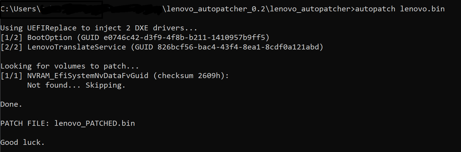

                  Re: LENOVO BIOS AUTO-PATCHER for Supervisor Password Removal
                  I have tried the autopatcher with my X270 Bios dump, but it did not work out.
                  I have the following Error:
                  Using UEFIReplace to inject 2 DXE drivers...
                  [1/2] BootOption (GUID e07...
                  original.bin is corrupted or does not contain a valid dump.
                  There was an error... Aborting.
                  While I was playing around to try different stuff, I corrupted the data on the chip (Winbond W25Q128JV).
                  I have only one original.bin, where the autopatcher does not work. When I dumped it with raspberry pi and flashrom, I verified it. Also I dumped it a second time and compared it. It was identical with the second dump.
                  Can somebody try my bin-file.
                  Also, is there another way, if my bin-file is lost?
                  Kind Regards

                    #2509
                    Nevermind. I soldererd back on the IC, and now the laptop now is completely bricked. No signs of life.

                      • LenovoIsSchrott
                        • Apr 2023
                        • 3
                        • Austria
                        #2511
                        Originally posted by Markus1741
                        Try this two files perhaps it helps.
                        Otherwise you have a bricked notebook.
                        Good luck ....
                        Thank you a lot. I desoldered the bios ic, to try your files, however the ic is completely dead.
                        Though I lost my laptop, I learned a lot.
