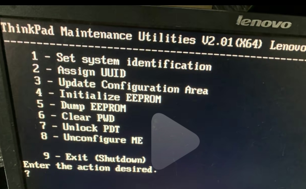

                  I need thinkpad maintenance utilities V2.01 and hope someone can help me. I learned that the tool also has a hidden function 5-clear PWD in our thinkpad maintenance utilities V1.11 old version of option 5 is directly blank, or someone can study to turn on this hidden advanced function, This will bring a breakthrough in unlocking the BIOS lock! Thanks in advance to the engineers who worked so hard!
                            Most likely it doesn't really matter if it's V2.01 or not. You wont see those options anyway. I guess you need to press a certain key combination to make them available.

                              #2694
                              Re: LENOVO BIOS AUTO-PATCHER for Supervisor Password Removal
                              Thank you for your reply. I have also had this speculation, but there has been no progress
                              As far as I know, their laptops will open the bottom cover when using this program
