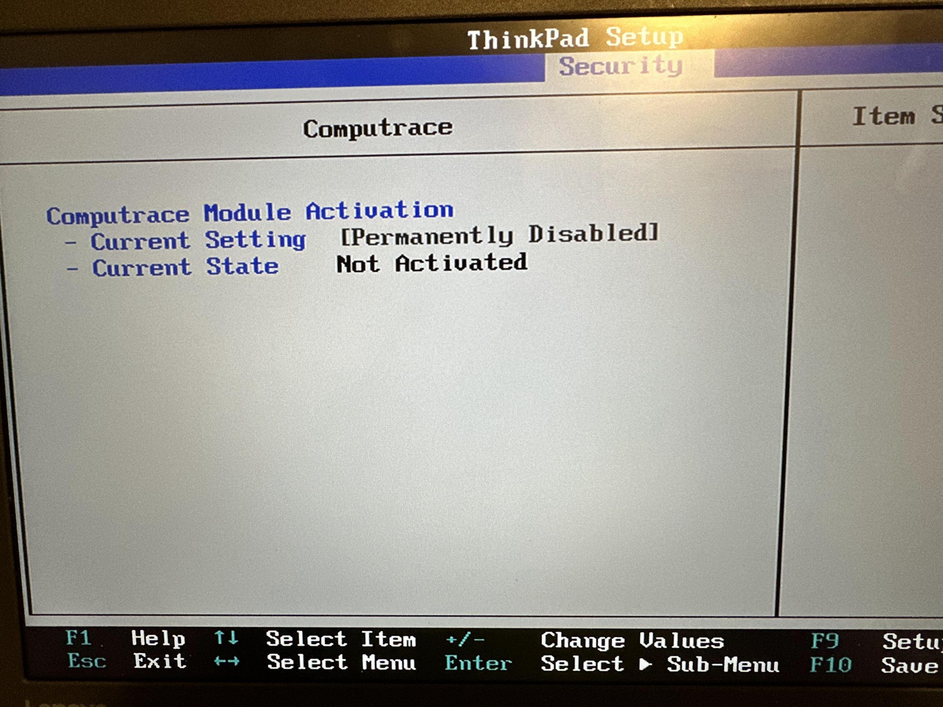

        #2583
        Re: LENOVO BIOS AUTO-PATCHER for Supervisor Password Removal
        Hi guys, registered here since I need some help with SVP unlocking for my friend Thinkpad P72 bought two years ago second hand and seller is vanished to ask him about the password.
        I am attaching info page from bios. I can solder with tipped iron and have a CH341a but I am far from a professional in this.
        Trying to go through all the post in the thread which is quite time consuming. If anyone can point me in right direction to save some time please do. Like as of now I do not even know where is efi chip is actually located on the motherboard))

          Hi everyone, i Have a Lenovo X270 with computrace, no passwords, I have read the bios, but im not sure how to proccede further. Any help would be appreciated. Thank you

            #2585
            https://www.badcaps.net/forum/showpo...postcount=1192

            • abi98
              • Nov 2019
              • 13
              • mass
              #2586
              Worked like a charm.
              Thank you
