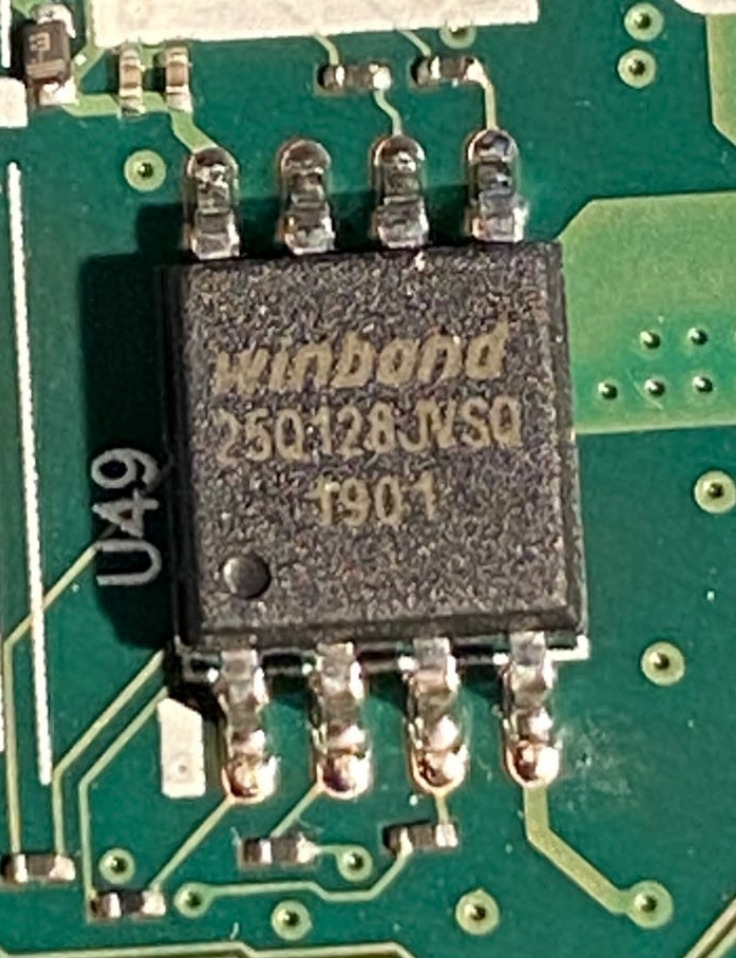

            • seso1983
              • Feb 2023
              • 10
              • poland
              #2606
              Re: LENOVO BIOS AUTO-PATCHER for Supervisor Password Removal
              Hi Markus as the file can be empty as it is 16MB I do not understand how it happens that it is like please help
                • 22155
                #2607
                Open the backup with a hex editor,it will be all FF`s . HxD hex editor -> https://mh-nexus.de/en/downloads.php?product=HxD20 .There is a polish version.
                What model is your programmer, i`ll guess its a CH341A or EZP20** .Have you desoldered the bios chip or are you using a clip. Post a picture if you can of the bios chip on the board.

                                    • seso1983
                                      • Feb 2023
                                      • 10
                                      • poland
                                      #2618
                                      Hi, it turns out that my programmer was damaged I bought a new one you can now look at this file
                                      I used the EZP 2023 programmer + now I bought CH341 on clips my bios winbond 250 128 vso 1703
                                      • Markus1741
                                        • Sep 2020
                                        • 967
                                        • N/A
                                        #2619
                                        Hello now everything fits, try the file, good luck ...
