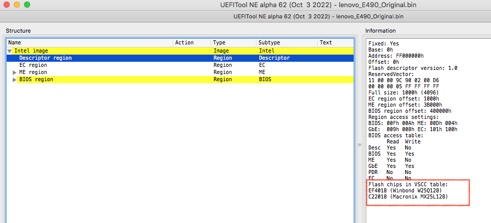

                • buokhalid
                  • Sep 2022
                  • 7
                  • Philippine
                  #2428
                  Re: LENOVO BIOS AUTO-PATCHER for Supervisor Password Removal
                  Check if you didn't remove any component around bios chip by mistake while soldering/desoldering bios chip. Leave laptop on for a long time, from my experience it take between 1 to 2 mins to apply new settings from bios, you'll see keyboard leds flashing few times. I removed SVP from E490 with same method I created your patched bios, it should work.
                  I didn't desolder the chip
                  I used the clip with ch341a programmer.
                  I believe if the chip burned it will not accept programming or even the programmer detect the chip.
                  It is accepting the flash and verify it successfully with no issue.
                  Anyway i will check the area around the chip as you said. And will update you back.
                  Thanks bro

                      I had some troubles with Macronix chipsets, even programmer detected it and wrote it with no errors laptop didn't start. I replaced with Winbond and laptop started.
                      I see that your laptop can use both chipsets, try change it with W25Q128 if you have MX25L128
                      Also I gave up using clips because it can damage components placed near bios chipset and always desolder bios chipsets, there are some "pogo pins" i saw some users here use it and it's better than clips.
