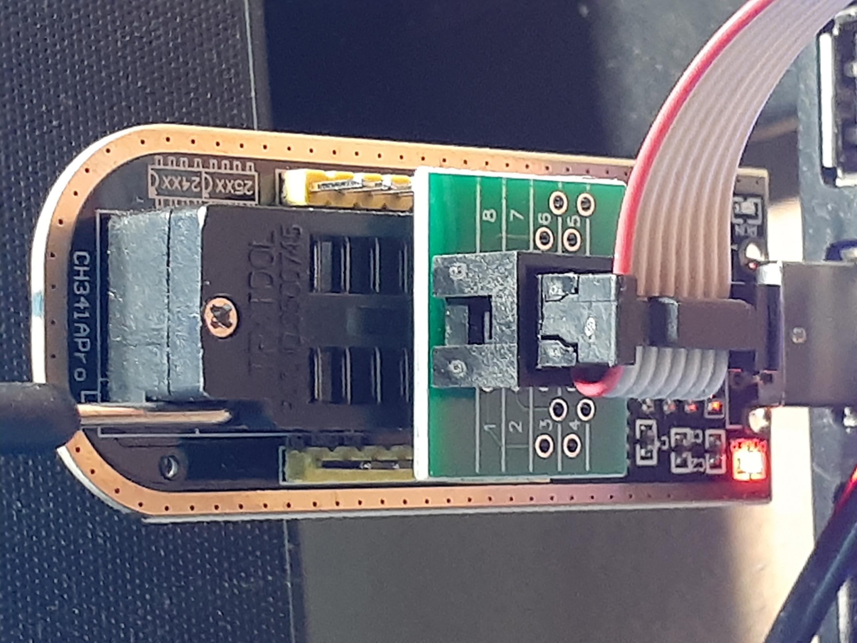

    • kudo623
      • Aug 2022
      • 56
      #782
      Re: bios dump elitebook 840 g3
      I am using a CH341 Programmer got on ebay for around $10 and you can place the cmos chip in the test clip they supply--its a little tricky but once you get the hang of it works fine.
      • Vesko356
        VIP Moderator
        • Aug 2018
        • 4386
        • Bulgaria 🇧🇬
        #783
        This clip is not intended for use with a WSON-8 chip, do yourself a favor and buy a proper one. I recommend this type - https://www.badcaps.net/forum/showpo...&postcount=228
        Become a Badcaps supporter
        Thanks to all supporters.

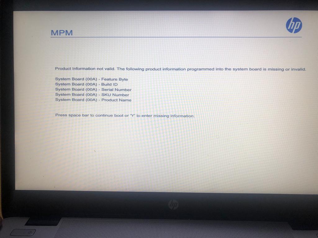

          #784
          HP EliteBook 840 G3 6050A2892401-MB-A01
          attached backup is getting this error
          looking for clean bios
          • peste
            • Dec 2016
            • 13865
            • ROMANIA
            #785
            missing DMI information try this...

              #786
              https://www.youtube.com/watch?v=9T57ktw8n3Y
              am getting challenge on "feature byte"

                #787
                In this backup FeatureByte is empty , where's the original dump

                  #788
                  got it from client with this backup
                  • lapfix
                    • Mar 2020
                    • 2765
                    • my workshop
                    #789
                    This client/technicien didn't copy the DMI that's why you face this issue .
                    Maybe someone gonnag help you here , so be patient
                    • Vesko356
                      VIP Moderator
                      • Aug 2018
                      • 4386
                      • Bulgaria 🇧🇬
                      #790
                      Device serial number is?

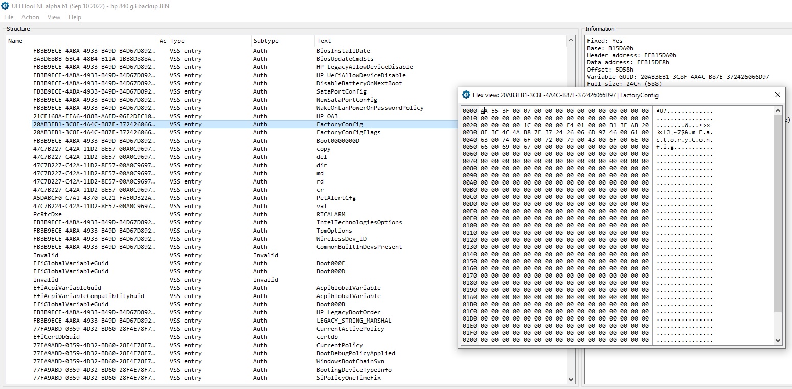

                        #791
                        Dmi stored in me region
                        when you will clean me section than dmi will be blank

                          #792
                          Hello my friend
                          So in this typical case this is how to proceed especially many HP have the DMI in me region .
                          MUST have the original dump and copy the informations from me region section

                            • qayyum786
                              • Aug 2018
                              • 1959
                              • INDIA
                              #794
                              Hello my friend
                              yes you must have a originole backup
                              if not than you have to try many Initialized bios till it get work
                              otherwise you will suffer from no or late display

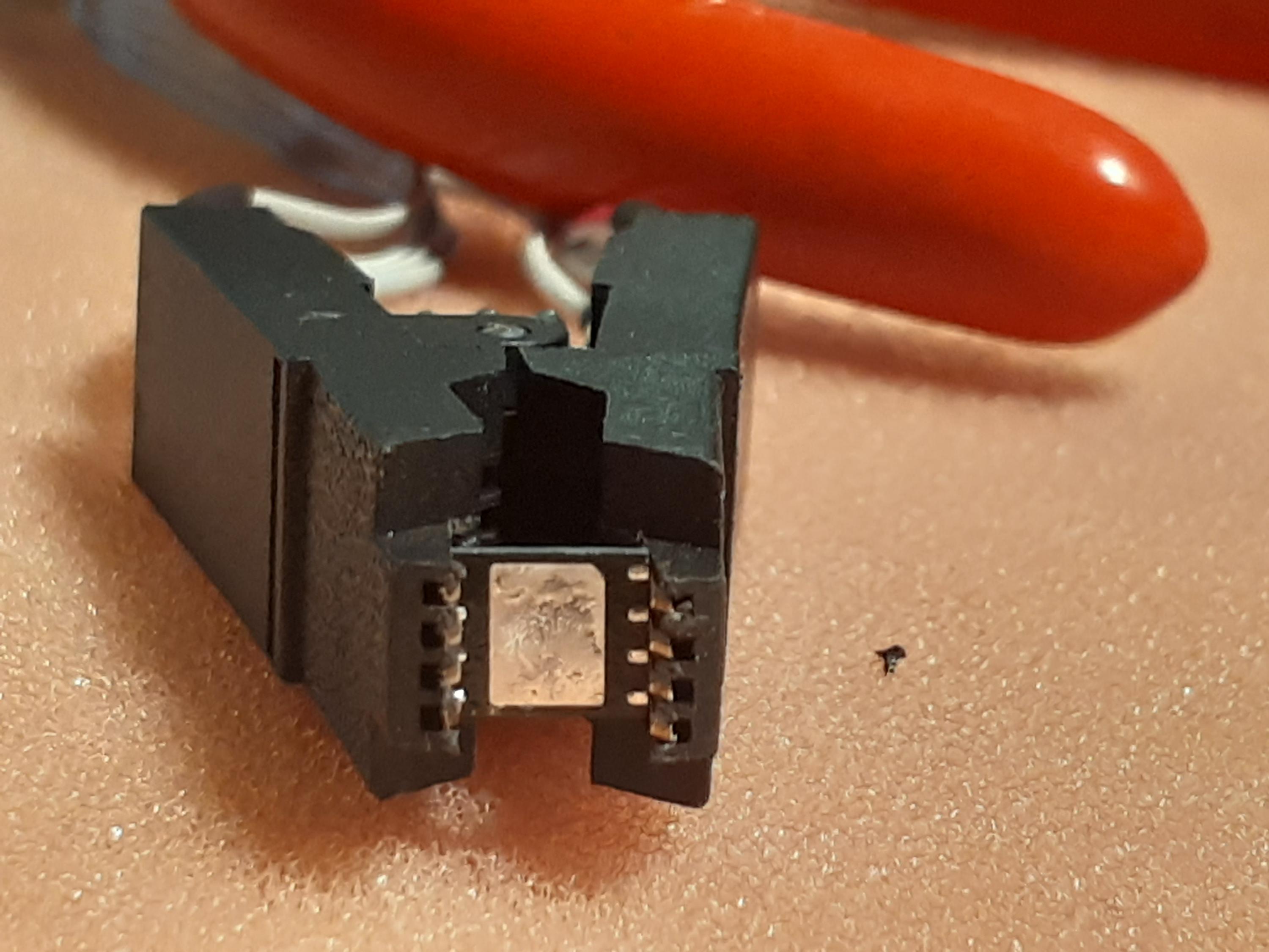

                                      #798
                                      Thanks Vesko! I might get that
                                      I mistakenly removed the cmos chip before removing the main battery and got an error "unlockable content not available"
                                      Here is the file not sure is it corrupted?
                                      • Vesko356
                                        VIP Moderator
                                        • Aug 2018
                                        • 4386
                                        • Bulgaria 🇧🇬
                                        #799
                                        Yes it is.
                                        As I said do yourself a favor and buy a proper tool for the job, continuing to use the clip you showed is just ridiculous, and it won't lead to a successful outcome. That's for sure.
