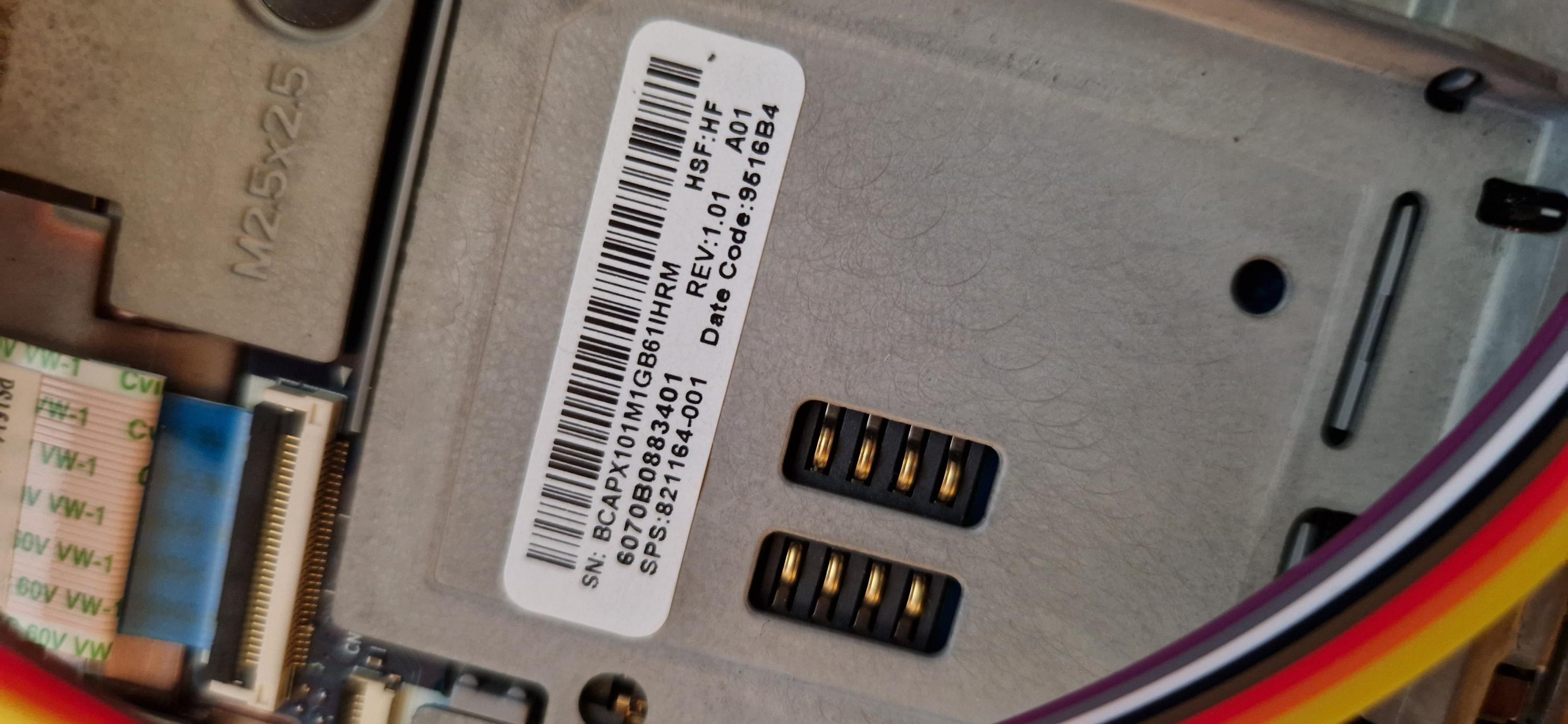

                                      Re: bios dump elitebook 840 g3
                                      Hi guys, please help, did a backup and used rcunlocker but when I try to flash it I get verification error, I use neoprogramer with ch341a
                                      I think I might have a corrupted dump and I cant flash it back, please help!
                                      Many thanks in advance.
                                      My motherboard model: 6070B0883301 rev.1.02 elitebook 840 g3
                                      my dump>

                                        #759
                                        Sorry guys I messesd up with the motherboard number, this is the one:
                                        6070B0883401 rev. 1.01
