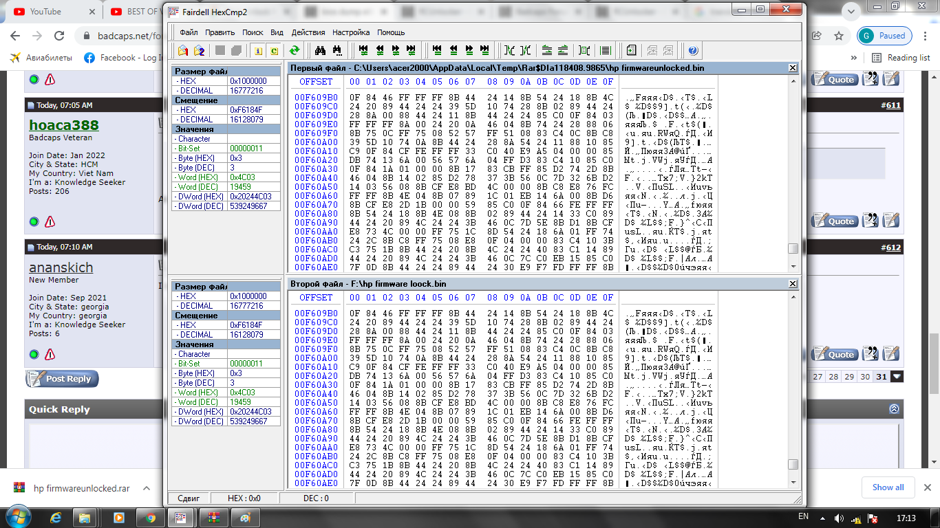

    Originally posted by ananskich
    I compared them with the program hexcmp

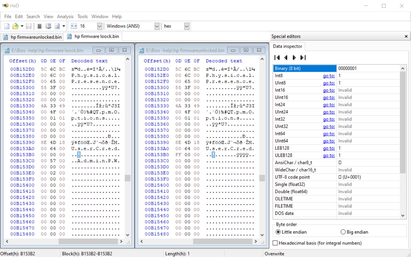

        I am using HxD.

          Re: bios dump elitebook 840 g3
          please help
          Help is on the way
          @hoaca388 data inspector section takes up a lot of the screen, if you don't use it (I think so) you better close it.
          I compare both files and there is no change dumps are the same
          They are not the same, but the right (unlocked) bin should be a little different:

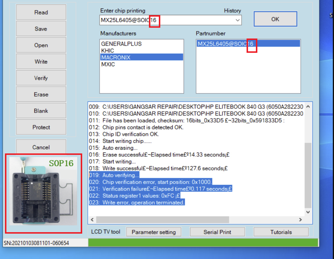

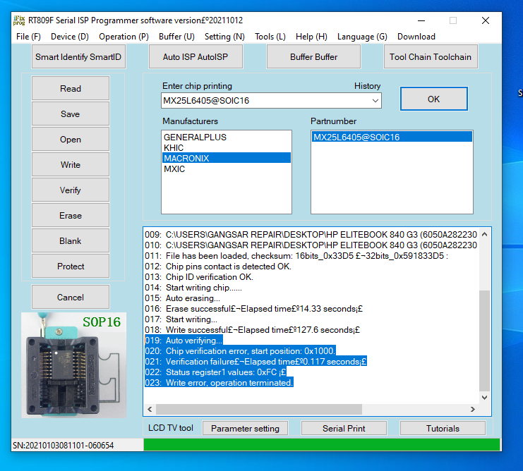

                    Hello, Anyone willing to share the bios file for the ellitebook 840 G3 which is 8MB? I have an empty read in my rt809f. and obviously I don't have any backup.
                    I have tried from several files that I can find in this post, But nothing works.
                    Notes.
                    - Bios still reads fine as
                    - General Plus - MX25L6405@SOIC16, capacity: 64Mbits, 8Mbytes.
                    - blank chip reading
                    Some of the writing experiments conveyed the message:
                    059: Chip ID verification OK.
                    060: Start writing chip......
                    061: Auto erasing...
                    062: Erase successful£¬Elapsed time£º19.53 seconds¡£
                    063: Start writing...
                    064: Write successful£¬Elapsed time£º106.7 seconds¡£
                    065: Auto verifying...
                    066: Chip verification error, start position: 0x1000.
                    067: Verification failure£¬Elapsed time£º0.162 seconds¡£
                    068: Status register1 values: 0x40 ¡£
                    069: Write error, operation terminated.
                    Best Regard
                      Looks like you chose the wrong bios chip.
                      • ozenk
                        • Aug 2021
                        • 7
                        • Indonesia
                        #611
                        Yes I think it's also wrong on chip selection. And I have tried with the options that I think are correct as in the picture.
                        I've tried several times with dozens of 8mb bios files I got on this forum. But all display the same error message.
                        So can someone tell me what's wrong here?
                          How many pins does your chip have? I see you are choosing the chip with up to 16 pins.

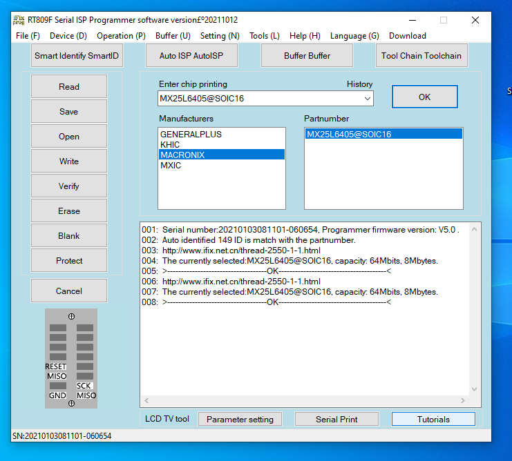

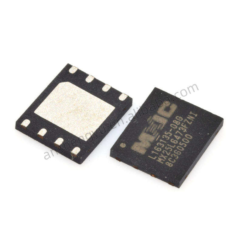

                            Of course there are 8 pins for the bios component. Exactly as in the picture below is the type of bios used on the 840 g3 laptop that I am working on.
                            Bios code - MX25L6473fzni
                            Does it affect my ISP method? I mean, does it have to be completely removed from the board to flash? While this can detect the chip well on the ISP method.
                              On rt809f , you choose MX25L.........@SOIC8.
                              Not @SOIC16.
                                Not @SOIC16.
                                What if there is no option for @SOIC8?
                                in the rtf list many choices only mention @SOP8 / @WSON8 / @VSOP8 and there are also some lists without mentioning them all, only sincere MX25L6405
                                which one should I choose for some of these lists?
                                I've tried to select @SOP8 on flashing it worked, but laptop still not working!
                                In advance, thank you very much to all who have provided feedback here. Very much appreciated.

                                  Choose sop8, your laptop has a 16MB chip and an 8MB chip, you have to flash both these chips synchronously. Remember to back up your chip's original file before doing anything.
                                    Unfortunately I can't find an option for that now, However after I lifted both of them off the board. and tried flash together it worked despite using soic16 option.
                                    and I think it's a development because laptops give a sign of life. but unfortunately it's still no display and the fan is spinning fast.
                                    I think now the problem is in the bios firmware itself.
                                    so i now need bios files for 8mb and 16mb, if you will share for me, much appreciated. Because I have a lot of mixed files. And the original copy is missing.
