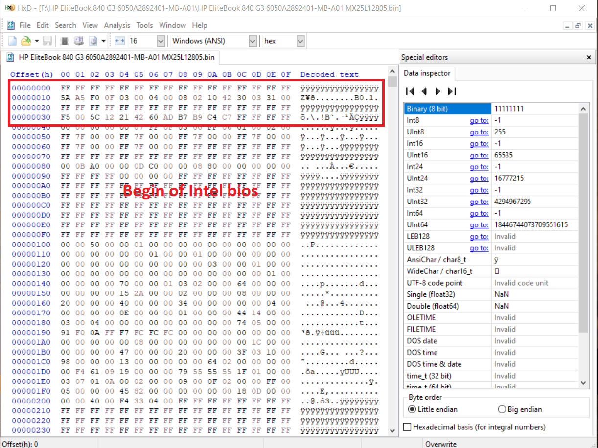

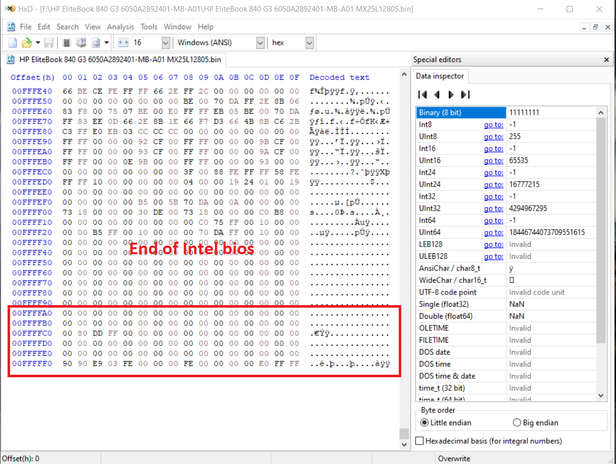

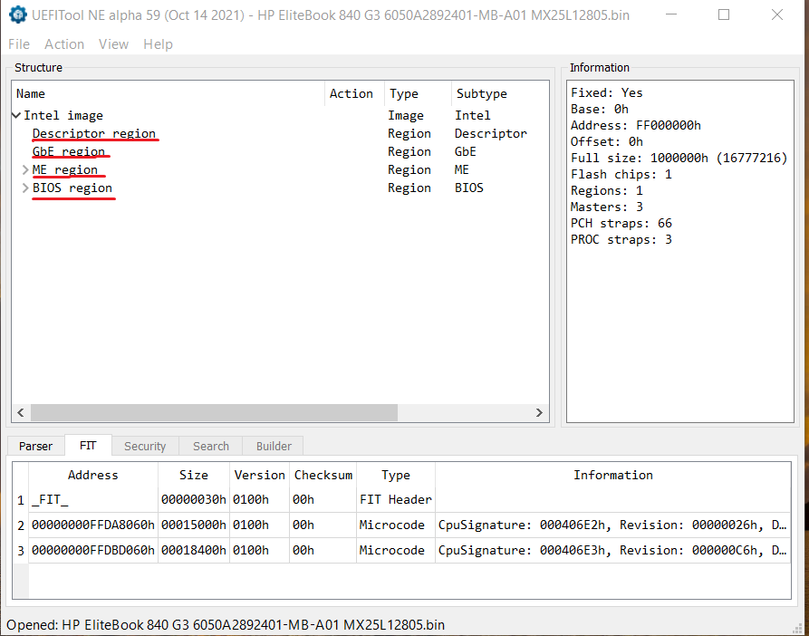

                    • hoaca388
                      Badcaps
                      • Jan 2022
                      • 12424
                      #630
                      Re: bios dump elitebook 840 g3
                      Originally posted by m2farid
                      Many thanks for your help, my bios chip wson8 chip, I tried to use a sop8 to dip8 adapter to read the bios but the chip is always not detected.
                      Could you please advise.
                      Many thanks
                      Maybe your programmer doesn't support this chip.
                      Normally the structure of an Intel bios file will look like this.
