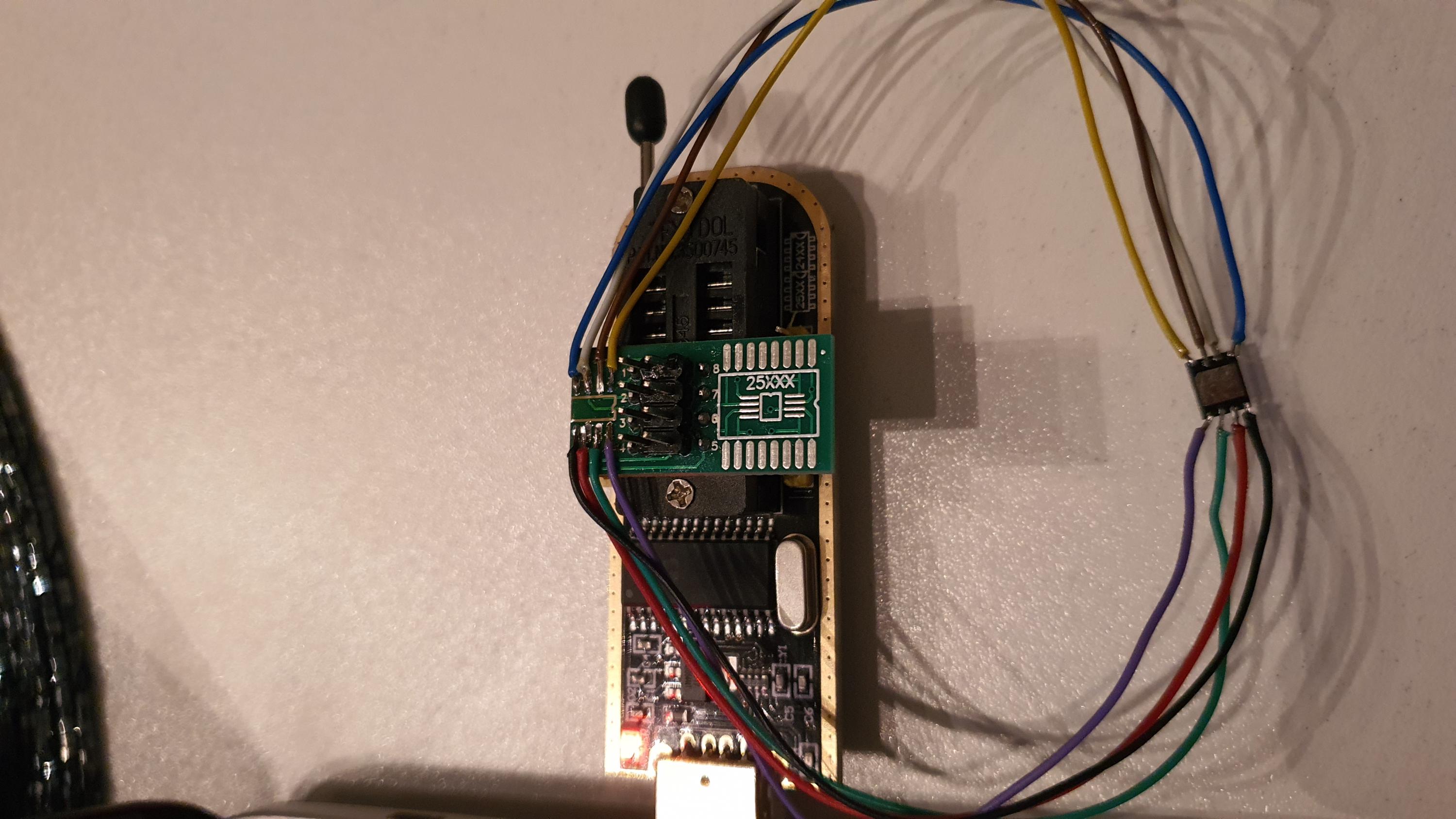

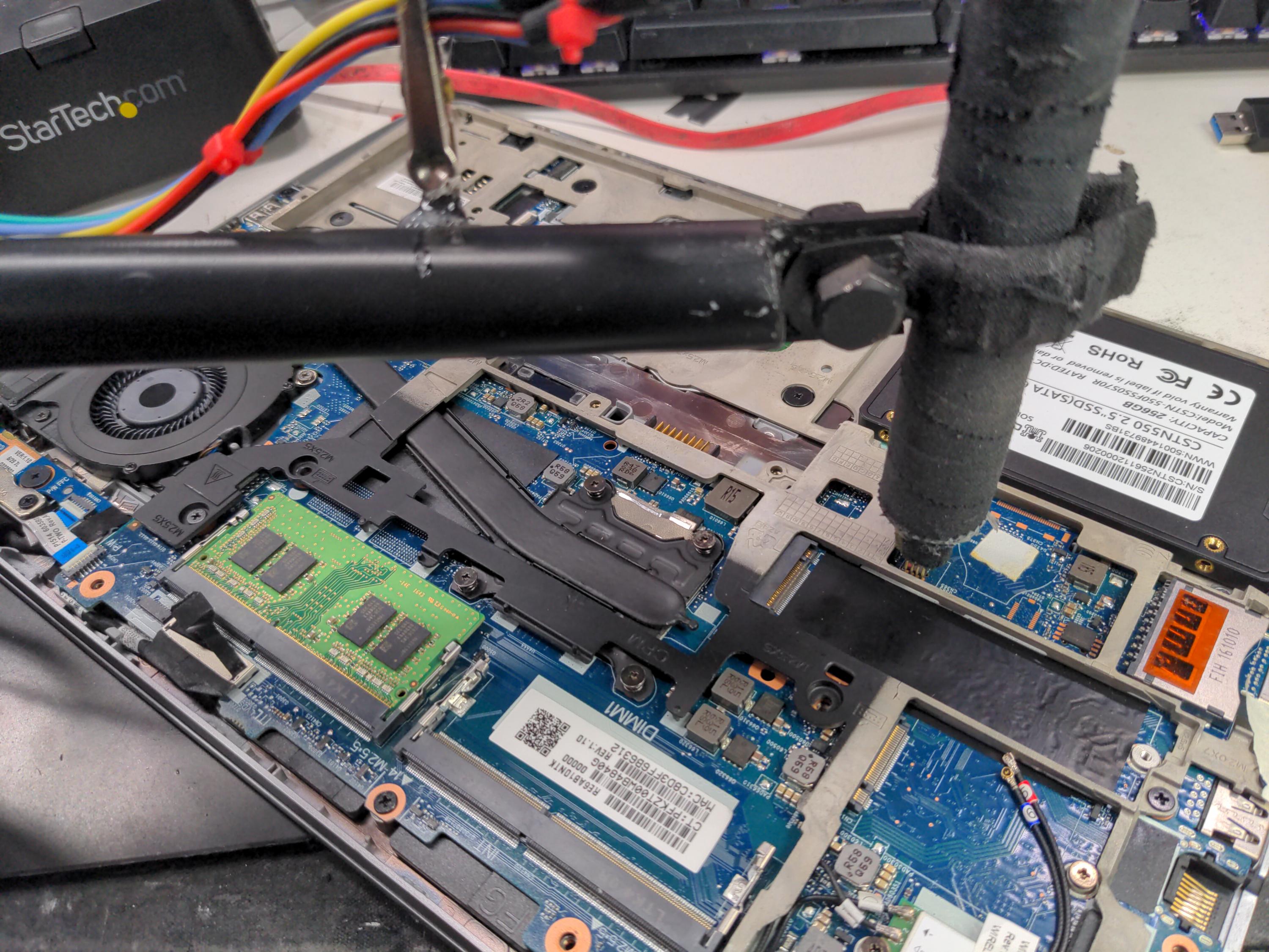

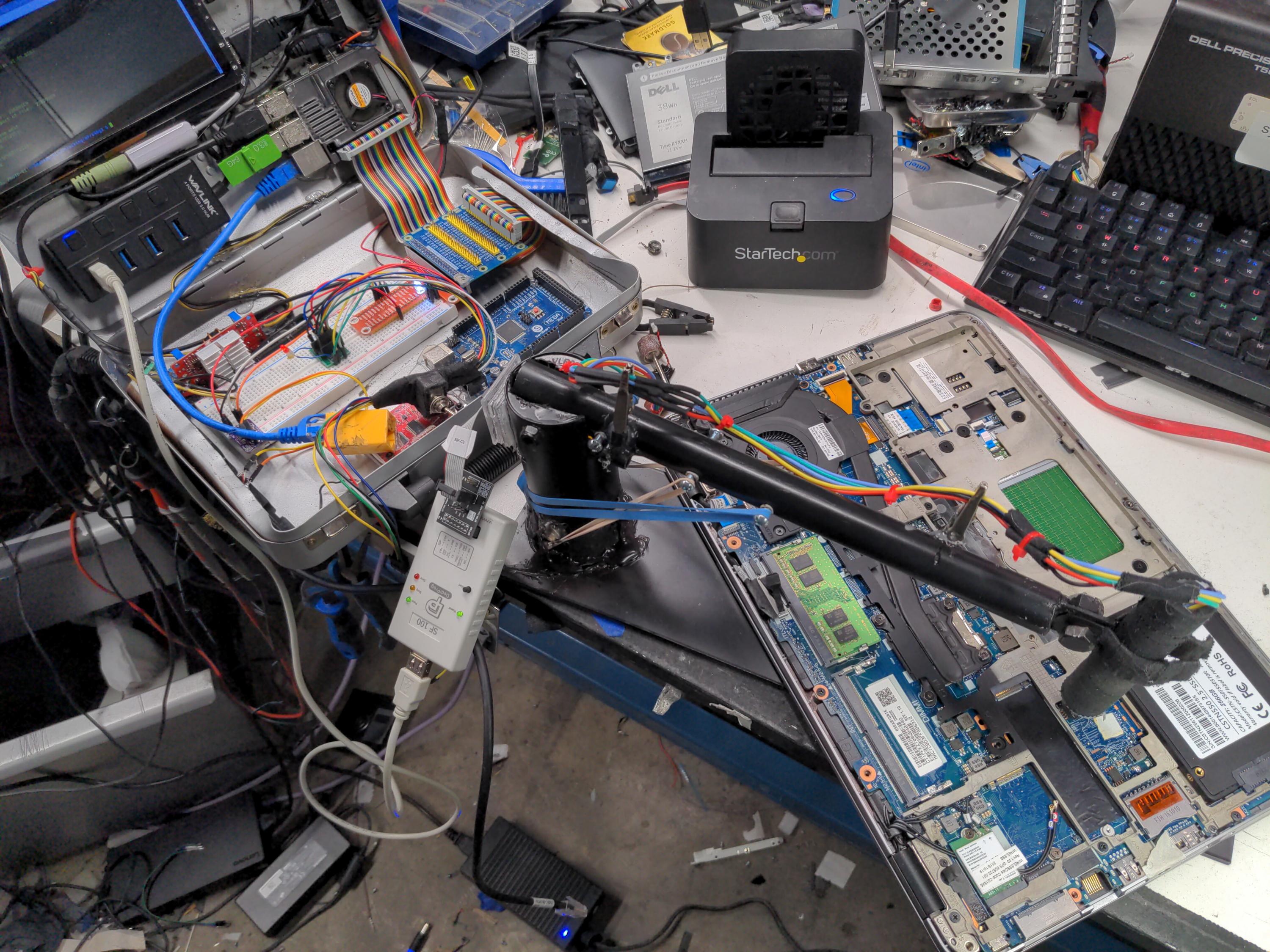

      this is a custom tool i made out of garbage and pogo pins for this type of non clippable chips

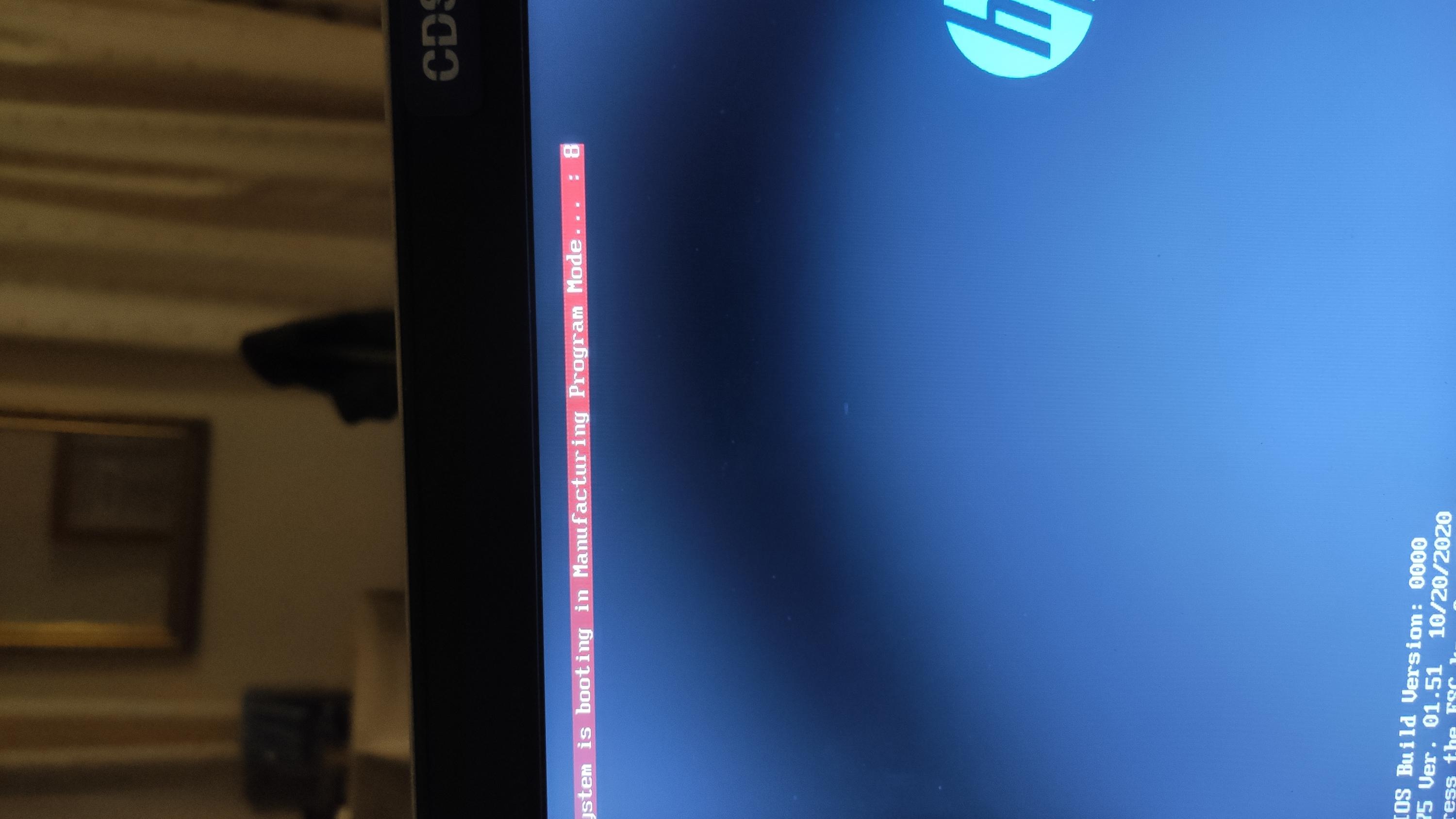

                                  • peste
                                    • Dec 2016
                                    • 13880
                                    • ROMANIA
                                    #477
                                    Re: bios dump elitebook 840 g3
                                    Originally posted by rubenfix
                                    what is that?
                                    enter the DMI information.
                                    https://www.youtube.com/watch?v=9T57ktw8n3Y
