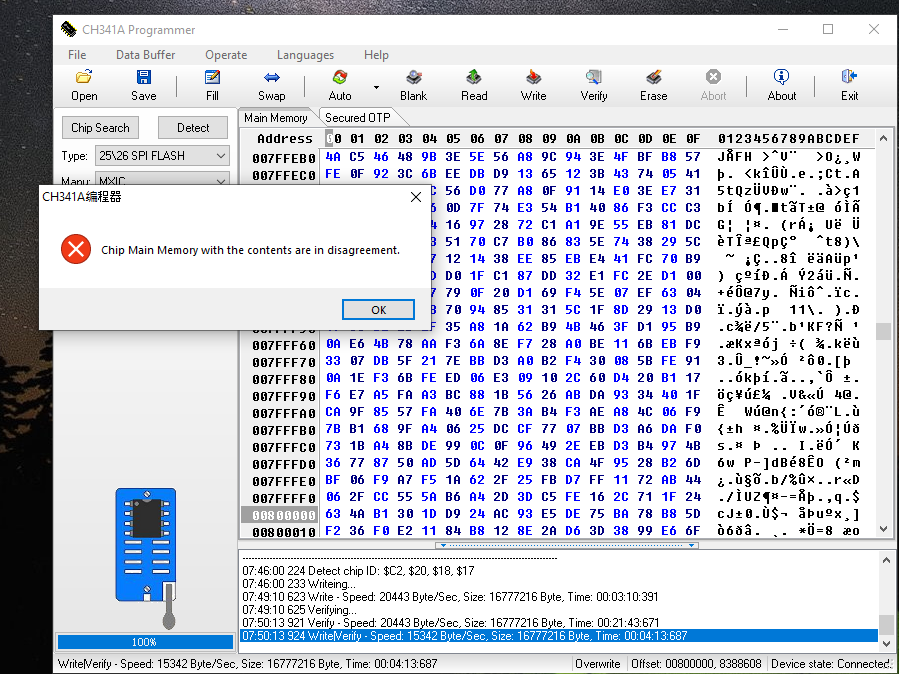

                                          Thanks for the help. When i tried to write this file i got the following error "chip main memory with the contents are in disagreement" Screenshot is attached. Is it the file or am i doing something wrong?
