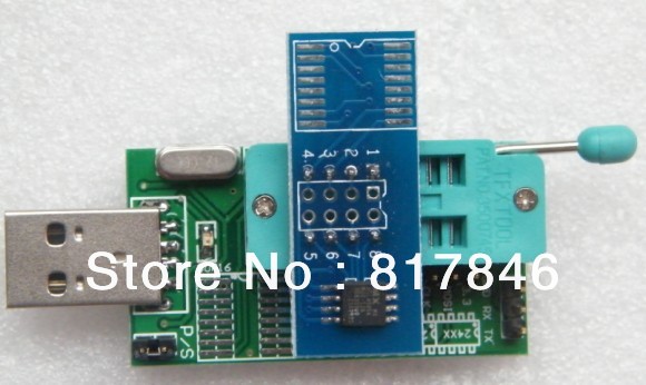

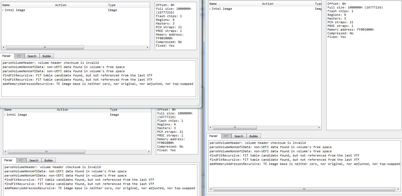

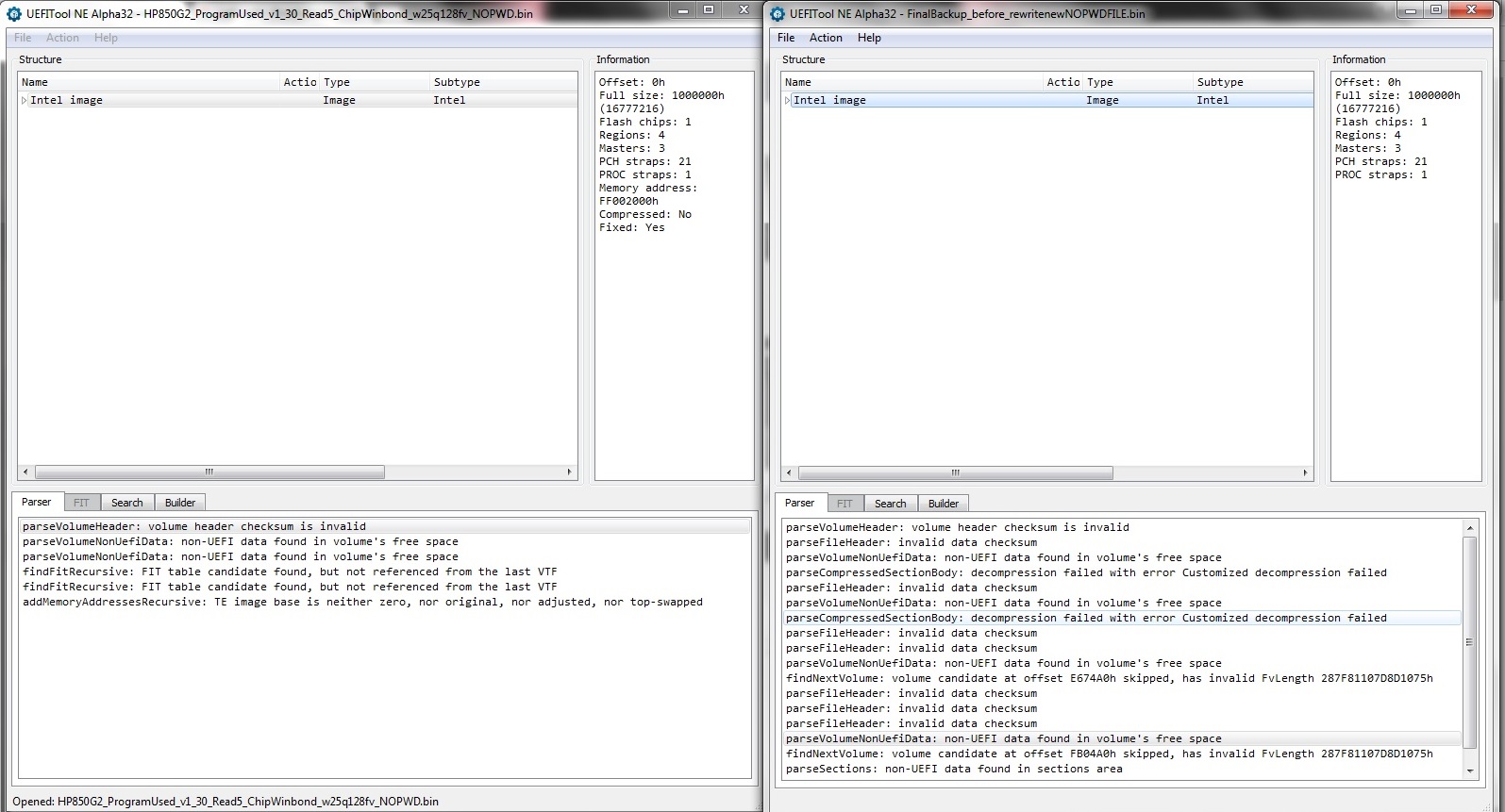

                  1.- I was able to dismount the BIOS chip Winbond 25q128fvsq
                  2.- I was able to find on my tools a clean board with SOIC8 soldering capabilities, so I mount on there the BIOS, and from there all runs smoothly with the CH341A programmer, able to read info, re-read etc.
                  3.- I make a final backup (before to erase) just in case.
                  4.- I write (auto option) the BIOS using CH341A v1.17, other versions like 1.29 or 1.30 at the moment of process end, send some error "CHIP MAIN MEMORY WITH THE CONTENTS ARE IN DISAGREEMENT", as i Mention solved using another previous version of the program.
                  6.- Before dismount the BIOS, I read the writed BIOS files on the chip, and compare with the file you help me to modify and there are no differences, so it was burned ok.
                  With that status, If somebody can suggest something, is well appreciated.
                  Otherwise If there's no ideas, probably the best for now is try to rollback the procedure to the original BIOS file (last backup made) or find a new Mother Board someday (HP P/N 799543-001) in case that process made cause a damage or something else on the MoBo.

                    Detailed explanation about the second attempt of read/write the BIOS.
                    -- On the second attempt of soldering the BIOS to my Eprom writer board, 2 pins from the BIOS are broken , so it's damaged, Even when I can try to "bridge" with copper cable for re-write on the Eprom programmer, I'm worried about the moment where need to be soldered back on to the Motherboard, basically for two reasons:
                    * a).- One line on the Motherboard has a little damage, and can support one soldering back, plus an little extra soldering material for avoid that the track/line of th MoBo doesn't move on the future.
                    * b).- Because of the 2 damaged pins on the BIOS, I can figure it out some way to brige for make contact with the MotherBoard if I reinstall the original BIOS.
                    however based on the two previous comments, I'm worried because if this second attempt of re-write the main BIOS doesn't work, I'm not so sure that the MoBo support a third attempt of dismount and solder a new BIOS chip on the future.
                    Regards.

                      i think your problem on your ch341a because with uefitool there is some different your final backup with my file was given to you...
                      good idea if you buying pair of chip from ebay, avoiding mistake reading from you programmer...
                      i was said before... if there is some problem with ch341a when read/write winbond chip...

                        Thanks for your final review and comments.
                        - I'm gonna try to find a Pre-programed chip ready to solder on the MoBo.
                        However I'm worried on your mention about issues with CH341A with Winbond chips.
                        - Based on that what Eeprom writer you recommend for an enthusiast, and working properly with Winbond chips.
                        - On the HP is my personal equipment, however I eventually have Sony Vaio Fit 14 or Fit 15, for repair or fix and those models uses Winbond equipments, in fact I've no one pending MoBo to test a rewrite a new BIOS (current one is dead) and I don't like to have the same issues than my computer.
                        Thanks in advance.
                        P.s. I found a better way to dismount, solder and revert process soldering back to a MoBo (for avoid the damage I cause to my current BIOS) and once I found/purchase/receive the new Chip BIOS, I'm gonna try to document process and findings.
                        Also I make a final comparison with same tool you use, and on general terms seems with the same results, I mean on the comparison of the final file you send me and kindly remove pwd, plus the one I read after burn the BIOS and the one I send you and used for "clearme" and seems similar.

                          - if you buy from ebay dont forget to backup, and post here maybe someone need someday
                          -for programmer depending your budget, but if you dont have issue for budget , better you check for svod programmer...

                                      Thanks, finally I bought a CH341A and dismount ... I successfully extracted the W25Q16FV but I can't extract/program the W25Q128FV ... which relase of the programmer software do you used ? I tried 1.13, 1.17, 1.29 and 1.30 without success

                                        To me works with version 1.29, check if works properly if you open the program with Aministrator privileges (run as Administrator).
                                        Just for the record, there was another computer where I need to run Windows 7 x64 in test mode, once that I was running Win7 on Test Mode the program reads ok the chip.
                                        Just check how is mounted your chip, on the attached image you can see how is mounte a 25xx (that's the right position), the other position (closer to the secure leveler is for 24xx).
                                        Regards

                                          Yes, I setup the 25Qxx in correct position, the issue is that I've to restart several time the program to finaly identify the 25Q128BV ... and then after a read it crash ... I'm not sure about (and I've not the same result reading with 1.13 than 1.29 or 1.30 ...)
                                          I'm under Windows 10 ...
                                          Bored, I tried finally to write the 25Qxx, but during the check the 1.30 release crash during verify (~50% of the capacity checked), and with the 1.29 when I read after programming the result is wrong ...
                                          I do not understand, perhaps driver is wrong, will try to uninstall and then restart all ...
