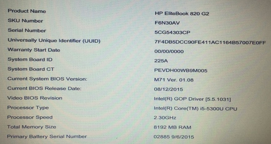

              #86
              Re: HP Elitebook 820 G2 bios needed
              Could anyone help me?
              i have the same problem of the others, i need to change the boot order because the OS doesn't work and it continusly restart. The bios have the administrator password setted, so i can t access it!
              below a screenshot of the bios.
              Please help me
              Regards

                #87
                Originally posted by longi
                hello,
                could anyone help me?
                I have the same problem of the others, i need to change the boot order because the os doesn't work and it continusly restart. The bios have the administrator password setted, so i can t access it!
                Below a screenshot of the bios.
                Please help me
                regards
                send old bios i try remove.
                • longi
                  • Oct 2017
                  • 3
                  • italia
                  #88
                  This all the information that i have.
                  Thanks in advance
