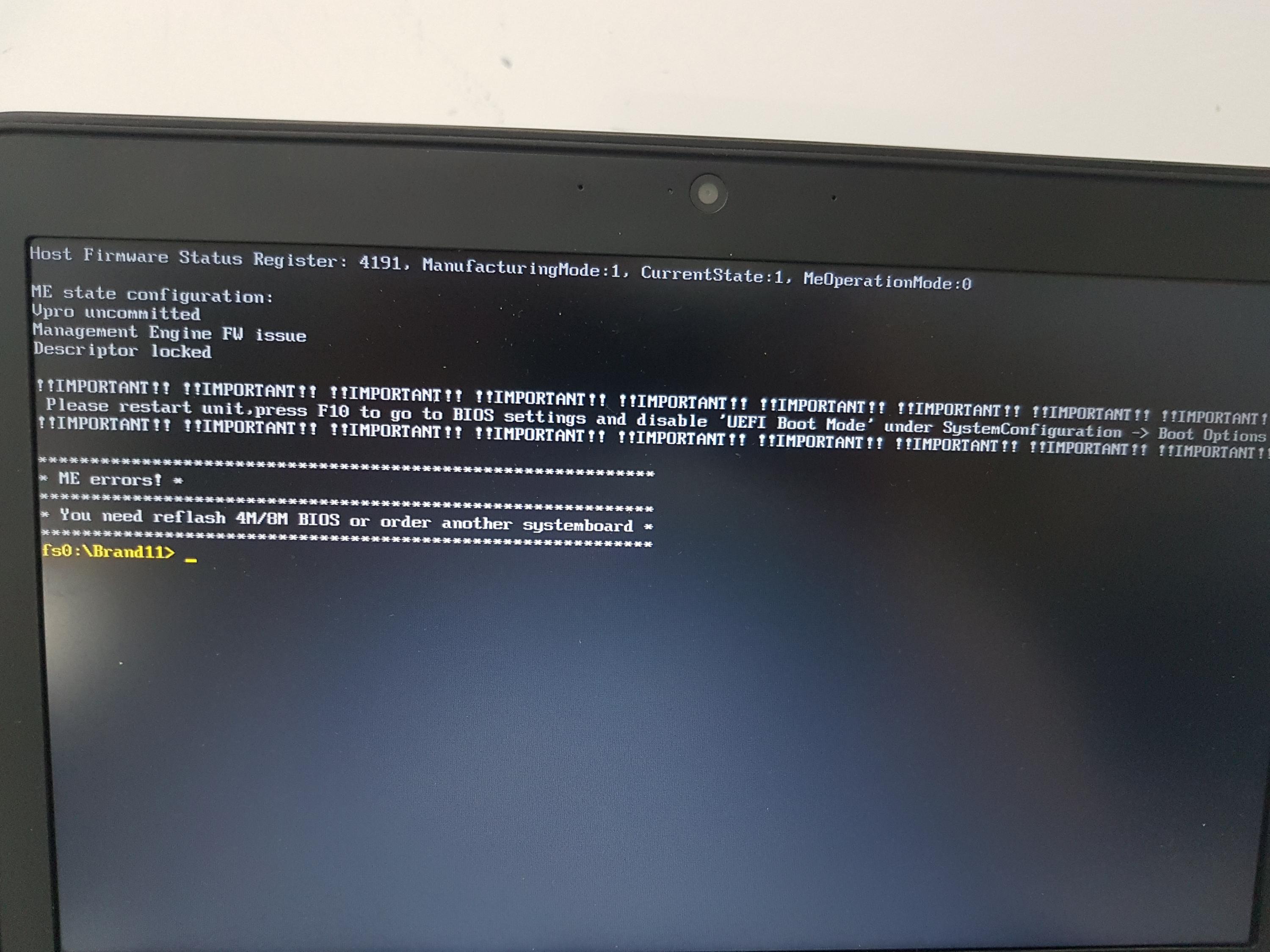

        finally changing programer I was able to manage the Winbond chipset.
        I successfully flashed EC+BIOS.bin on a 840 G2 (somebody kindly proposed here the 2 fulldump files)
        But I've an issue as the Elitebook start in MPM mode (Ok), but then detect issue "not in commited state", reset the bios and restore a config ... and I lost the MPM mode not able to get it back and use wmdmifit tool to enter UUID, SKU etc.
        Does somebody successfully recover MPM mode to configure an Elitebook ?

            I finally ordered another SPI programmer (EZP2013) as with the CH341 I never successfully programmed the Windbond Q128.

            No, after the warning, it was not possible to boot before the bios restored configuration (network etc.) and then the MPM mode was disabled before being able to boot WinME and run winmifit etc.
            Finally I got another Bios (here also) of 820 G2 (fully compatible with 840 G2), from somebody asked to clear password ... flashing with bios I got a fully workable laptop (no warning message etc.) BUT, I got also the SKU/Serial of the PC the Bios come from ... and not mine ...
            In any case for me the CH341 never worked for the main Bios chip, I tried several release of the software but once detected, then error to communicate ...)

                  Can someone please help me?
                  I have a 820 g2 with no original bios dump and the post image appears after 20 seconds. I tried all dumps in this topic.

                    The bios provided by RIORENO Page 4 is working and allow to boot and work reuglarly with correct SN/SKU etc. BUT you'll not be able to change them ...

                      Re: HP Elitebook 820 G2 bios needed
                      I tried this dump too, still 20 second until post image
                        try this
                        Premium supporters get full download access and other benefits.
                        • ardeyalex
                          Banned
                          • Feb 2014
                          • 36
                          • Romania
                          #52
                          Originally posted by dycc
                          try this
                          This works perfect, THANK YOU!!!

                            Can you explain what it means ME clear?
                            I have dump from post 4 in my elitebook too.
                              Originally posted by fifthy52
                              Hi DYCC
                              thx
                              it mean add the original intel management engine release by INTEL into the bin file

                                            Device Information:
                                            Brand/Model: HP Omen 17-cb107nr
                                            Motherboard Model: GPC27 LA-J672P REV: 1.0
                                            Serial Number: CND0323WY5
                                            The laptop powers on, all voltages appear to be normal, and it seems to boot up, but there is no display (no output) on the screen.
                                            The device was previously serviced at another shop. It looks like the BIOS chip was removed and reprogrammed before. I suspect the current BIOS dump on the chip is not original or is corrupted, causing...
