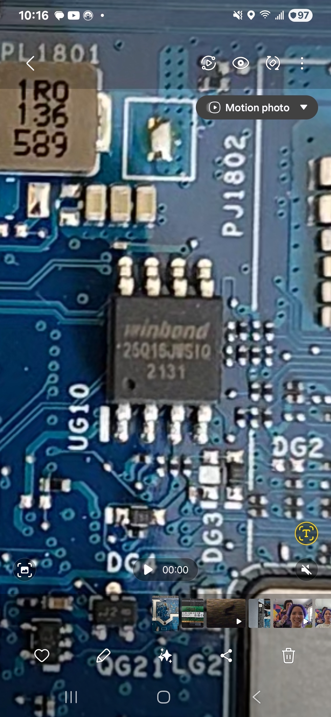

    Thanks for this Bios, it works, but still have a problem with booting. Laptop switch on I can open a Bios but windows not started, infinity loading. I try installing new windows but from usb same problem infinity loading.
    I want to try install new VBios, maybe you have it from same laptop?

      I would run memory test to make sure your RAM is fine. Then, I would attempt to do built-in hardware troubleshooting by hitting F12 key on start.
      My only experience with infinite loops has been involved CPU issues, in particular one or more pins losing their bond with the motherboard. In that case reflowing the CPU may do the trick.
      I doubt the issue is with the graphics card.

        This happened after windows update, before everything works perfectly.
        So I think, need to try change VBios. It's last what I didn't try
