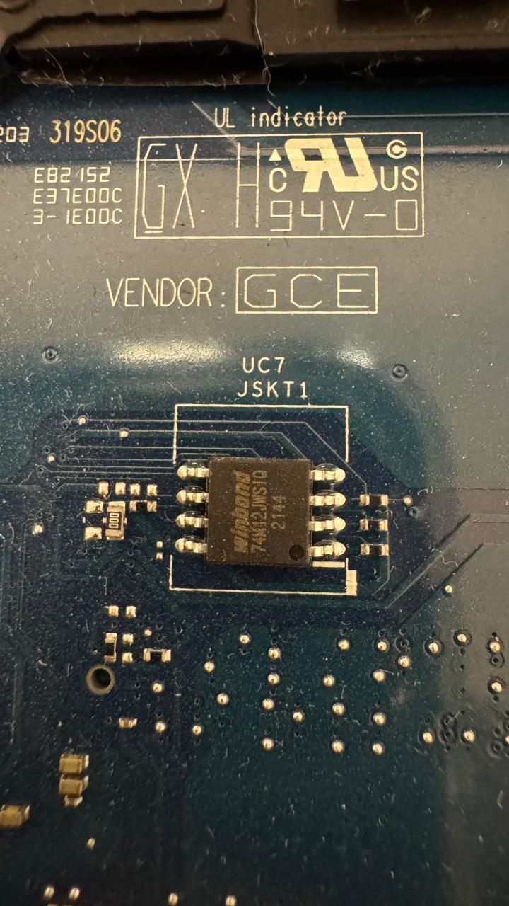

    hey
    Excuse my ignorance, but as you say that the chip is wrong, as it is the chip that came with the machine, what happens is that I need to re-program it.​
      • 21634
      Originally posted by Dack_bb
      hey
      The 25Q16JWSIQ chip is 2MB ,it is for firmware or the vBios, not sure which,but it is not the bios chip.Do not touch it ! Look for a chip that says 25Q128 on it https://www.aliexpress.com/i/1005005024847169.html
      • volinakis
        • Jan 2021
        • 2872
        • N/A

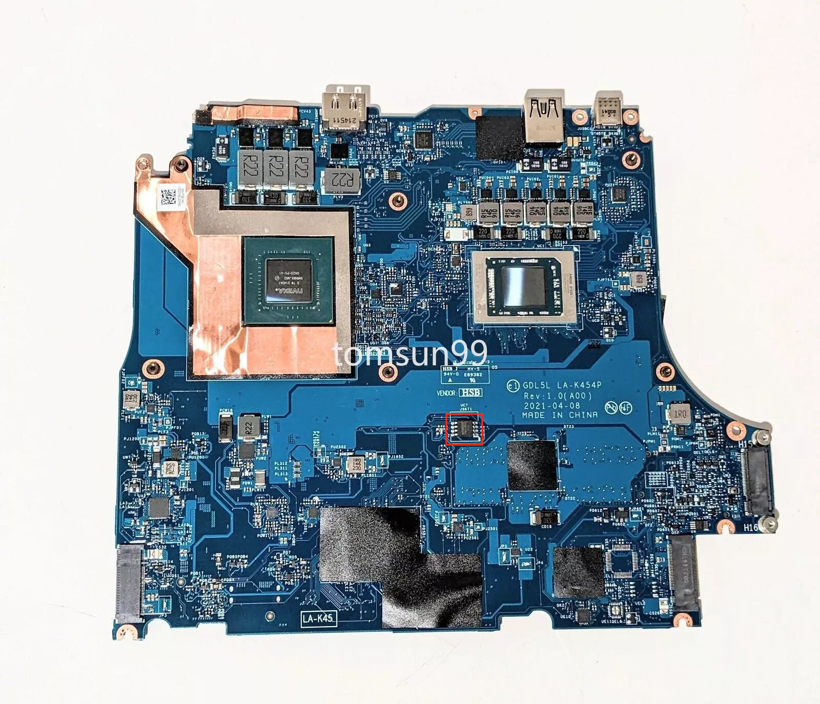

        hey
        try that one in red square Click image for larger version
        • Dack_bb
          • Jul 2024
          • 4
          • BRASIL
          This chip that you marked has the second ID:
          74M12JWSIQ​
          • volinakis
            • Jan 2021
            • 2872
            • N/A
            74M12JWSIQ​
            yep, that's bios chipset
