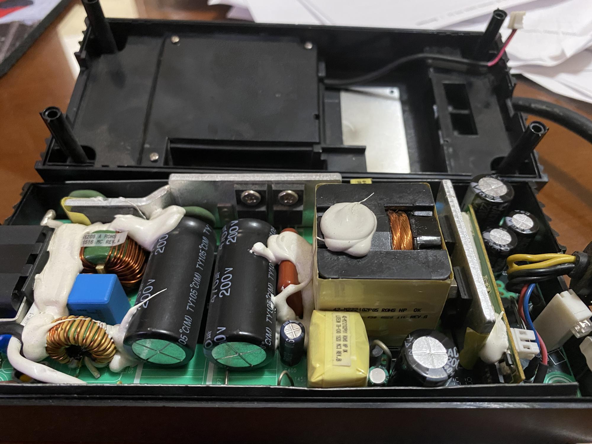

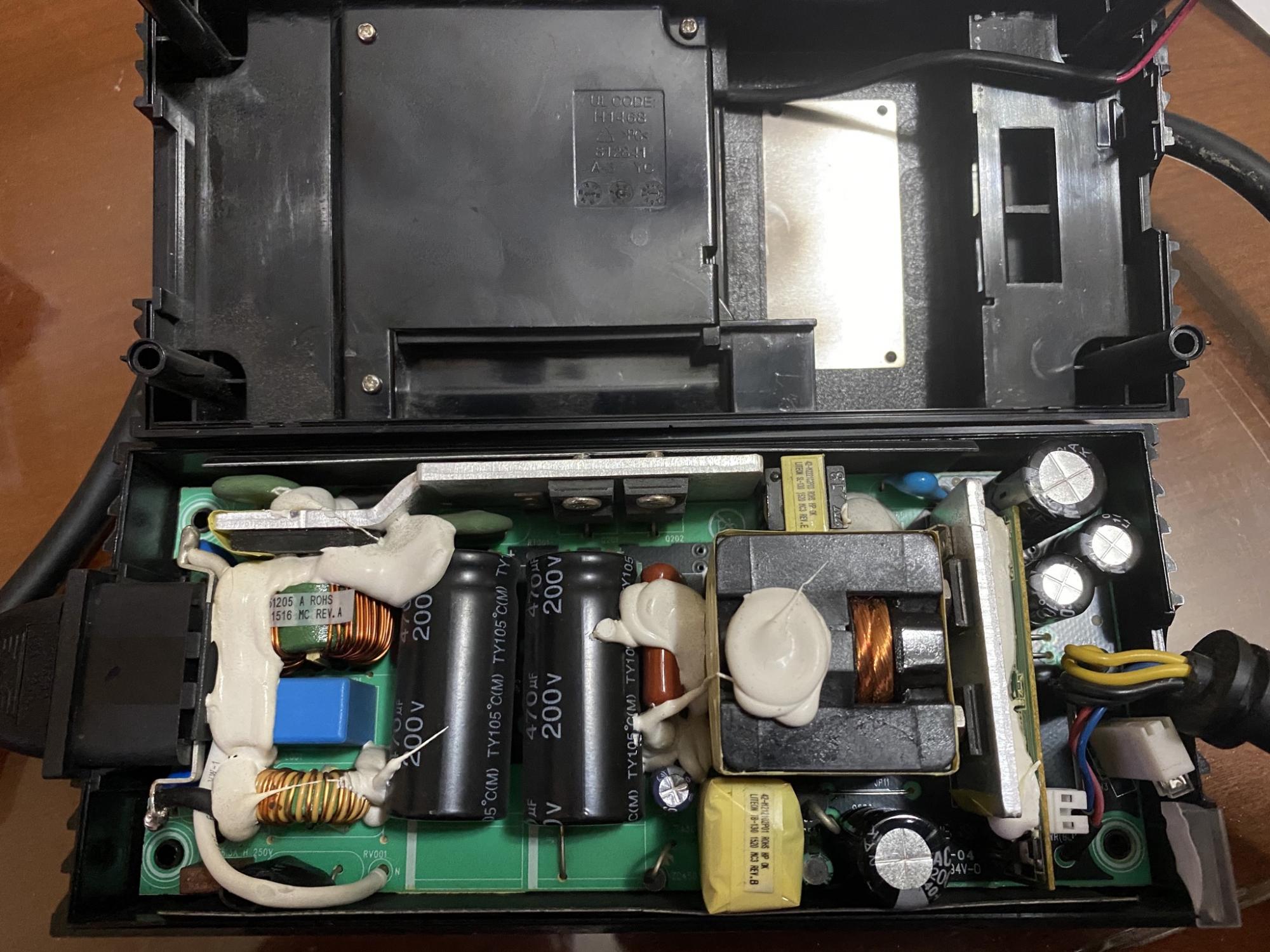

    I replaced the (2) 1000uf 16v caps (top right hand larger & bottom right hand larger in the pic)
    I replaced the (2) 2200uf 16v caps (top right hand small caps in the pic)
    (even though none of them were visually showing signs of failure)
    I think I know this group well enough to know we can fix it! I think I know this group well enough to know the expertise is here to do it (just not with me).
    Any thoughts on Next Steps?

    Looks like a dual-output PSU. Probably 5V or 3.3V standby and a main 12V output.
    Since the orange light is dying when the PSU is plugged into the console, that suggest the standby supply may be having issues.
    As such, there is a good posibility that the issue may be related to the start-up cap(s). I see two caps that fit this description. One is C400 (a small-ish cap next to the two large 200V caps) and the other is a small green cap next one of the small yellow transformers (this appears to be the standby transformer.)
    Before changing them, try heating the PSU with a hair drier inside - particularly the are of these small startup caps. Don't get it too toasty. Just where it is hot to the touch, but not burning. Now try plugging it into the console and see if it the light goes out. If it doesn't, then those startup caps are very likely bad. And if the light does go out, you may have to change those startup caps anyways to make sure that is not the issue.
    Also, just a curious question: what brand and series were the original caps in the power supply and what brand and series did you replace them with?

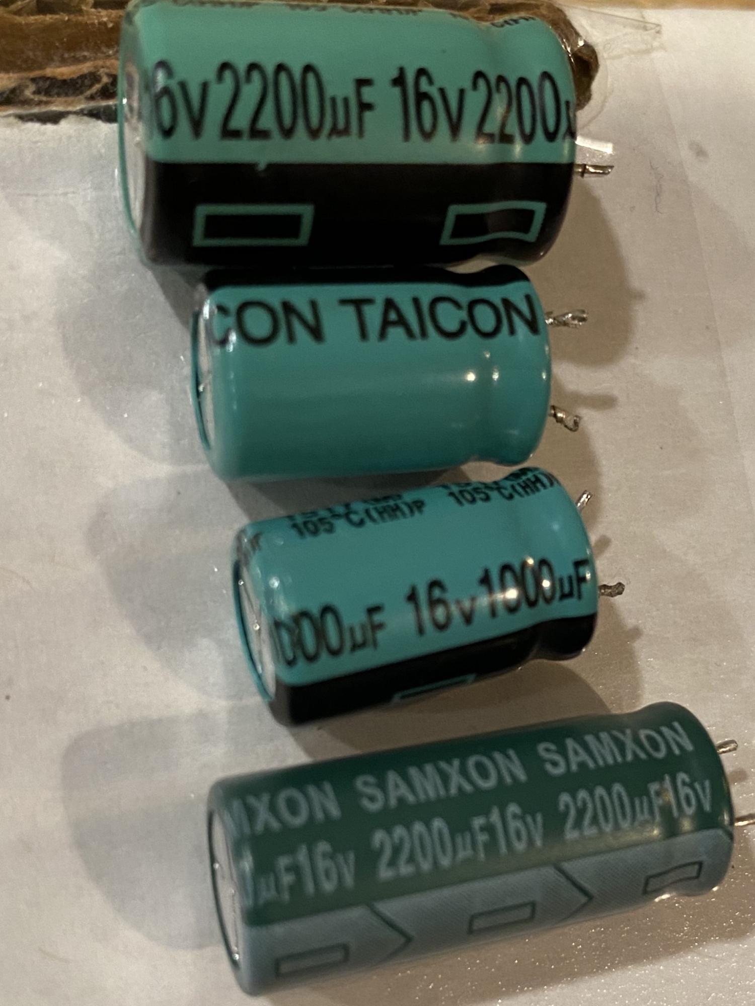

      The original caps were (3) JACKCON LHK Series & (1) Samxon. Pic attached.
      The remaining “suspect” caps are so tightly grouped on the PCB that I can't read the ratings. Tomorrow I’ll desolder, order, install & reply back on results.

        OK, I see now the originals are three TAICON caps (not JACKCON) and one Samxon, but looks like you used the JACKCON caps for the repair. If that's the case, you may be better off with the Taicon and Samxon caps back in, as JACKCON is pretty terrible for reliability... but let's just keep the old caps for now (don't throw them away yet) and leave the Jackcon caps in the adapter for the time being.

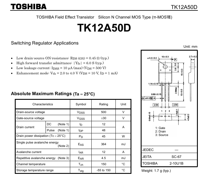

                  I had the same problem, changed:
                  • 1000uf 16v caps
                  • 2200uf 16v caps
                  Actually only one of them presented signs of failure, but it didn't worked so I changed the rest of them.
                  Until I saw on this post that it could be a faulty MOS.
                  IT WAS INDEED.

                    @MaxumElite: Can you confirm that you had the exact same problem as original poster? He stated that his power supply had orange LED and would turn off as soon as plugged into xbox console. The failure of your high voltage 500V mosfet is a high-side problem and I would think you didn't get any LEDs on the power supply (orange or white) at all? This issue is independent of the failing low side capacitors. Just looking for more info. Thanks.

                        Hello, I had the exact same problem:
                        Plug in to wall: Orange (Standby Light) comes on
                        Plug in to Xbox One: Lights go off (not white or blinking)
                        I tried a different PSU (a cheap one) and the xbox worked perfectly.
                        A capacitor was inflated thats why I changed it instantly (changed the others also just beacuse 😅😳), but even after that the failure wasn't gone.
                        So thats why a came looking for some light and realized that it was indeed a faulty MOS.
                        All this happend me after my original HDD started to fail. (I dont even know if it has anything to do with)
                        Sorry if I wasn't that explicit in the first post.
