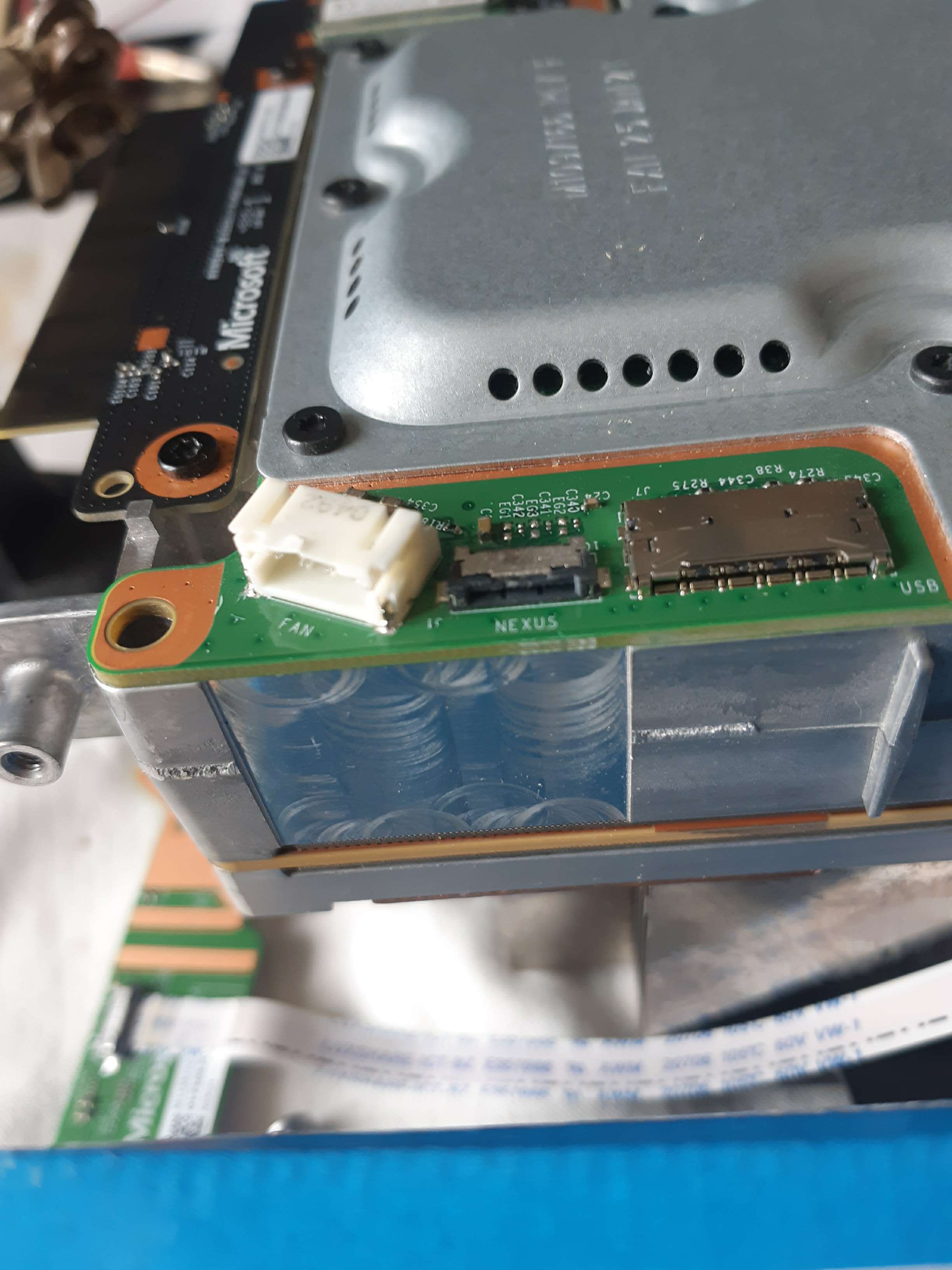

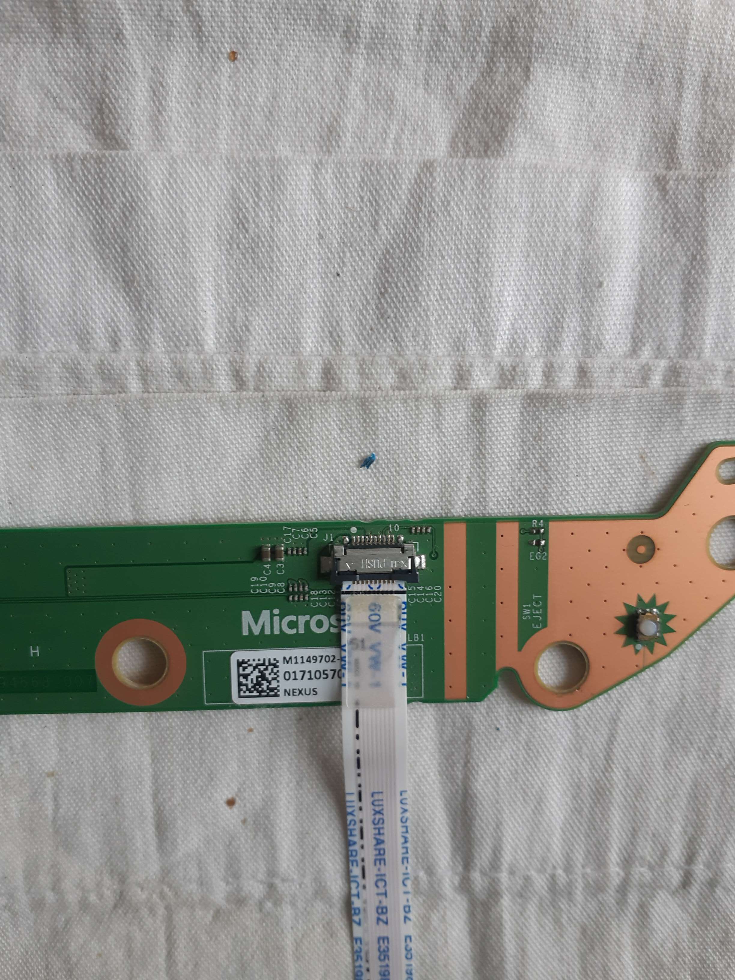

    Inside the console there is a small circuit board (see photo) that contains the main power switch, the one on the front.
    This circuit board connects to a 10-pin flat cable called NEXUS that terminates on the motherboard.
    This NEXUS connector broke.
    Can anyone tell me, while waiting for a replacement, if it's possible to turn on the Xbox by disconnecting this circuit board and making some modifications (like adding a small power button) on the motherboard?
    The Xbox has a power supply that provides 12 volts on all outputs, so the power supply is fine.
    Without this circuit board connected, can you tell me if I should receive any visual or audible indications from the console?
    Is it possible that without this board there's no alternative method to turn on the console?
    Thanks to anyone who can help.

        If your nexus connector is damaged, remove the flex ribbon cable from the connector and try inserting a disc into the drive. The XBOX will turn on automatically. Then you can pair or use a USB connected controller as normal. If a disc is already in the drive, use an unfolded paper clip or other small diameter rigid wire/item to manually eject the disc through the small hole on the side of the disc drive and re-insert the disc and try again.
        If the XBOX is otherwise working condition, this will turn on the XBOX.
        I had an XBOX series X with a damaged nexus connector on mainboard, and XBOX would not do anything until the flex ribbon cable was removed. Not sure why, but maybe something inside the connector was shorting to ground. These are very delicate and easy to damage. A damaged connector will often make a console appear completely dead.
        Also, if you have no luck, use good light and magnifying lens to see if any pins inside the damaged nexus connector are bent or touching each other or the grounded shell of the nexus connecter internally and see if you can bend away from the contact point.

            If you did not connect the 12V two-pole connector between the power supply and the motherboard, then the XBOX would not turn on for sure. The power supply provided 12V, 5V, 3.3V as well as ps-on signals, etc. Other voltages are generated on the motherboard from the 12V, 5V or 3.3V.
            Without the 2-pole connector attached, you won't really damage anything but If the 12V is missing, so are the lower voltages generated from that 12V power rail.
            Many times, the flex ribbon cable is also damaged when the nexus connector is damaged and I do not recommend re-using it. Sometimes the ribbon pins are damaged or bent or broken and can cause other shorts.
            Because the flex ribbon is secured to the case with adhesive, the separate power board with the power button is usually ok (doesn't really get pulled on). Usually, it is only the nexus connector on the mainboard which gets damaged.
            When replacing a broken/damaged nexus connector, it is helpful to flood the solder pins of the old one with fresh flux and lead solder (lower melting point) and remove it slowly with the heat from a direct contact soldering iron.
            When installing a new nexus connector, it is difficult to solder directly and even using a hot air re-work station I only ever re-install a new connector by heating from the bottom with hot air so I do not melt any nearby plastic connectors on the top side by the nexus connector.

                      I have some good news. After replacing the Nexus connector, I also had to remove the 22 nF SMD capacitor C1 next to it, which was shorting and causing pins 1, 2, and 3 (referred to ground) to drop to 0 volts. So, everything is fine now, the Xbox is finally working! ....
