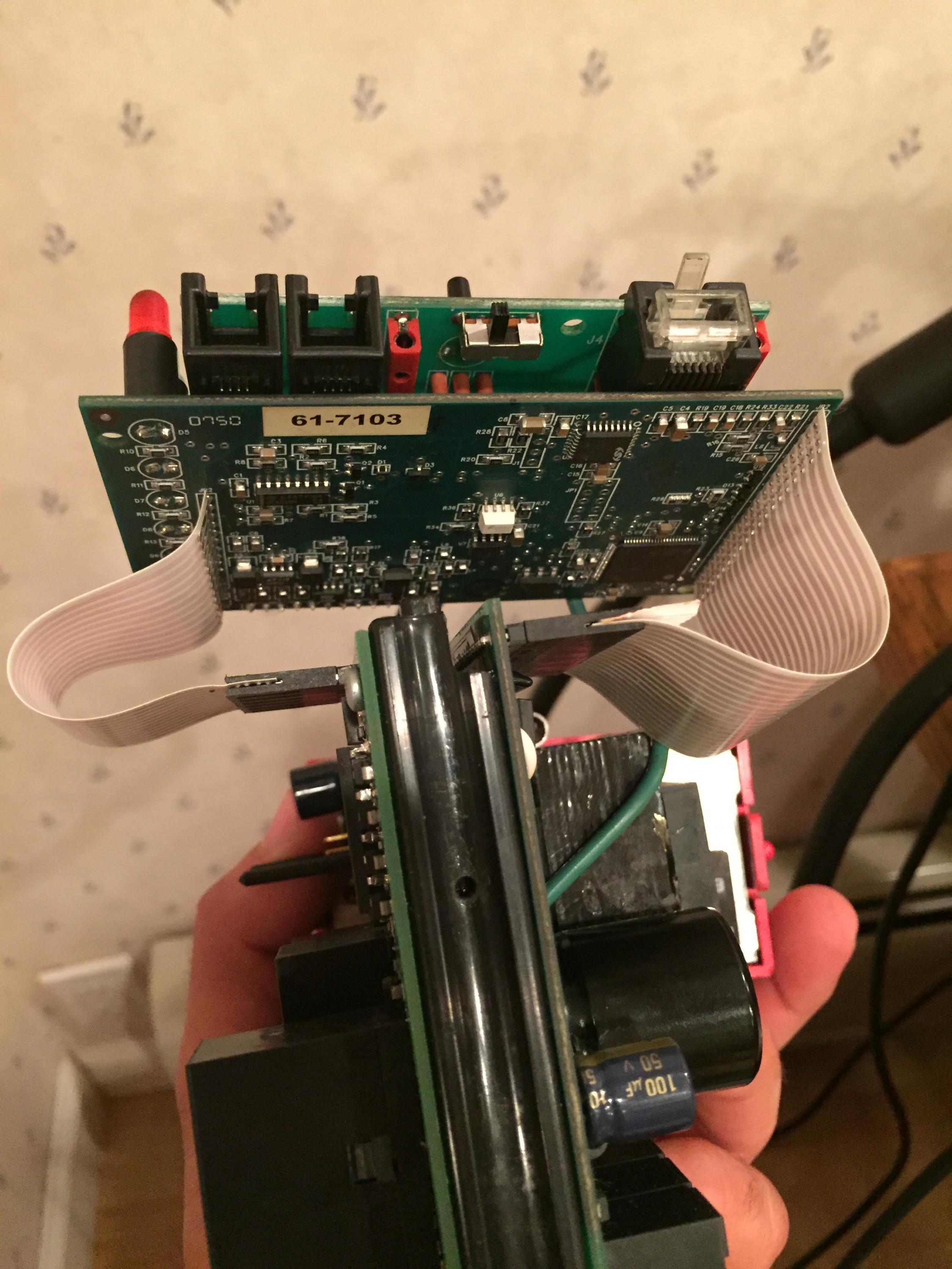

    JF1 pin voltage = ~30V, pictures of other boards coming right up.....

      "JF1 pin voltage = ~30V, " 30V source forcing current through a small inductor through shorted circuit, no wonder it blew up.

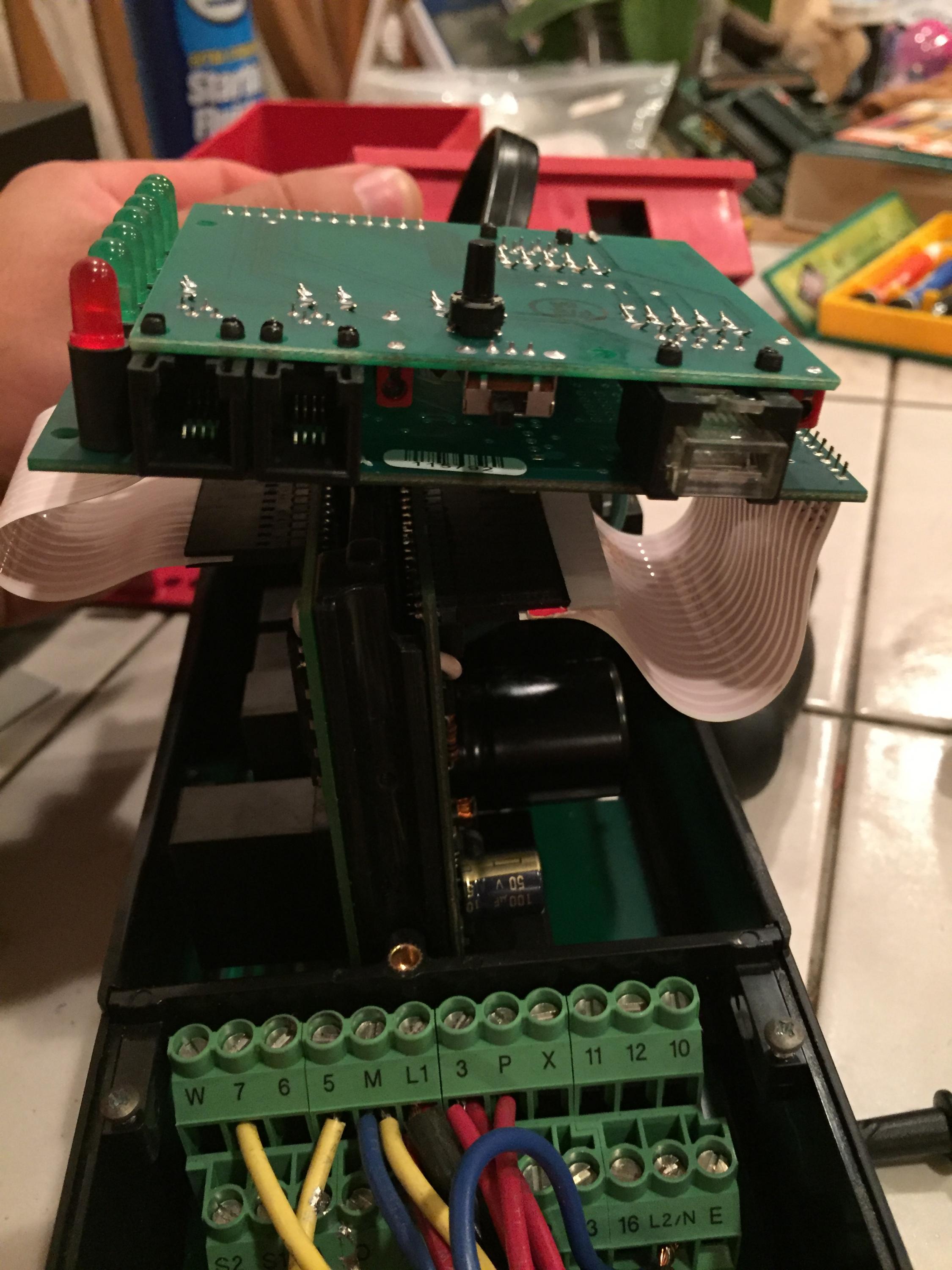

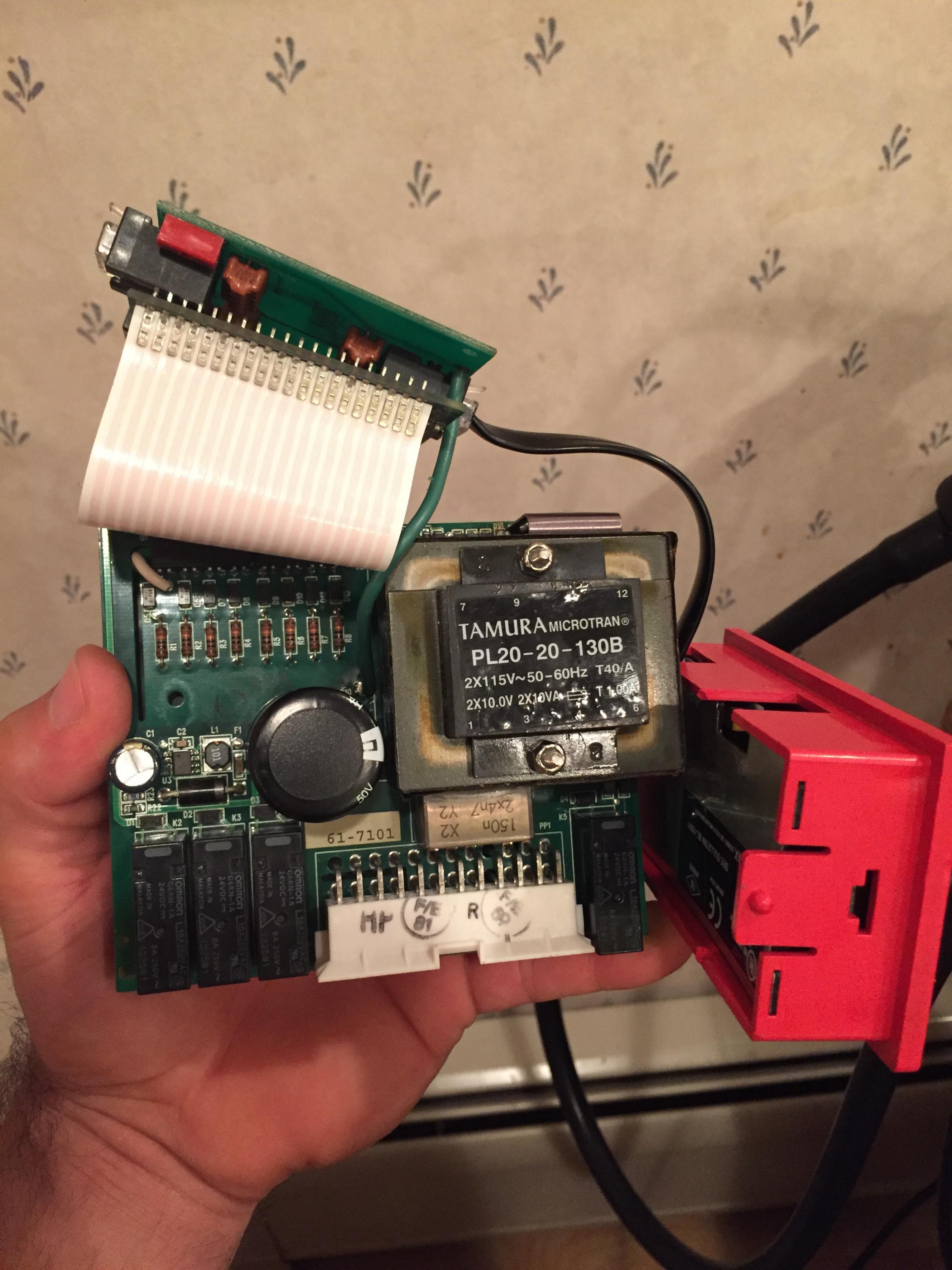

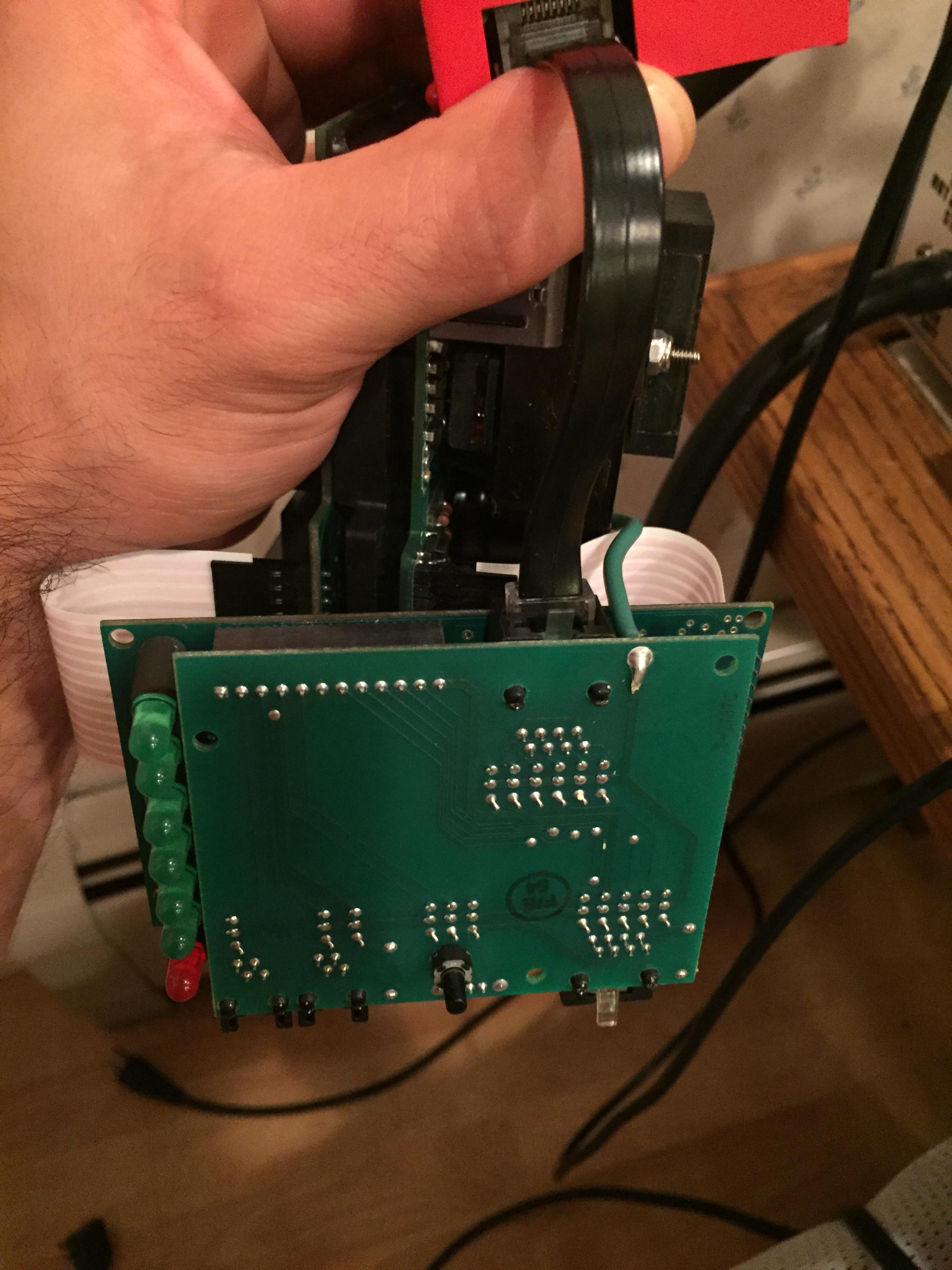

        Re: Short to ground on display board, how to find the culprit?
        Here is how everything is connected.
        In the last picture, the last pin on the right in the row of horizontal pins on the upper left of the board connects to JF1.
          In the last picture that JF1 pin (connected to burnt coil) seems to go to J4 (rj45) jack that has a blank rj45 plug in it, is it not normaly used and is it possible someone pluged in something they should'nt have blowing the inductor on the otherboard?
                looks like it could be a second 4-20 ma current loop output like the other rj45, just not used in this application. did you ever clean up all the burnt carbon and try the board?
