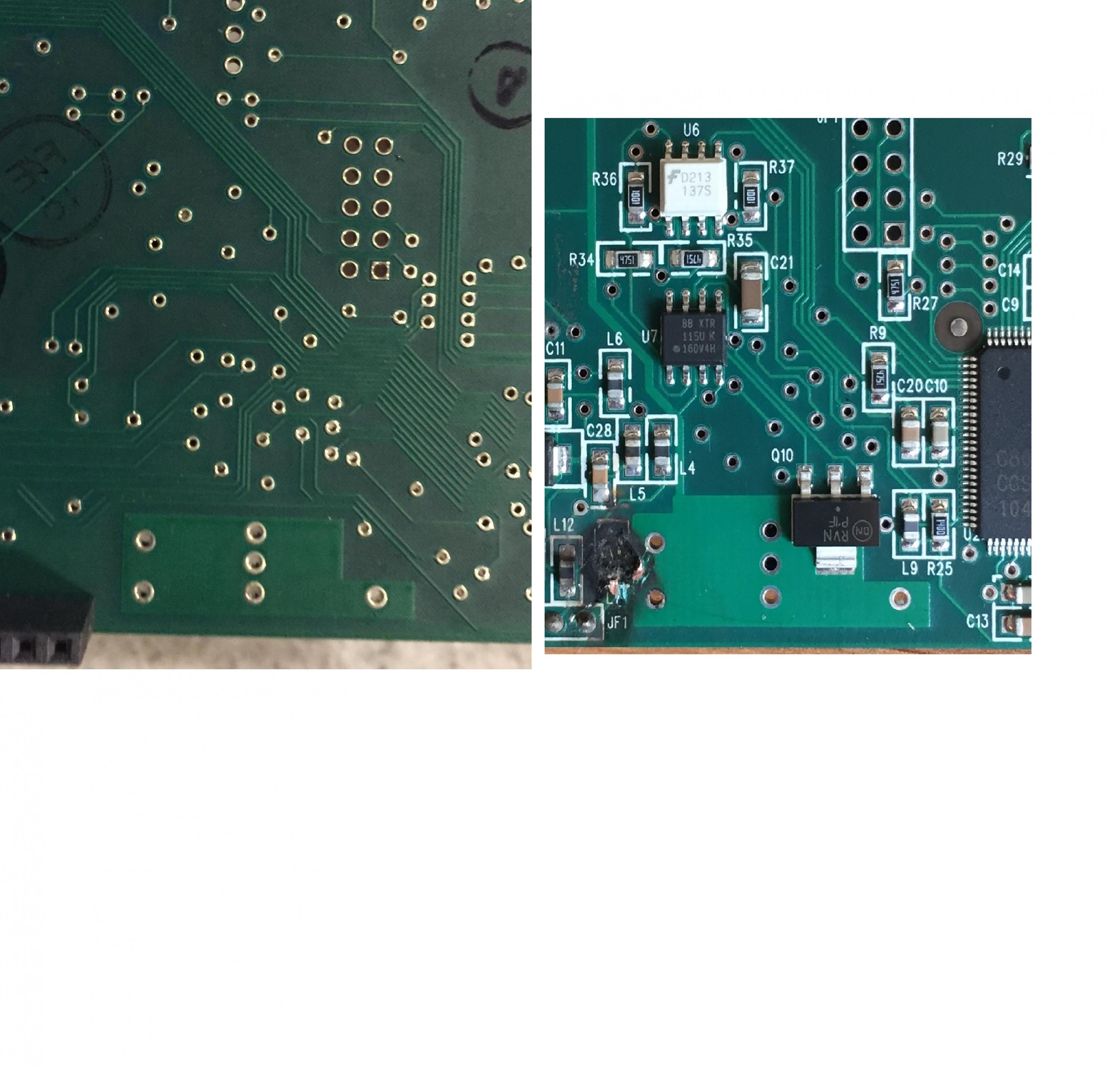

    Hello All,
    Back at it again with another board issue.......
    I unknowingly plugged a display module that had a shorted diode into this board, the result was a puff of smoke and the crater by the ground plane seen in the picture below. Having another board with the same issue, I began to test and remove components one by one with the hopes of figuring out what the shorted diode destroyed but haven't had any luck.
    It seems that many components are shorted to ground as well after the initial incident, I'm not sure how else to diagnose this issue other than removing every single component until the short disappears.

    So you have a board with shorted circuit that you connected to this board and it blew up the inductor L??.
    Are you trying to find out where the shorts are in the display board or you are trying to find out what get damaged on this board when shorted board is connected to this board?

      if you want any chance of fixing that, you need a schematic - there is probably damage between the layers.

        Thanks for the quick responses guys!
        Bud, I found the shorted diode on the display board, replaced it, and now it's working correctly. I'm trying to determine what is shorting to ground on the board in the picture, and it seems to be everything, literally.
        I'm afraid stj is probably right, and there is most certainly no way of obtaining a schematic for this board. Anything I can try to salvage this thing or is it not worth the effort? As an interesting side note, I've repaired the same model board with the same burn mark, just not as severe, should I assume that on those boards the damage wasn't bad enough to affect the layer under it?
        I'm still trying to wrap my head around single layer boards but multi-layer? That a whole new dimension of unknown to me.......

          It seems to me that that output pin of the JF1 connector that goes to the blown inductor is probably for supplying the Voltage to the display board.
          Please clean up the board so you can easily see the trace to find out how that inductor is connected in the circuit.
          When you are saying shorted to ground, at which point on the board that is show 0 Ohms to GND?
          BTW, so you have more than one of this board?

            Your first assumption is absolutely correct.
            When I say shorted to ground, I mean that when I beep test from the ground plane to most other components on the board, it beeps. On a functioning board, all of these components do put out an Ohm reading when tested, but don't beep. When power is connected to the board it just about catches on fire around that black crater by the ground, leading me to believe that there is a direct short to ground there.
            I have many of these boards at my disposal, attached is a picture of a working one. In most cases, the L7 inductor is the only component that is bad, replacing it makes the board function correctly.

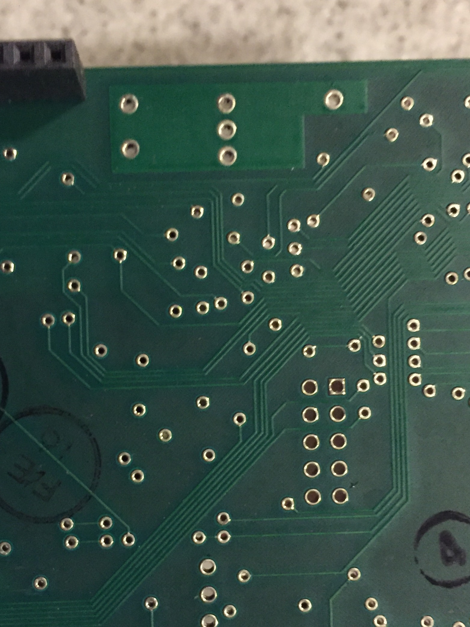

                there is a via in the crater, you need to grind out all the carbon and then link anything that got cut.

                    Not sure about the meter as it is a cheap one, I'm at work now but I will take a picture of the other side when I get home!
                    stj, how do you know there's a via in the crater? I've attempted to grind that spot out on other boards, it seems like there was copper there, not sure how I would figure out where it goes?

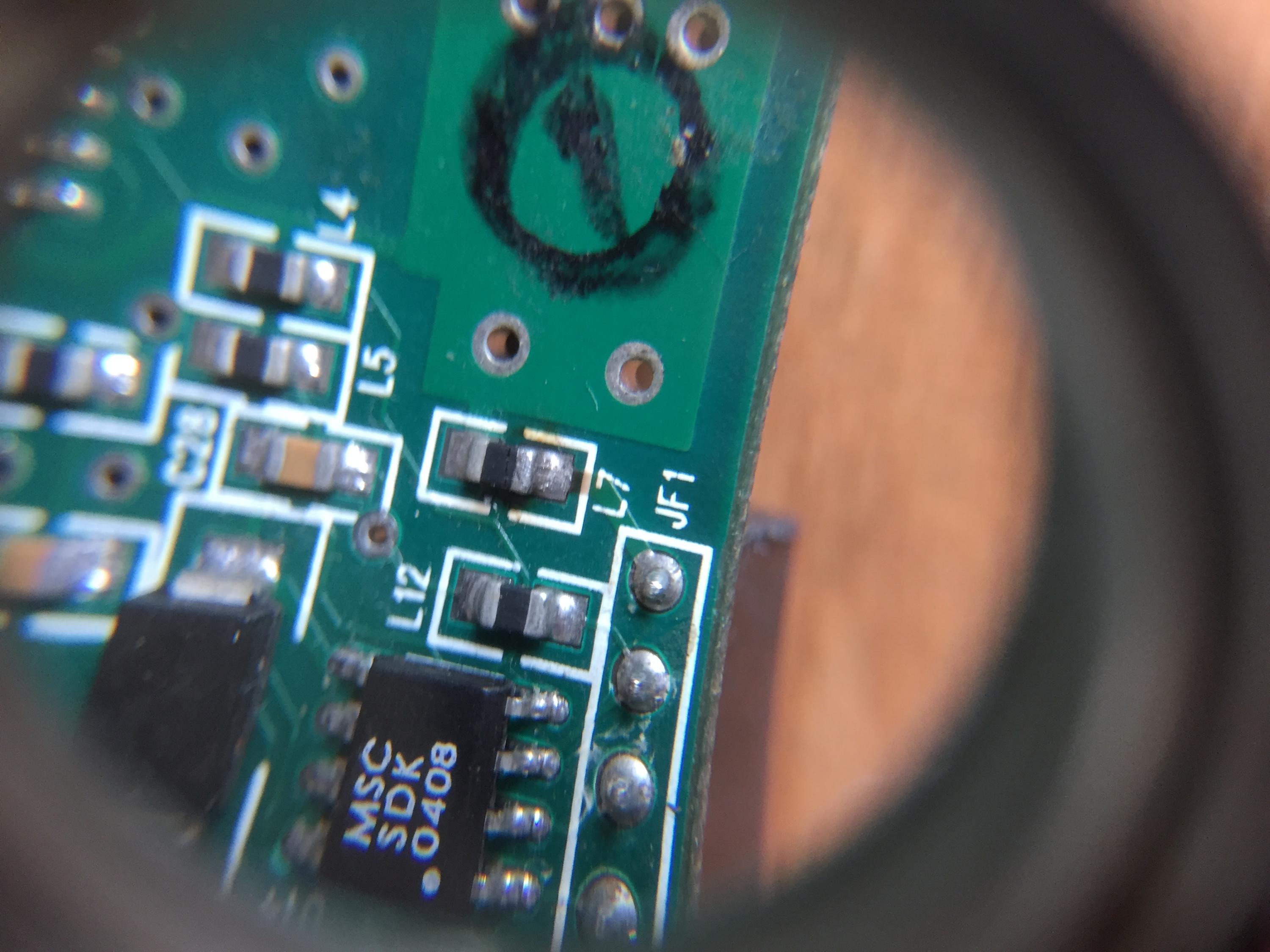

                      Did this board get some water on it? it looks like it (white residue around JF1 pins) That could have started the arcing under the L7 coil, so once the carbon is removed it might be ok???

                        I don't think there is any VIA under that inductor, just remove the inductor and see.

                          directly right of the upper pad of L12
                          it's tiny, it could be a "hidden via"

                            I thought you are talking about there may be VIA under the L7, the VIA above L12 looks intact to me.

                              not above, directly to the right in the center of the crater - it may have been linking the upper missing pad.

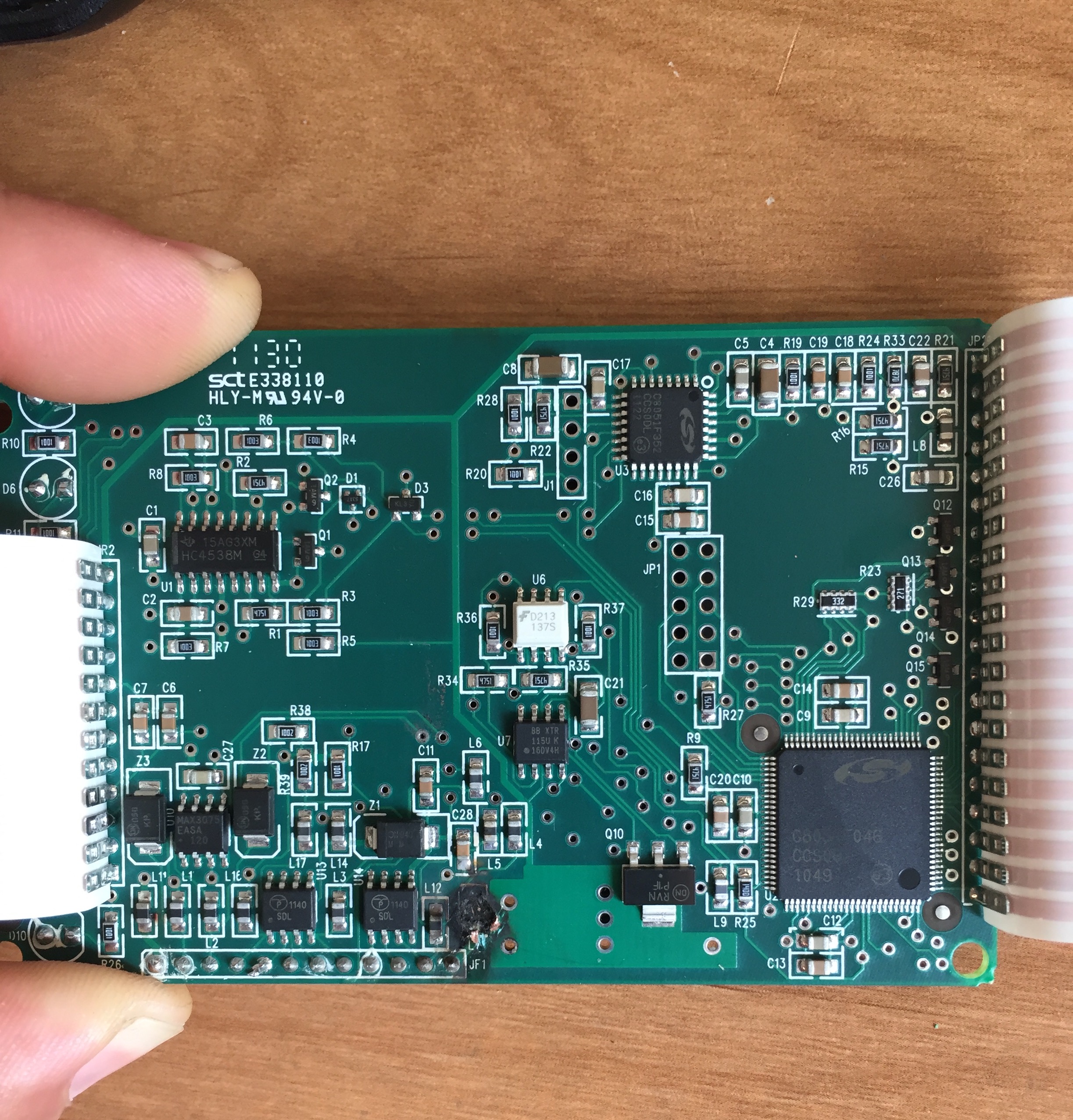

                                Here is the other side of the board.
                                I might be able to take a scrap board and scrape the solder mask away to see what's going on underneath that area, is that worth doing?

                                  it seems to be double side board, there might be a middle layer but I doubt it.
                                  This looks like the ic and it is connected to the pzt2222at1 transistor.
                                  I flipped the bottom view so it makes it easier to trace

                                    I think the OP need to really verify the so called 'SHORTS' because the meter is beeping in continuity mode, it beeps does not means it is shorted.

                                        Re: Short to ground on display board, how to find the culprit?
                                        That board (Voltage supplier) looks to be supplying the Voltage through that inductor to the connector JF1 pin to the display board (the load), so when you have shorted load (shorted Diode on the display board as you had described), that inductor will blow up due to very high current flowing through it; the inductor can only handle current up to the limit of the spec.
                                        Since you do have working set of board why don't you just check the DCV on that pin of the connector.
                                        May be you should up load the pictures showing how all the boards are connected together and how the Power supply is connected to this device which we do not have have the make and model yet.
