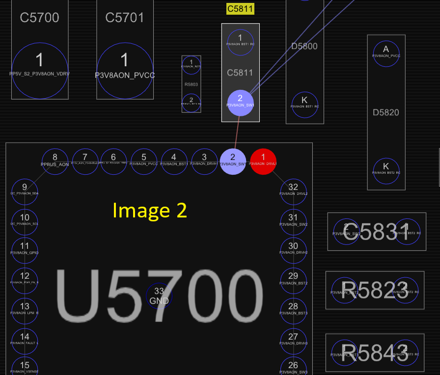

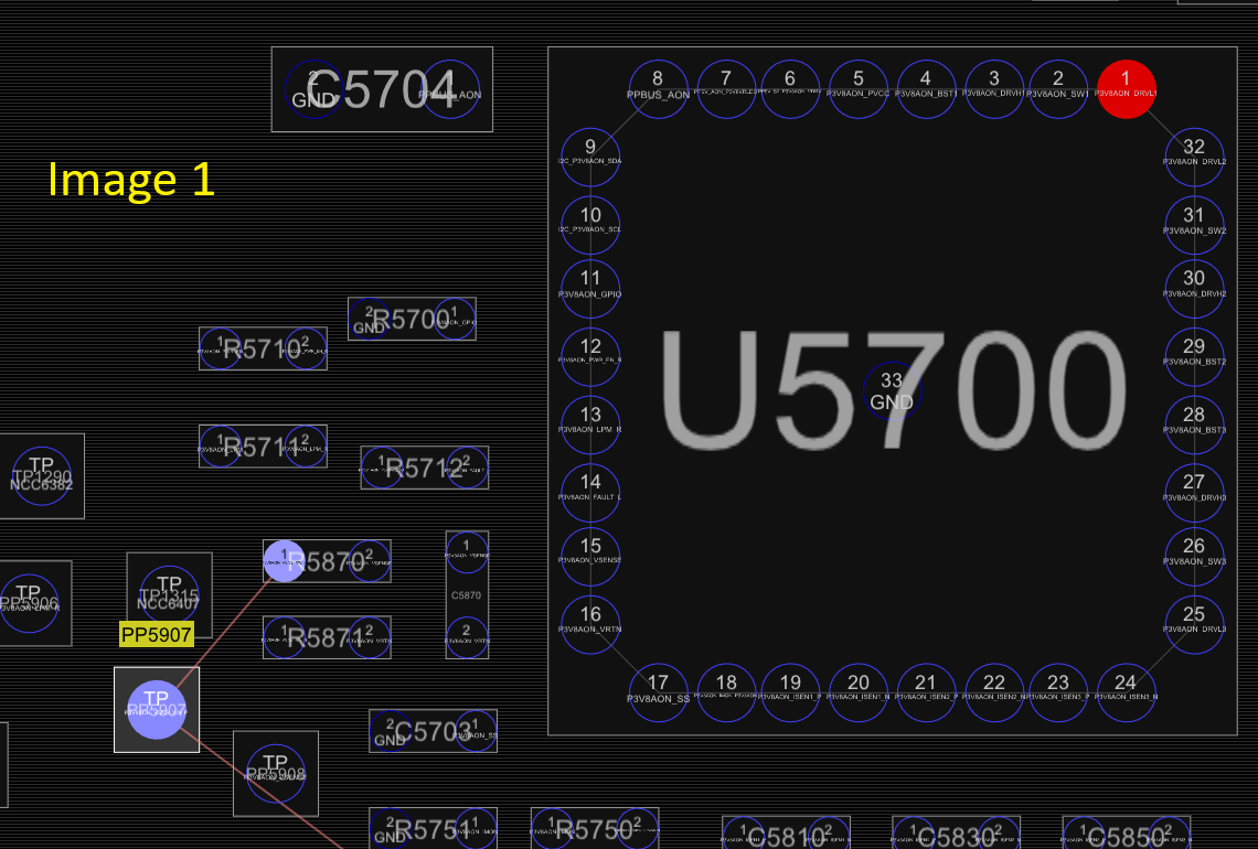

    Found something else that may or may not be related. When testing resistance to ground between working donor and faulty board, I get some wildly different measurements around U5700.
    For example:
    Resistance to ground, and diode mode to ground at the highlighted test point (PP5907) on both boards:
    Donor Board: 267 Ohm -0.131v diode mode to ground
    Faulty Board: 380k Ohm - 0.324v diode mode to ground
    Resistance to ground and diode mode to ground at the highlighted pad (pin 2 of C5811) on both boards:
    Donor Board: 266 Ohm - 0.131v diode mode
    Faulty Board: 440k Ohm and still dropping after waiting 3 minutes. - 0.324v diode mode
    The remainder of pins around U5700 are fairly close between donor and faulty board.
    Not sure if this could be related to the actual issue.
    U5700 is on the direct opposite side of the board from the underfilled NAND chips, so wouldn't want to do that unless absolutely necessary and a likely culprit.
    Worth swapping out U5700 and could this be causing the main issue?
