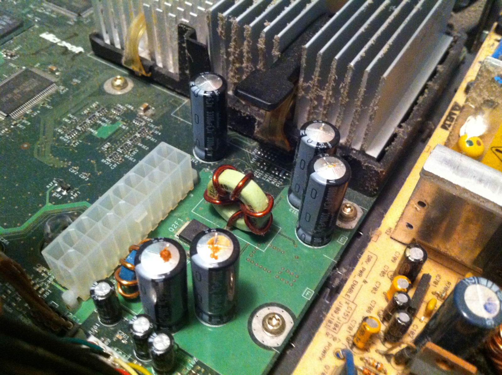

    Hello, I am a big fan of the original XBOX and I decided to buy (another) one. Taking it home and plugging it in, I discovered that it didn't even turn on. I searched through the internet and I read a lot of people saying it's most likely a power supply issue, so I decided to look myself. I also have another original XBOX that works fine with the same power cords, so it's not a cable issue.
    So then I opened up both XBOX's. The one that works looks fine, the PSU is a DELTA brand and it shows no signs of wear on top or underneath. Everything on the motherboard looks fine as well.
    But then I opened the XBOX that just simply doesn't turn on, and I immediately noticed something out of the ordinary. The capacitors were bulging, sticking out, and a few of them have some residue at the top. This was something I noticed right away as the XBOX that works looked very clean, yet this one has capacitors that look dysfunctional.

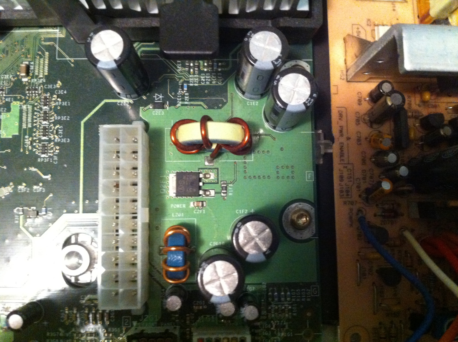

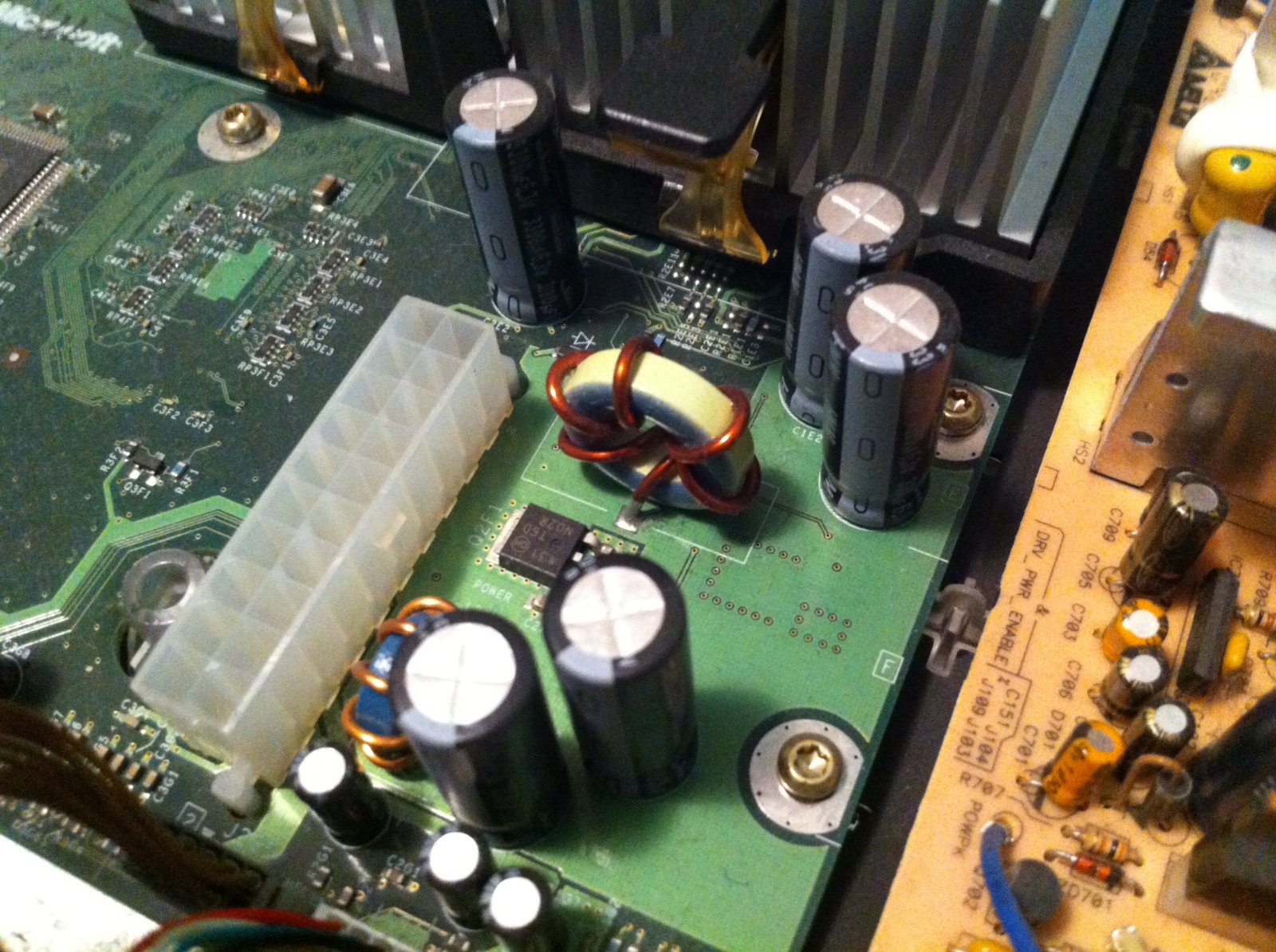

    Here are pics of the capacitors on the motherboard for the XBOX that works:

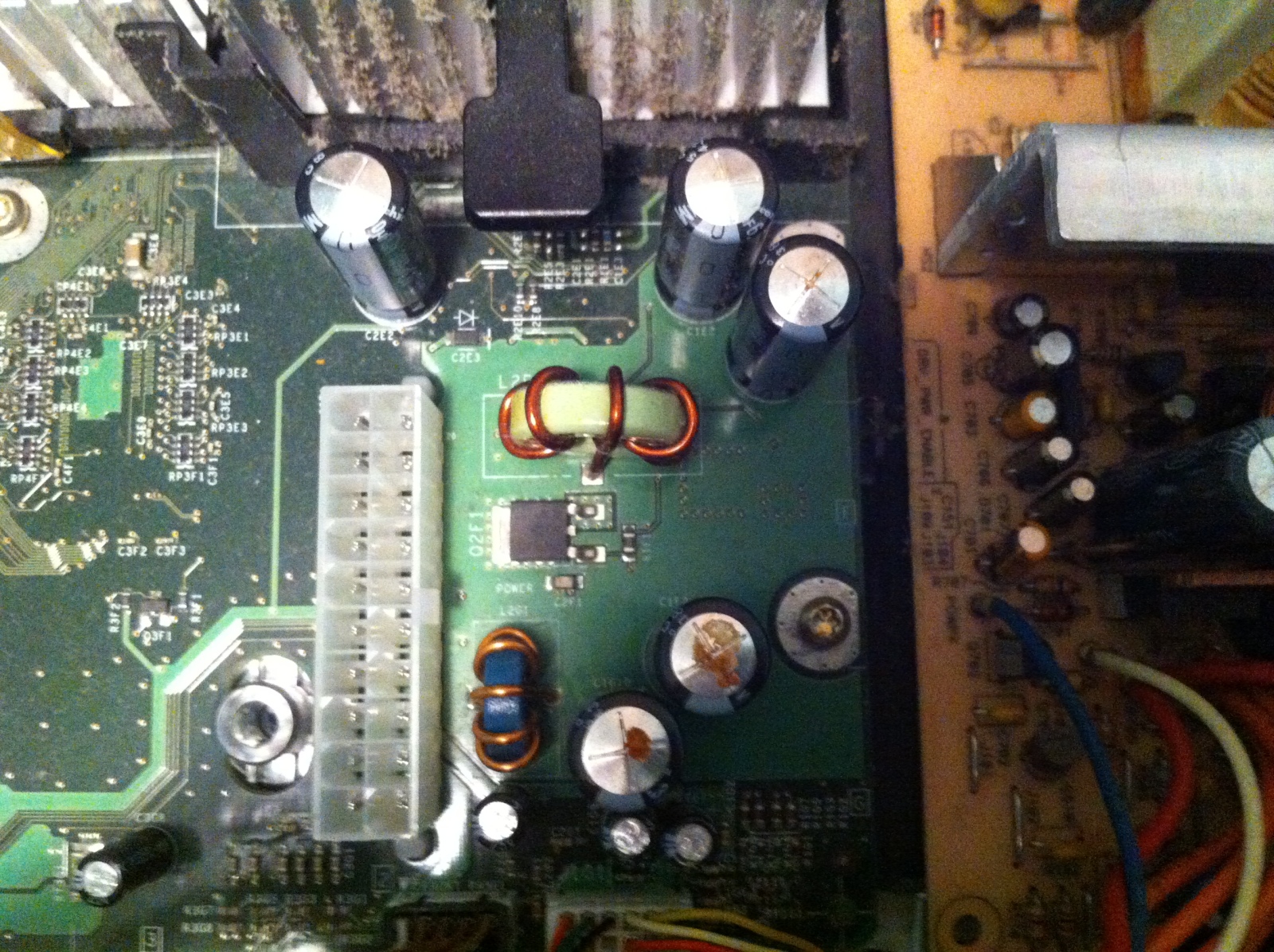

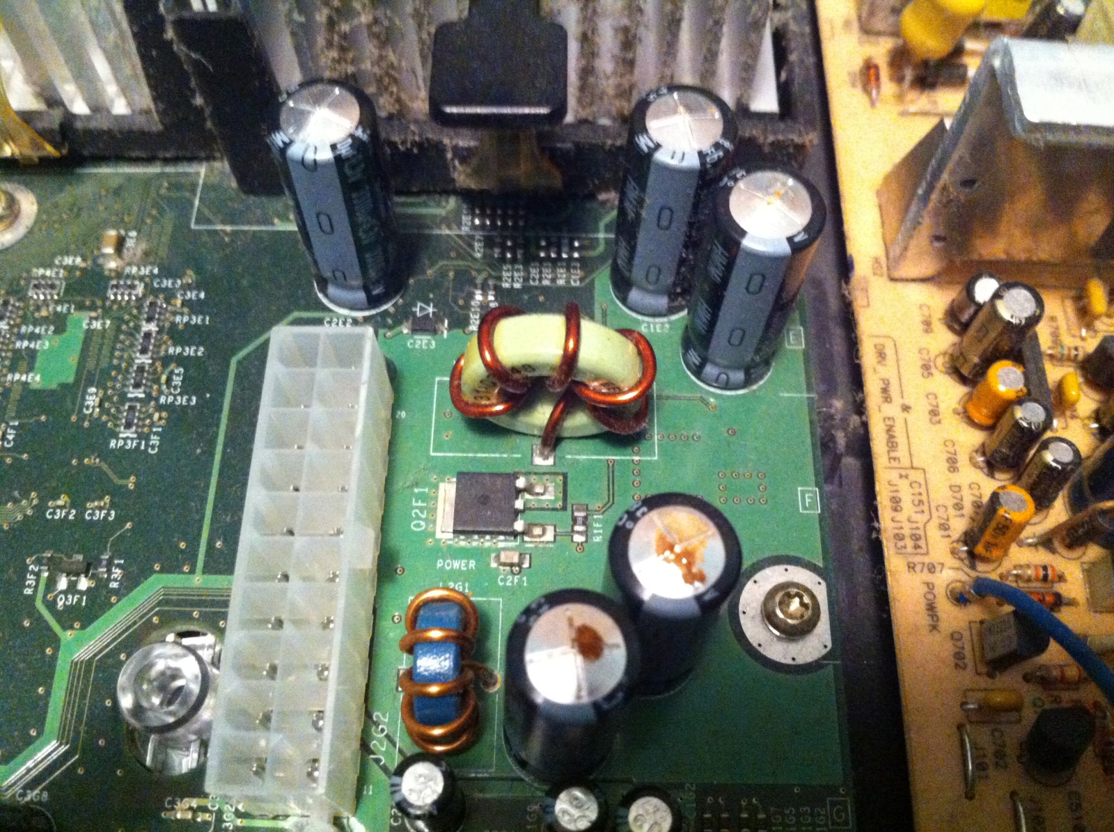

    Now here is the broken XBOX's motherboard:
    As you can see, there is something very different going on with the broken XBOX. These capacitors say on the side: 3300uF 6.3V --- The brand name is nichicon.
    So what do I do now? Desolder and remove these bad capacitors and replace them with new ones? I checked the motherboard and nothing else looks wrong. I know capacitors are readily available and I hope replacing them with the one's in the broken box will make it work again.
    Either way I need to learn to solder, and I have no problem with that. I would rather fix it myself then have someone do it for me.

    Re: XBOX Original - Won't power on
    Yes, you'll definitely have to replace all of those bulging and/or leaking capacitors. They have failed.
    This could prevent the unit from turning on. Unfortunately, there is no way to tell if anything else has been damaged, without first replacing the caps.
      Yeah you really should replace those.
      As shovenose said, it is hard to tell if they are causing the failure, however quite often this is the case.
      Don't replace them with capacitors from the local electronics store, they are likely going to be cheap ones which aren't "low-esr".
      Nichicon does make good capacitors however, they did have a batch of bad ones.
      These should do the trick!

                                    Just registered to say that I had the same problem. Replace all 5 bulging caps from BC and everything is up and running again. Thanks guys!
