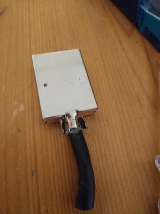

          @bulkchart32: Are you using the same video cable for all of your XBOXs?
          I had a Monster brand cable years ago that had bad internal grounding/shielding and it caused wavy interference lines on all XBOXs it was connected to. There was no issue with any of my XBOX consoles. It was the bad cable. The cable was fixed by soldering the internal braided shield (rather than the loose crimp that was installed from manufacturer).
          I've owned or serviced over 100 original XBOX consoles over the years and in my experience I have never had to repair a video output circuit for this issue due to capacitors. Bad video cable shielding, missing cable shielding, no cable shielding (really cheap no-name cable), damaged cable shielding strands (at the connector where it flexes the most), corrosion on cable pins, bad or missing grounds, broken solder connections, or running a video cable near the AC power cable (where it can pick up interference) are all more likely.
          I'm not saying bad caps in video output circuit are not a possibility, but I would try a different cable before re-capping anything.

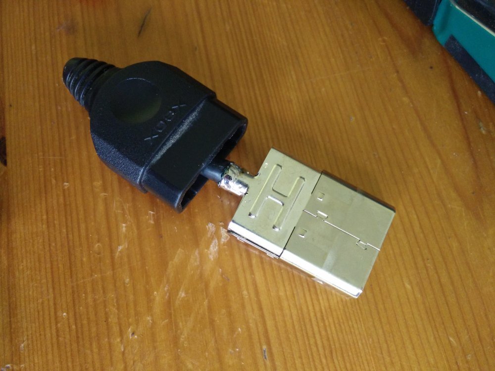

                        @bulkchart32: regarding opening up the console end of the AV connector, the outer shell is a somewhat pliable rubber. The inner metal part of the connector has four small raised tabs (two on top and two on bottom) that fit into 4 small recesses on the inner side of the rubber part of the connector when it is slid overtop. The rubber part is not glued to the metal part. Sliding a THIN AND WIDE metal or plastic tool on both the top and bottom between the rubber and the metal will allow enough separation to pull the two parts gently apart. See the diagram below:
                        _._____._
                        |_._____._|
                        the 4 dots represent the 4 tab locations. Insert a spudger tool, or two butter knives, or some cut pieces of old gift cards, or a few flat toothpicks on each side of the top/bottom, etc in between the metal and the rubber on top and bottom. small screwdrivers will work too, but some people get excited and use them too much as a pry tool and end up damaging their connectors so I don't recommend them. You don't need much force at all. Really just using the tool to provide some separation space and then gently pull apart with your fingers.
                        See the pics for the 4 tabs it will give you an idea how much separation you will need, or how far to insert your choice of tool. The wires are well encased, so you won't risk damaging them unless you are very aggressive with it.
                        Those are not my pictures, credit to a forum on ogxbox.com
                        Good luck,
