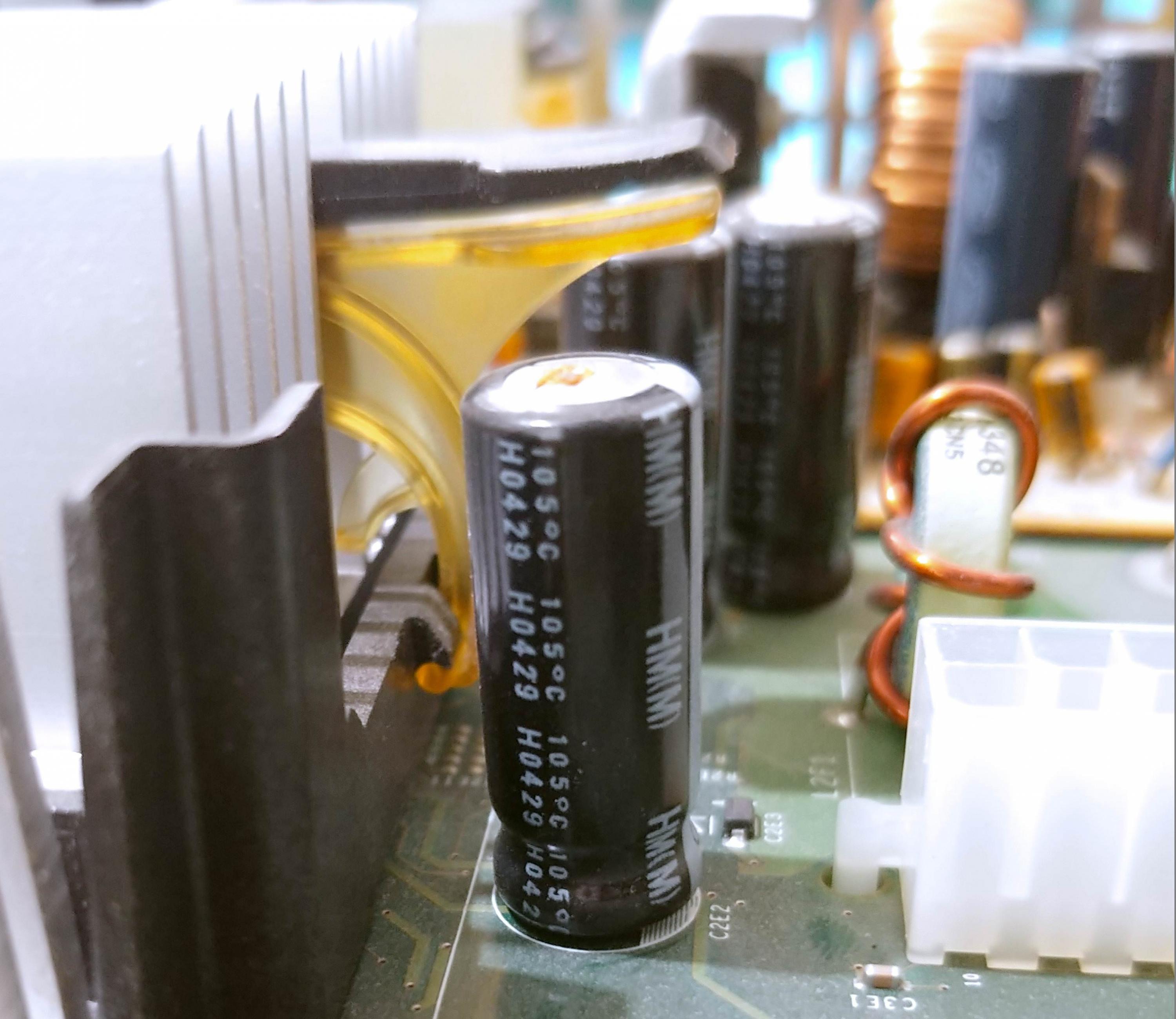

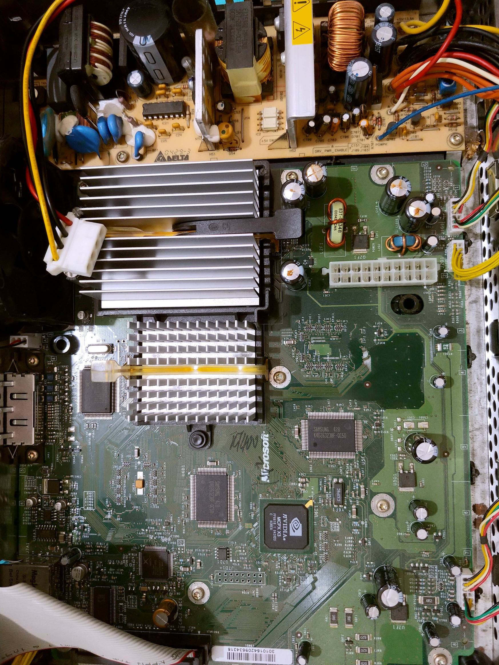

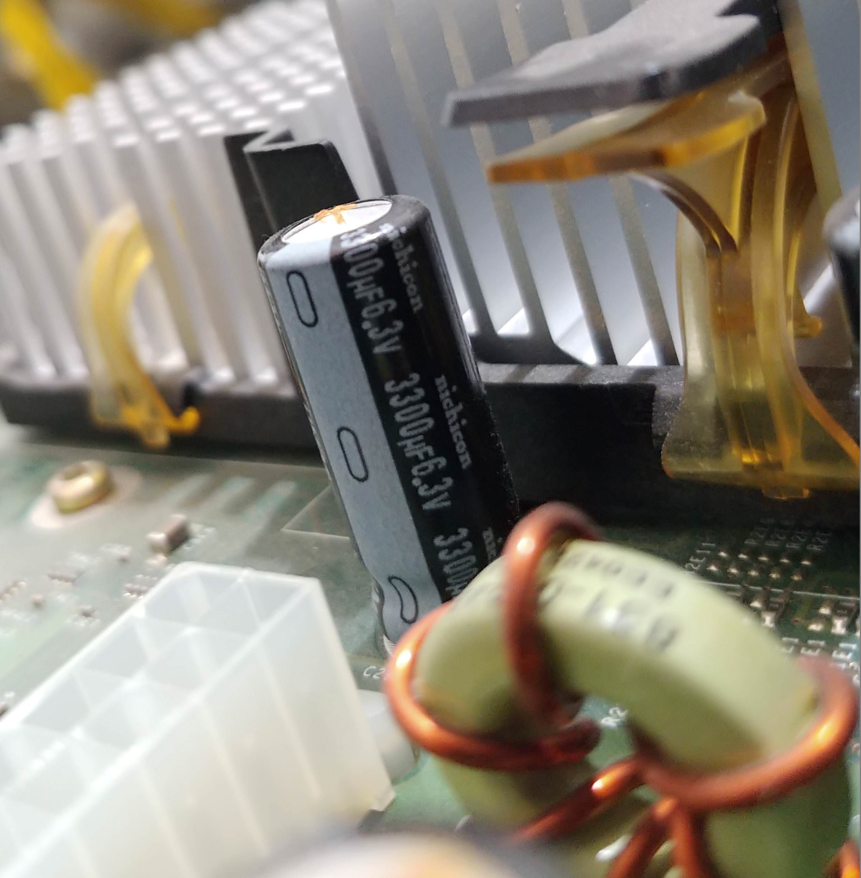

                              I have 5 bad 3300uF caps.
                              Please see the below pictures. You can see the bad caps on the top right part of the main board in the first picture.
                              Can you please advise what can I do?
                              Thanks!
                              My board:
                              One of the caps:
                              Other side of the cap:

                                Re: XBOX Original - Won't power on
                                are they all 3300 / 6.3v?
                                and 10mm diameter?
                                • tudrojopsi
                                  • Nov 2017
                                  • 9
                                  • Israel
                                  #36
                                  and 10mm diameter?
                                  Yes, they are all the same.
                                    • 30944
                                    #37
                                    these around the cpu,
                                    https://uk.rs-online.com/web/p/alumi...itors/8392133/
                                    these for the other 2 if you have 25mm height.
                                    https://uk.rs-online.com/web/p/alumi...itors/7660044/
                                    if you can only fit 20mm then these.
                                    https://uk.rs-online.com/web/p/alumi...itors/1458528/
                                    it's possible you could use the 2000uf polymers to replace all 5, but i'm not sure it's been tried yet.
                                    • Stefan Payne
                                      • 1267
                                      #38
                                      Don't forget to replace the smaller ones in that blown area!
                                        • 30944
                                        #39
                                        btw, keep an eye on the supercap near the ribbon cable - it's gold coloured.
                                        • tudrojopsi
                                          • Nov 2017
                                          • 9
                                          • Israel
                                          #40
                                          @stj & @Stefan Payne thanks very much to both of you.
                                          Sorry to bump this after such a long time, but this website doesn't ship to Israel, and being the procrastinator that I am, I didn't do anything about it in the last 18 months .
                                          I really want to fix it now, though.
                                          Do you have another suggestion for caps that I can order to Israel?
                                          I don't understand what you mean. Can you please explain?
                                          Again, I don't understand what you mean. Can you please explain?
                                          Thanks!
