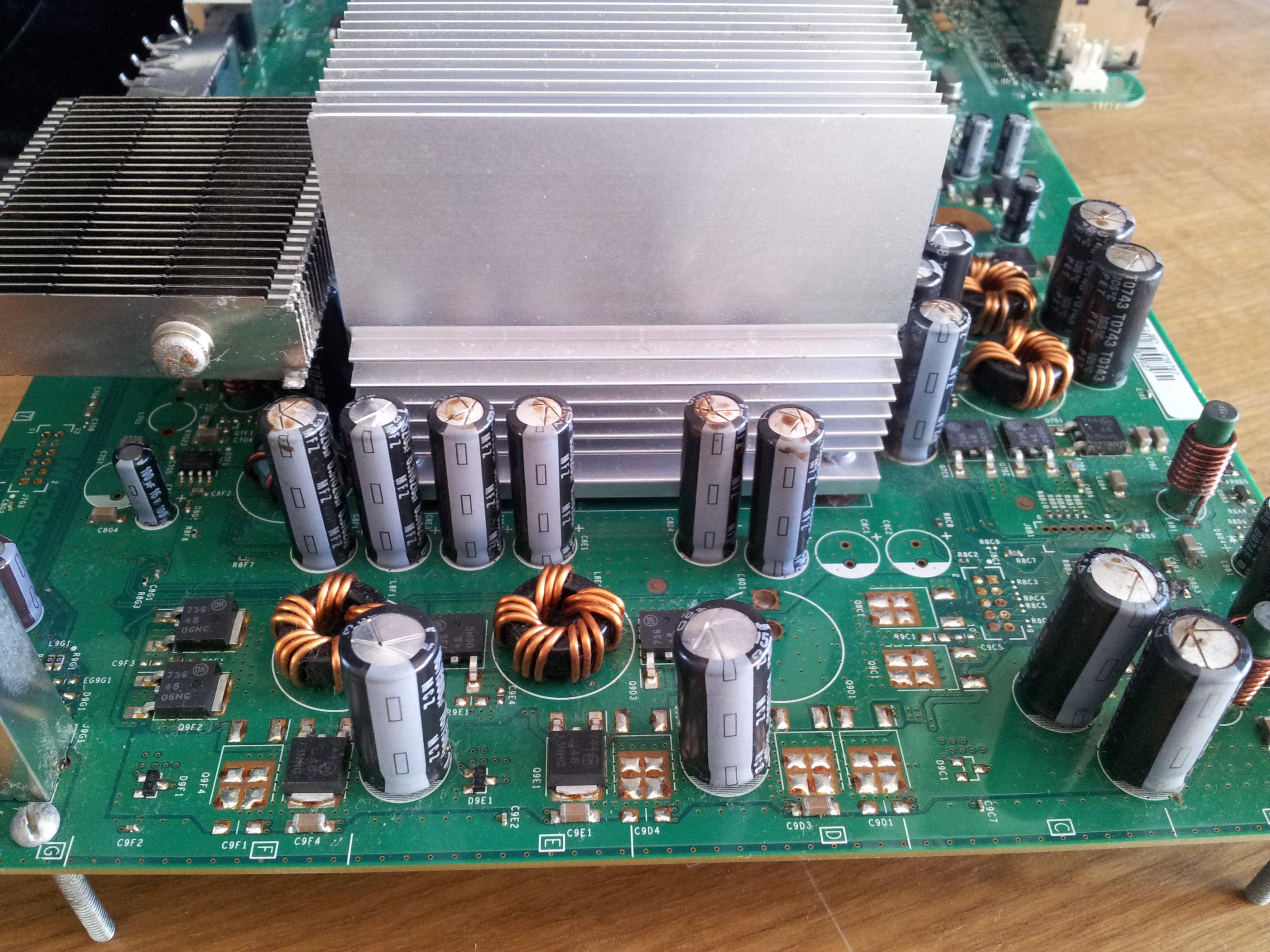

    Been given an Xbox 360 to fix that has blown caps (the big ones near the gpu/cpu heatsinks).
    THERE ARE:
    14 Rubycon 6.3v 820nf mfz 105deg 8mm dia
    9 Rubicon 16v 1500uf mcz 105deg 10mm dia
    Done a bit of reading here and the suggestions have been to replace with Rubycon MCZ, Nichicon HZ or HN but i'm buggered if I can find any.

    Suntan may not be good so I don't suggest you use them.
    You can safely replace the 6.3v 820uf Rubycon MFZ caps with any of the following polymers:
    2.5V 820uF Sanyo SEPC,
    2.5V 820uF United Chemicon PSC,
    2.5V 820uF Nichicon FPCAP R5 and E5 series
    These will also likely work: 2.5V 820uF Nichicon FPCAP R7 series and 2.5V 820uF Fujitsu FPCAP RE series.
    As for the Rubicon 16v 1500uf MCZ, you can use:
    Rubycon MCZ (obviously ), Nichicon HN, Panasonic FL (you won't find them for sale anywhere but if you do find them on a motherboard, they will work), and Sanyo WG. <--- all of these should be the same 16V, 1500uF rating.
    I'm not sure if the Xbox 360 can take polymers in place of those 16v 1500uf caps, but it probably will. If you feel experimental, use 16V 330uF or (preferably) 470uF polymers. United Chemicon PSC, Fujitsu FPCAP RE series, and Nichicon FPCAP R7 series are among some of the choices.

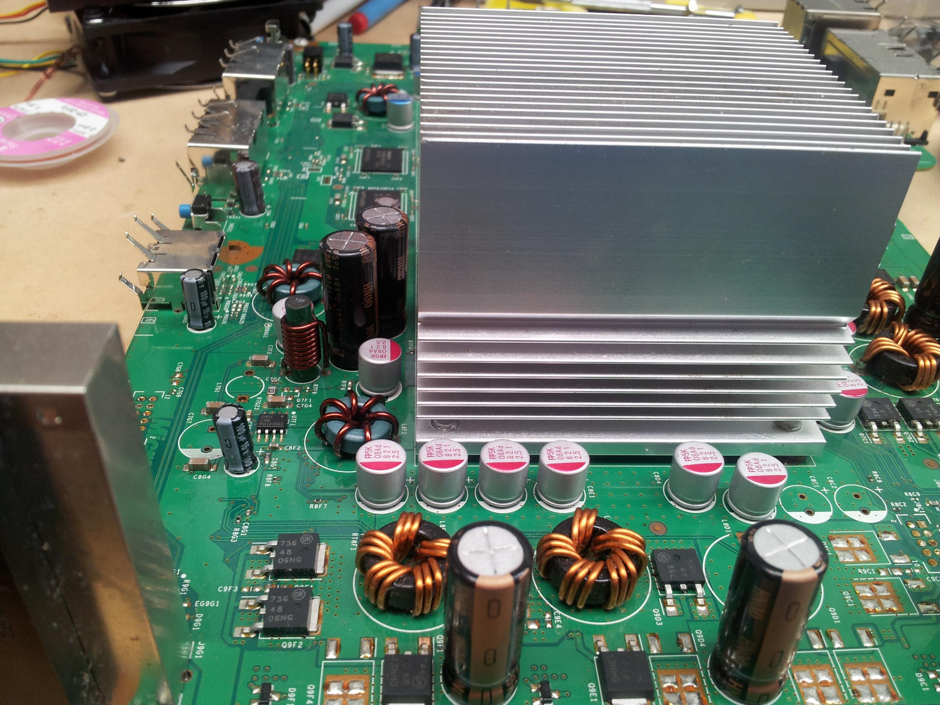

                About to start removing these....
                I'm currently a Part-time Computer Systems Engineering student.
                Full time Service Assurance (faults) for a large Telco.
                  Re: Xbox 360 with blown caps

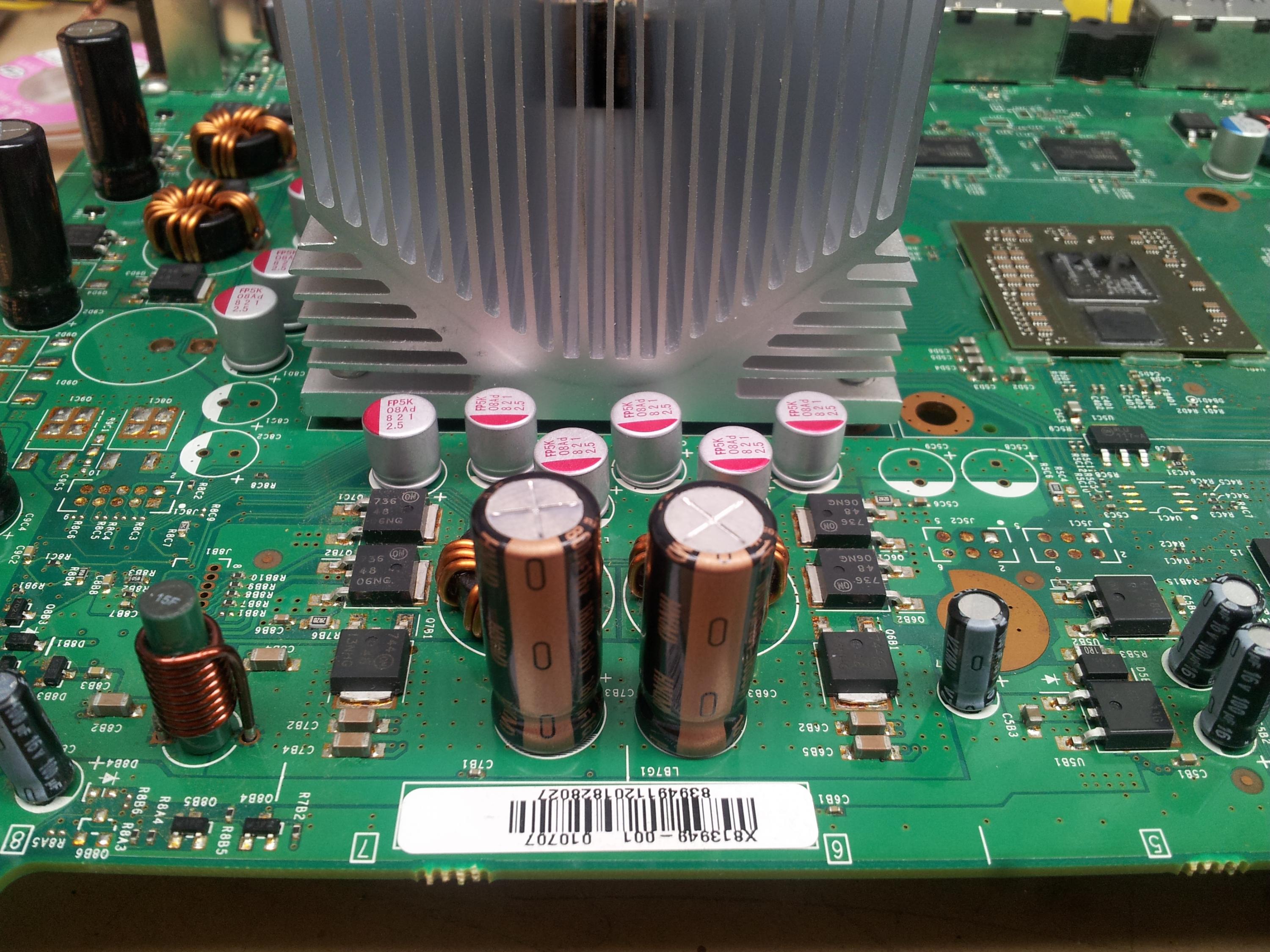

                  You'll need a tough iron for them. 50W or more preferable (or else you'll need to preheat the board well). Make sure to put lots of solder on the tip of the iron and also add some flux to the pins of each cap. This will greatly help with the heat transfer. I've tried many different methods to remove caps from these boards (hot air only, hot air + iron, preheat + iron, Hakko 808 desoldering gun) - none of which worked too well (the Hakko 808 was okay when used as an iron). The best and easiest method really is just with a temperature controlled soldering station with a chisel tip and lots of solder on the tip and fluxed pins on each cap. It's not required to have a soldering station (you can do it with a regular iron too), but it definitely makes the task easier.
                    Yeah thanks thats what I used, Hakko 936 clone at about 420 deg C. some flux and solder to create a larger heat bridge to the board and the leads. Then just ease out one leg at a time.
                    They are all out now.
                    One thing strange i noticed was a few of the leads were loose in the board. Either a bad solder job from the factory or perhaps the joint had become hot and brittle when this thing overheated at some stage.
                    I should get time to put in the new caps later this week.

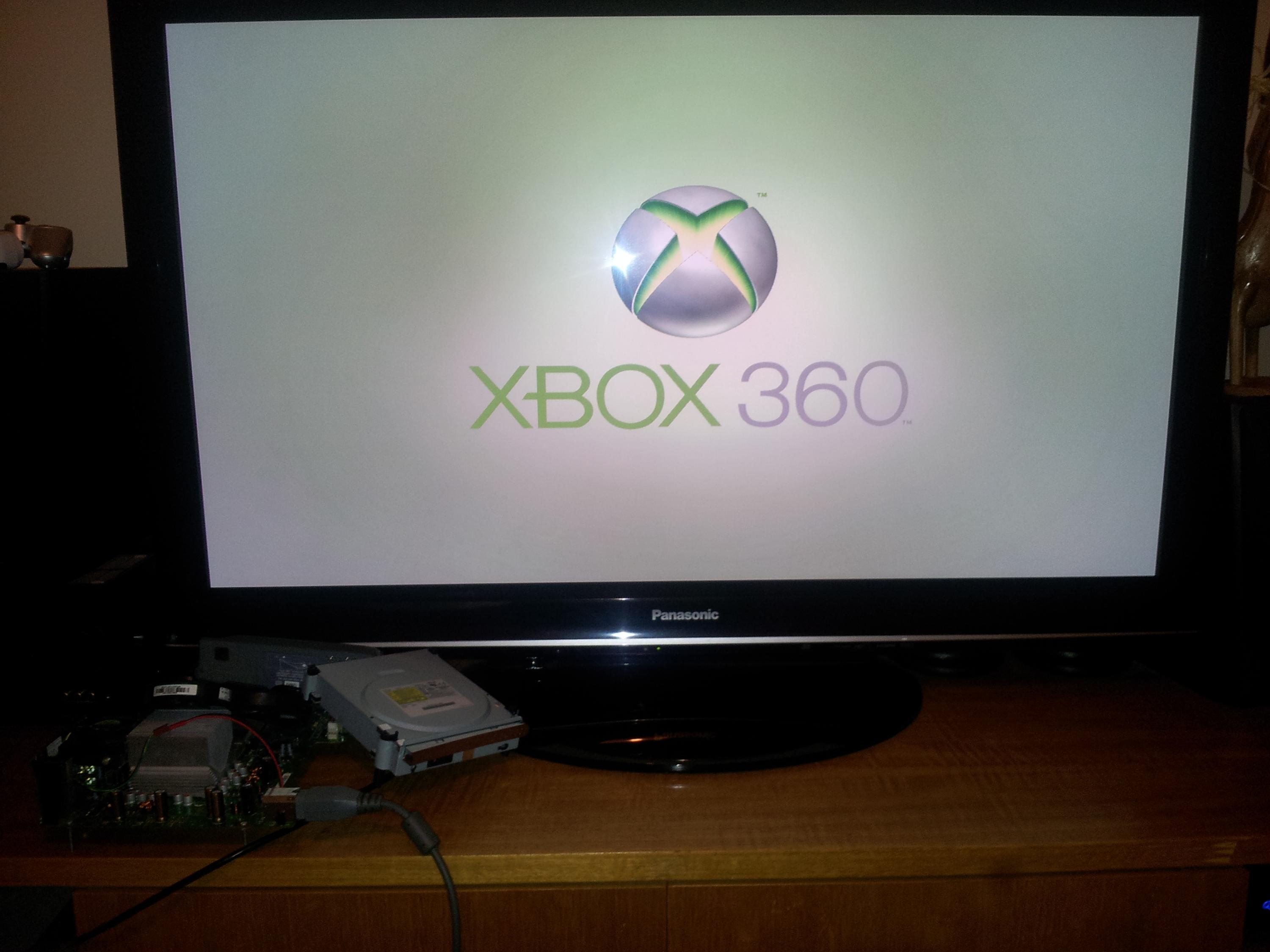

                              Just Had the chance to pop these in.
                              I'll test it out tonight.
                                ......and she lives!

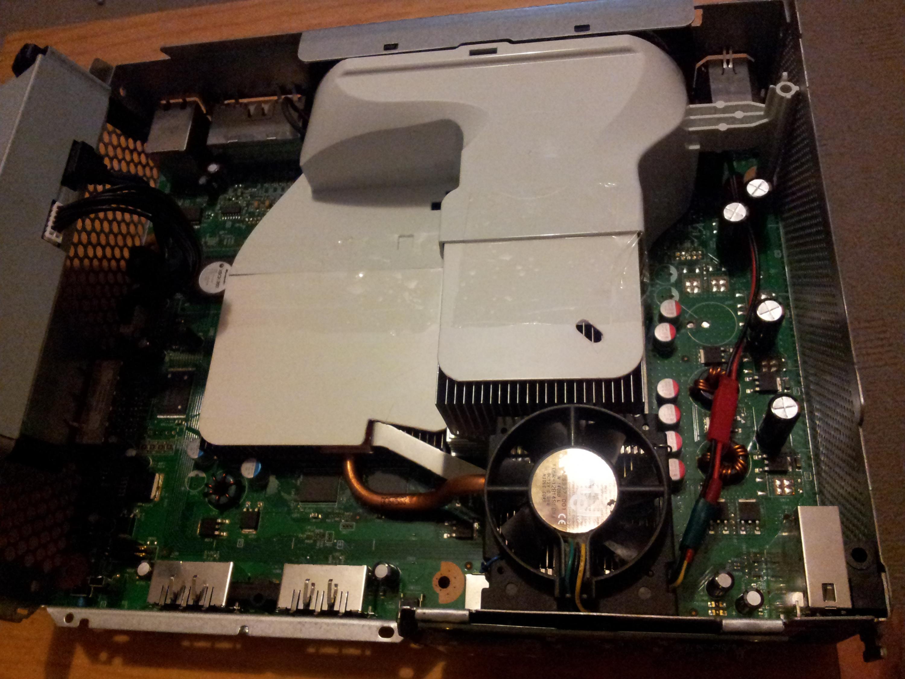

                                    Also made a few cooling mods while I was at it if anyone is interested.
                                    The plastic will help the air to be drawn through the heatsink fins better. Also re-purposed an old P3 CPU fan after giving it bit of a trim and tapping into 12v source just under the main power connector. It sits on top of the extra GPU heatsink on the heatpipe. It also helps to draw in some cool air from the small air vent in that part of the case.
                                    So far so good!

                                      Good.
                                      These Xbox 360s do need some fan mods to help them stay cool. Most of the time, I just modify the fans to run on 9 to 10 V constantly. It makes the Xbox louder, but at least it stays cool.

                                        i`m 100% sure that the motherboard from that xbox has seen the inside of the oven :P
                                        you can see the color of the solder going from orange to brown (:
