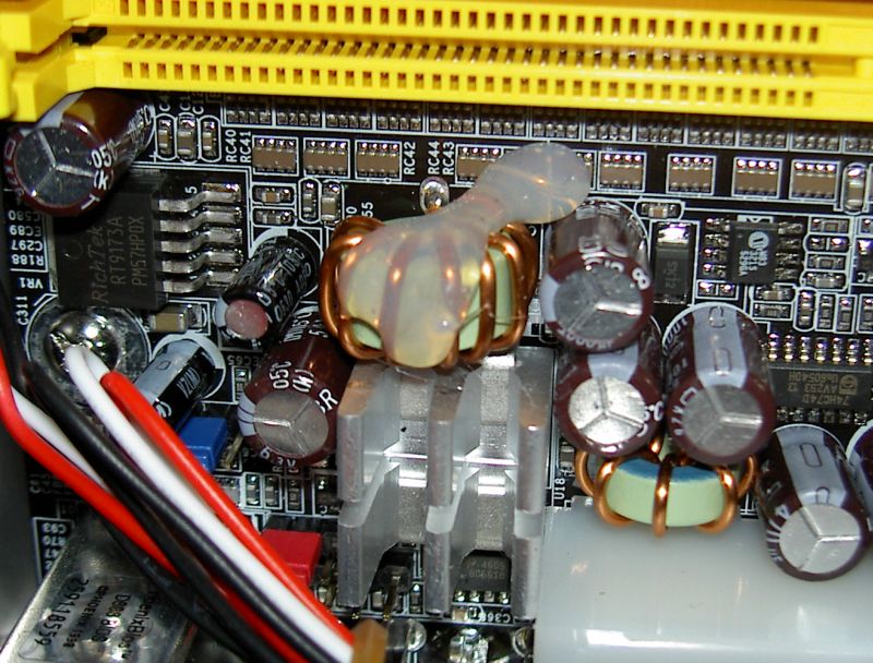

    Re: Epox 9NDA3+ with exsessive coil noise
    That is a coil wrapped in heatshrink tube I think, the heatshrink tube has 125°C written on it so if it indeed had elongated on your PSU I think your caps where in pretty bad shape too :P
    Look in this thread (the linked pictures) to know why it is dead...

      #42
      Trodas: yet another pic, this of my DFI Expert that had coil noise from this coil that I fixed with hot glue...
      Last edited by Per Hansson; 05-11-2014, 07:05 AM. Reason: Offsite images uploaded due to problems with host

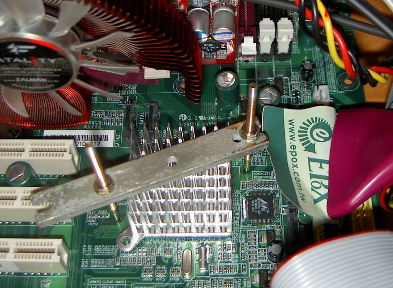

                            #53
                            Originally posted by tiresias
                            Per - sorry to hear that recapping didn't help. I must say though, I'm not entirely surprised - I also had found the "2 DIMM issue" a beastly problem to troubleshoot (as I had mentioned in the 'for sale' thread). At least you seem to be able to reliably reproduce the problem with memtest, which can help in letting you know if any particular "maneuver" happens to fix it.
                            Yea, you know what, it is a bit odd because before I was not able to reproduce the error, it would happen after a while just like for you... But now I fire up memtest and it hardlocks and I get C1 upon reset...
                            If I were to make a suggestion at this point, it would involve trying to assess the state of the BGA connections under the chipset. While it may be coincidence, this annoying problem did start soon after having removed the stock chipset cooler. Epox had used double-sided tape which very strongly adhered to the chip's surface, and although I used great care in removing it, I wonder whether the procedure may somehow have disturbed any (previously already weak or defective) connections under the chip.
                            Perhaps you could check whether pushing on the heatsink a little helps? You could see if freeze-spray exacerbates (or even improves!) the problem...
                            Well, it felt like Murphy was playing me one but after first trying to restart the computer with the C1 error 10 times in a row I took your advice and pressed down on the heatsink; and it booted right up into memtest... I tried it a few times with the same success, of course I was unable to hold an even pressure but it looked like as soon as I removed pressure it would lockup...
                            So I tried to fix it by screwing down the heatsink really hard against the chipset, however this does strangley enough not help at all... Go figure... Strange problem indeed :P
                            Last edited by Per Hansson; 05-11-2014, 07:13 AM. Reason: Offsite images uploaded due to problems with host

                              #54
                              It bends the PCB while pushing the heatsink by hand does not.
                              I have some boards with bad joints under BGA chips. It can be probably fixed by using heatgun - but I don't have any.

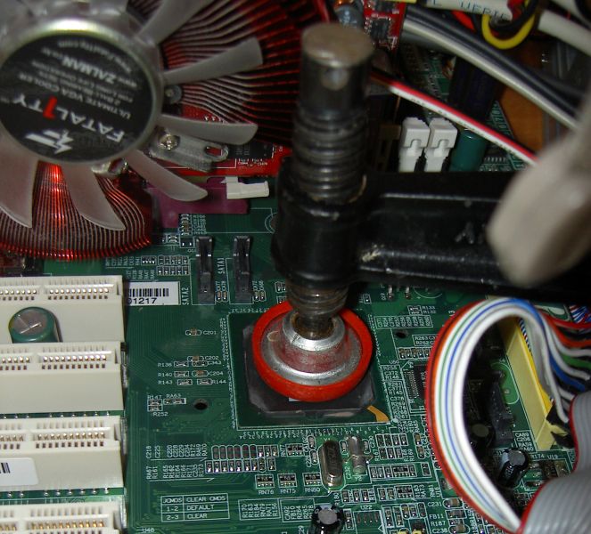

                                #55
                                You where right, after I removed that thing the HSF fell off, I had broken the epoxy or whatever it was that held it in place...
                                However then I got an idea and tried it with a G-Clamp, tightened really hard, C1 memory error...
                                Murphy!!!
                                Last edited by Per Hansson; 05-11-2014, 07:44 AM. Reason: Offsite images uploaded due to problems with host
