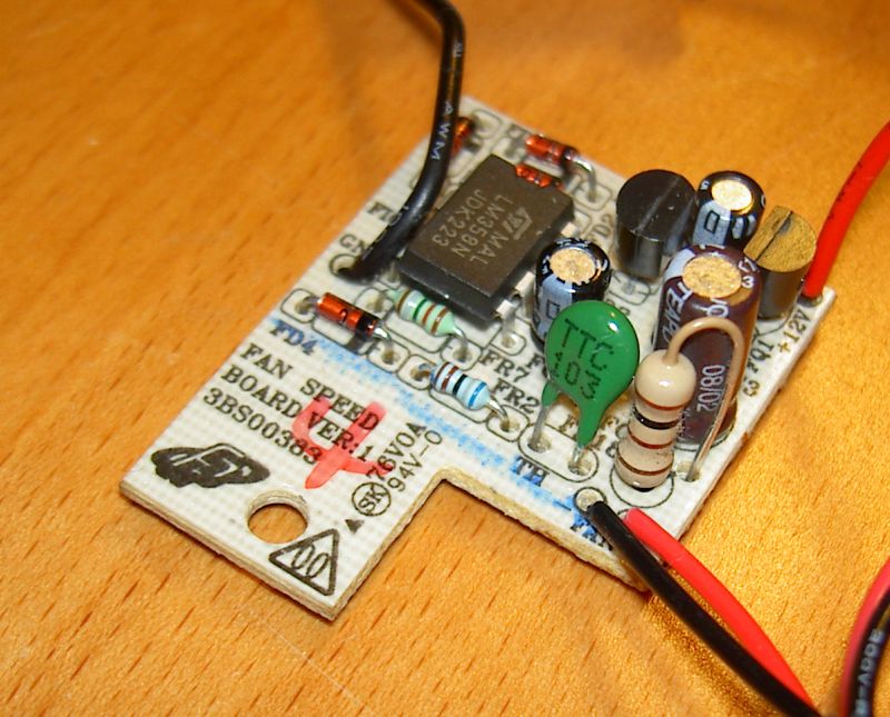

                          Okay todas I was bored so here is your requested reply
                          His very funny Opteron now all off a sudden accepts 2.8ghz at 1.4v, before it did not even post at 2.7ghz 1.55v, go figure, burn in that did it probably...
                          So maybe it will do 3ghz in a few weeks ;-)
                          The silicon does help, it does remove the effect of the torroid core moving in the coil thus creating coilnoise, except on my very strange 9NDA3+, and coil noise is not something that happen with only bad capacitors, it just happens when there is ripple current and a small space for the torroid core to be able to move in phase with the ripple current of the circuit it is on...
                          Picture of a Nexus NX-3000 PSU with lotsa glue in it... Also a very dead PSU ;-)
                          Last edited by Per Hansson; 05-11-2014, 06:56 AM. Reason: Offsite images uploaded due to problems with host

                                  Ahh, very good very good, always nice to have that self destruct button when the RIAA comes to visit
                                  On another note I tried to use the thermal control PCB on it's own but it did not work, the fan ran at one speed only
                                  The thermistor was not on the fancontrollers PCB, but on the main PCB in the PSU, so I moved it to the fancontrollers PCB (the cable from the fancontroller to the main PCB had one unused solder hole next to it so I thought it would work...)
                                  Last edited by Per Hansson; 05-11-2014, 06:58 AM. Reason: Offsite images uploaded due to problems with host

                                        Damn, it just struck me; why the Nexus NX3000 failed... It is because the voltage controller for the fan failed!!!
                                        If you read the thread, (linked above) you can see me saying that the primary side heatsink was over 100°C hot, well, without proper cooling and a high load that is not exactly strange... So the reason it exploded was because the primary side switching transistors got so hot so they made the solder from the collector pin reflow and drip off, not the fact that it was a bad solder joint as I first throught!
                                        So, in hindsight it is very nice to realize that there even is not an RPM sensor cable coming out of the PSU... Leasson learnt; buy a PSU with RPM sensor and hook it up to your mobo and tell it to emegency poweroff if it drops below a certain RPM!!! (Make new post in PSU forum and make that a sticky perhaps?)
