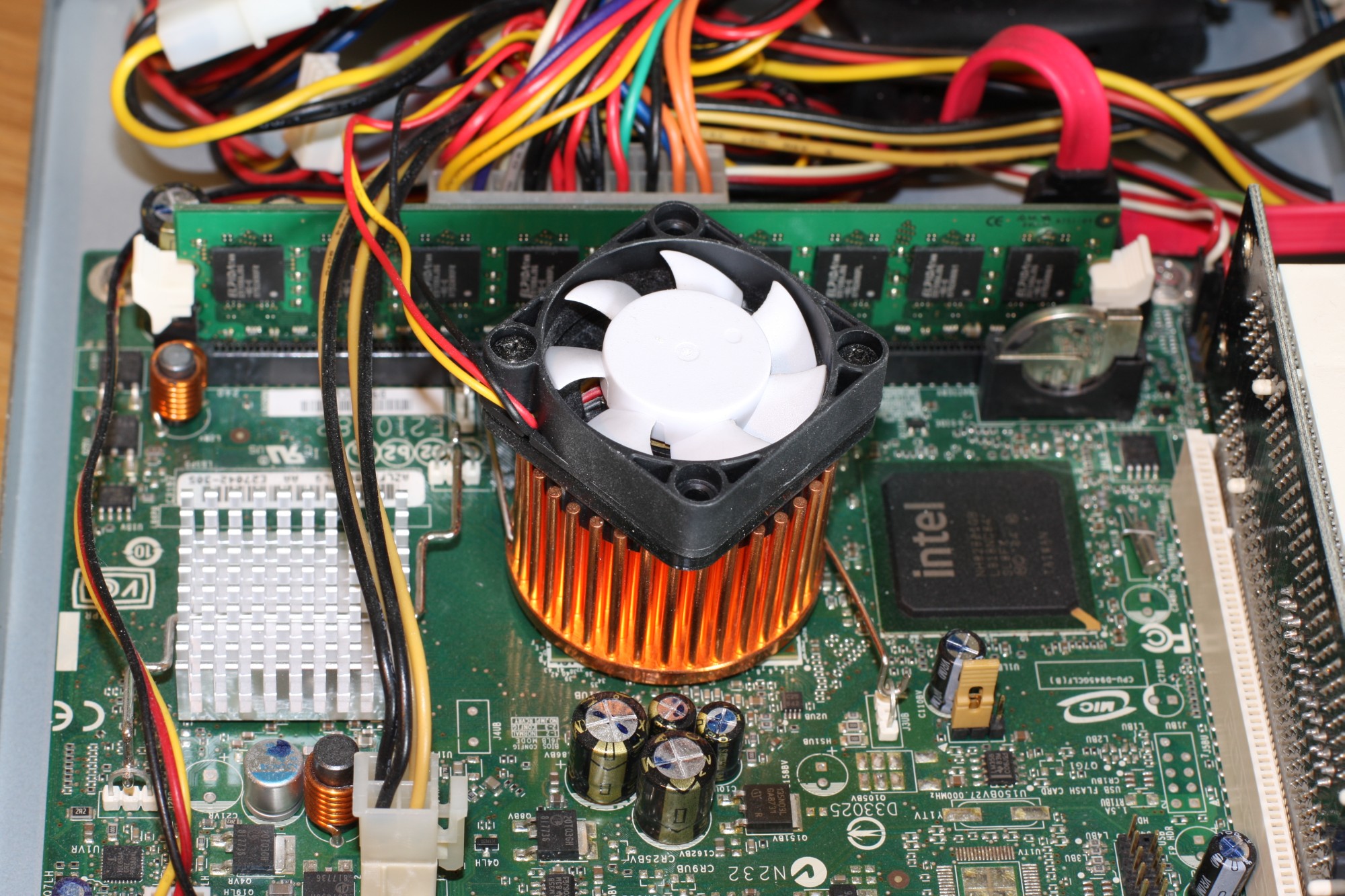

Intel D945GCLF Bloated Samxon GC due to overheating
  • Per Hansson
    • Jul 2005
    • 5895
    • Sweden
    Bought myself a complete ITX system some years ago on eBay, sadly the Socket A Jetway mobo in it died so I replaced it with the cheapest low power ITX board I could find at the time, the Intel D945GCLF mainboard... (Almost 3 years ago now)
    It is a Intel Atom 230 single core 1.6Ghz "beast" which I run IPCOP on.
    You might know that the original fan is really crappy and also not thermally controlled.
    I replaced it with a big copper heatsink hoping I could cool the fantastic Intel 945GC chipset passively.
    Well, about 30mins later the heatsink was over 100°C hot and the system crashed, so I put a fan ontop of it anyway
    Now I want this system to be silent since it is in my bedroom and runs 24/7 so it spins really slowly, still keeps the heatsink quite cool, temp sensor reads ca 40°C
    The CPU on the other hand is passively cooled with a tiny heatsink, it only becomes 50°C
    No wonder when it's rated at just 2W TDP, unlike the chipset which is rated for 22W TDP!
    Now Intel generally gets allot of credit for their designs, but I dunno on this one.
    First the choice of this ancient chipset using 12 times as much power as the CPU.
    Then ontop of that they put 4x electrolytic caps close to it, but the CPU which needs just 2W gets a nice Polymer capacitor? Meh...
    I contacted Big Pope and ordered some Samxon solid polymer caps from him
    Find below a list of the original caps, they where a custom order by Intel, the sizes do not exist in the Samxon catalog...
    Code:
    2x Samxon GC 1000uF 10v 10x12.5mm
    2x Samxon GD 220uF 6.3v 6x12mm
    Replacement capacitors:
    Code:
    2x Samxon X-CON ULR 1000uF 6.3V 8x11.5mm
    2x Samxon X-CON ULR 220uF 16V D6.3x11mm

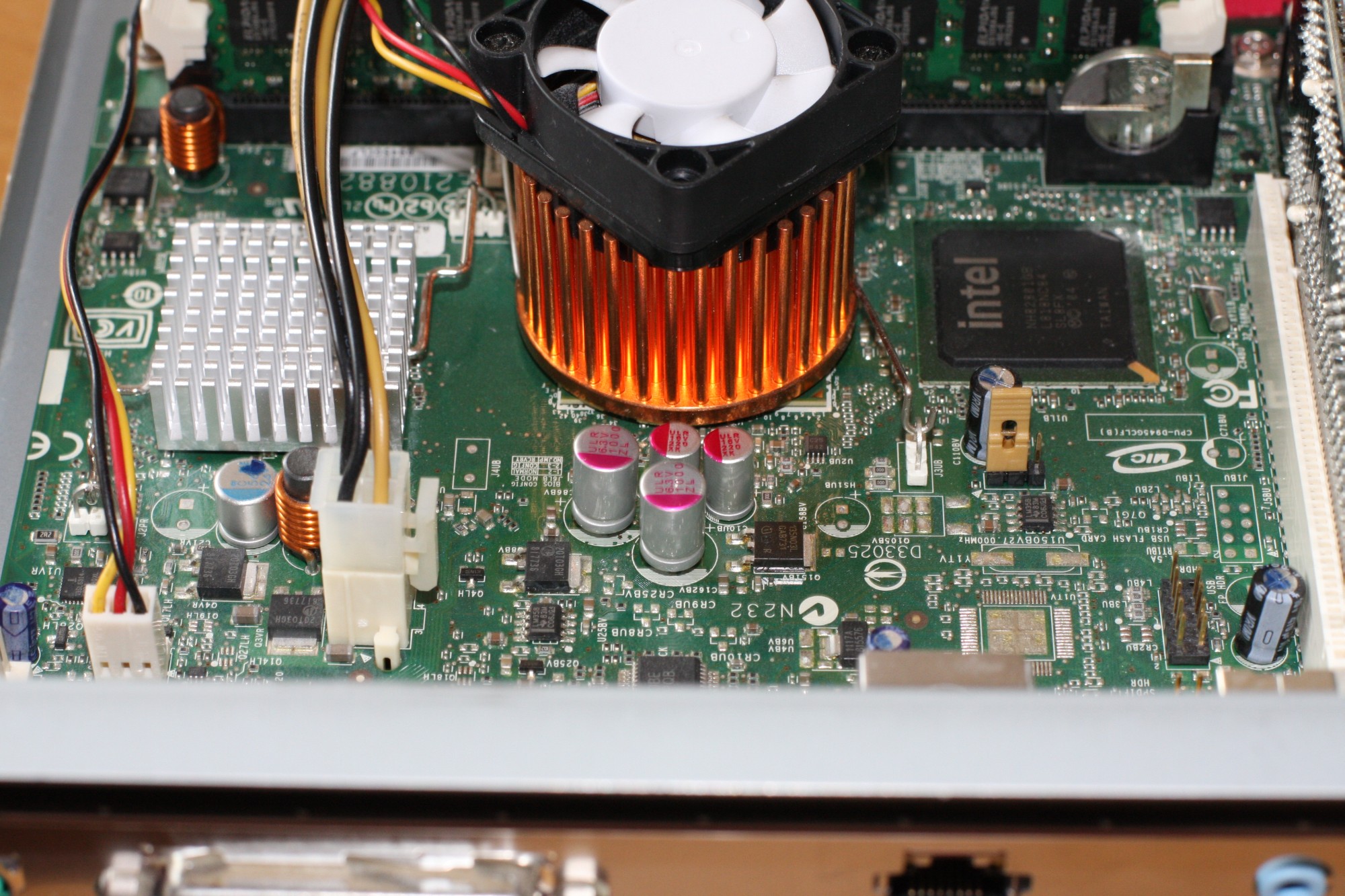

    For information here are voltage readings under the capacitors, incase you have a similar board and would like to change any of the caps to another value. Note that the 220uF caps fit well however I had to bend the legs on the 1000uF because the leg spacing was too narrow...
    (Look at the photos to understand which cap is which)
    Code:
    Front left 1000uF: 1.11v
    Front right 1000uF: 1.57v
    Rear left 220uF: 1.57v
    Rear right 220uF: 2.54v
    The lone original polymer by the CPU sees 1.16v
    The little DC/DC PSU which can be seen in the upper left corner was already recapped by me with Samxons about 2 years ago because the orignal crap caps failed
    Last edited by Per Hansson; 09-17-2015, 09:26 AM. Reason: Added link to relevant older post.

        Re: Intel D945GCLF Bloated Samxon GC due to overheating
        Th3_uN1Qu3; Yea I know, sad really
        I actually contemplated to buy a new ITX mobo based around the Intel NM10 chipset
        However it would be around $70 and I would need to do allot of research to know that my dual PCI riser with the 64bit Intel NIC would work...
        Much easier to just change some caps
        Actually the reason I noticed the failure was that the WLAN card stopped working, bunch of warnings about resets in the /var/log/messages logfile...
            As I wrote in the first post the system has seen 24/7 usage for about 3 years now...
            With capacitors rated for 105°C with a lifetime of 2000h
            The temperature on the PCB where the capacitors are is 65°C (Note the two mosfets besides them...)
            The general rule of thumb says that for every reduction of 10°C in temp the capacitors life doubles, so that turns out to be 32000 hours / 24 = 1333 days / 365 = 3.6 years
            That's close enough since it is now 20°C inside, but yesterday it was 30°C in here
                I've the same board and it won't power up. The two big capacitors 10V, 1000uF are bulged. And one in the top left corner, it's a 6,3V, 3300uF, 10mm x 25mm.
                Because I don't know exactly which caps else are defective, I want to replace all. For the most I found replacements. They are totally 17 pieces:
                2 x 10V, 1000uF, 10mm, 15mm
                1 x 6.3V, 3300uF, 10mm, 25mm
                1 x 6.3V, 820uF, 8mm, 24mm
                5 x 10V, 470uF, 8mm, 12mm
                1 x 25V, 33uF, 5mm, 11mm
                2 x 6.3V, 220uF, 6mm, 12mm
                5 x 25V, 100uF, 6mm, 12mm
                Why you chosen: 6.3V, 1000uF and 16V, 220uF? That's crossed. Is that possible?
                I didn't find the: 6,3V, 220uF on the online store. Which should I choose?
                Thanks for the explanation.
                  I choose the caps I did based on what was available. (It's always fine to increase voltage).
                  As you can see in my first post the 1000uF 10v caps only see ~1.5v so reducing voltage in this case is fine aswell...
                  Interesting that your 3300uF 6.3v Samxon GD cap in the corner has failed too, I have not replaced that on my board...
                  Yea probably if that capacitor has failed too you should replace all caps, because I think then your system has been running too hot...
                  How does the caps in the powersupply look and maybe you should look at improving the airflow aswell?
