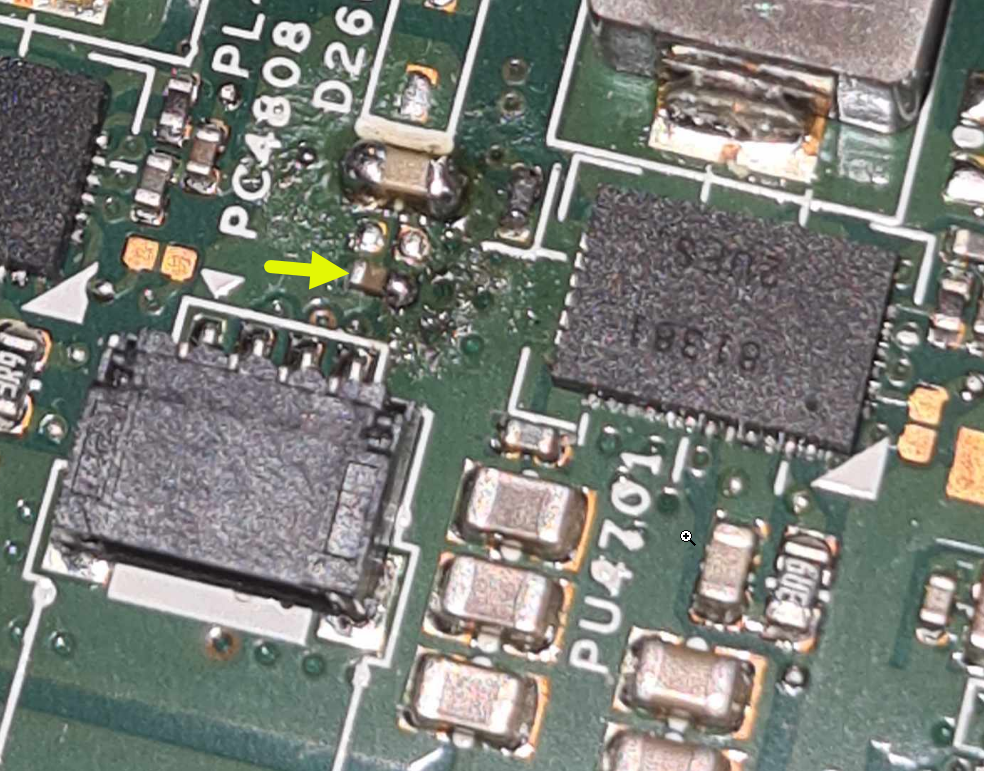

          also found this near to these inductors
          • mon2
            • Dec 2019
            • 14570
            See attached. This area looks like it has been reworked. The part with the yellow arrow is a suspect. Flux and carefully remove this capacitor. Do not lose the part.
            Then check if you still have the very low resistance on the source pins of the mosfets.
