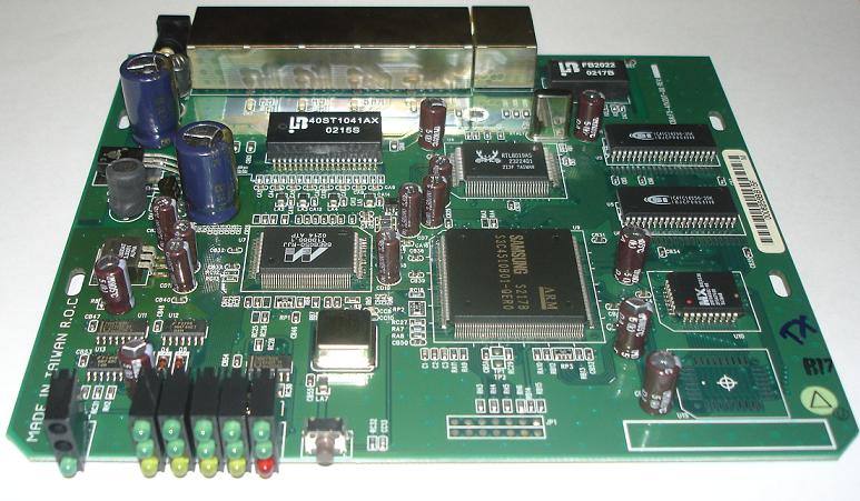

    Well my old reliable Linksys BEFSR41 router just disconnected me again this morning the red diag light was on and as usual when this happens I just unplug it and reconnect it and I'm good to go for some undetermined amount of time until it does this again.
    It could be a week 2 or a month I don't keep track.
    However recently I assembled my new shiny Blue Anatek / Bob Parker ESR meter (I will have a full review in the test equipment section next week boy was assembly and problems that weren't there caused by the "diagnosis function" time consuming).
    Anyhow so I open the case to open it is easy there are no screws simply grasp one of the blue legs and one of the black ones and pull apart real hard and the front of the case will release from the back.
    Remove the single screw securing the board to the bottom casing and push the board back to disengage it from the 4 retainer tabs.
    The D-Paston caps inside all looked fine with no bulging.
    So I get my ESR meter out and measure the low value 10uf 16V caps and this is what I find.
    There are 15 10uf 16V in all I only listed the ones with ESR greater than 3.0 ohms.
    70 ohms
    24 Ohms
    15 Ohms
    12 Ohms
    11 Ohms
    8.0 Ohms
    8.0 Ohms
    5.6 Ohms
    5.3 Ohms
    These measurements were made out of circuit after they were red flagged when I measured them in circuit.
    No thats not a mistype one was actually 70 ohms.
    I replaced all of these with General Purpose 105 C Chemicon KMGs.
    The 2 1000uf 16 Volt filter caps measured as follows:
    .14
    .32
    I don't think that they were a real problem but since they were an unknown (D-Paston) I replaced them too.
    I used low ESR Panasonic FCs since those caps were part of the filter network and I upgraded the working voltage to 25V for a little more "elbow room" especially since the wall wart linear adapter isn't regulated.
    This is the very reason why I don't believe that caps under "insert value here uf" usually don't give you any trouble and you can leave them alone.
    The faulty caps on this board looked just fine to the eye but one of those "ok" caps had an ESR of 70 ohms .
    I say let your ESR meter be the judge.
    Here is a pic of the finished board I had to mix 63 volt 10 ufs with 100V 10 ufs (thats why they are different sizes) because I was running out of Chemicons at 10uf I have to reorder .
    I must say it felt wierd not having Internet access while recapping I wanted to check out D-Paston but I couldn't it also reminded me not to screw up .

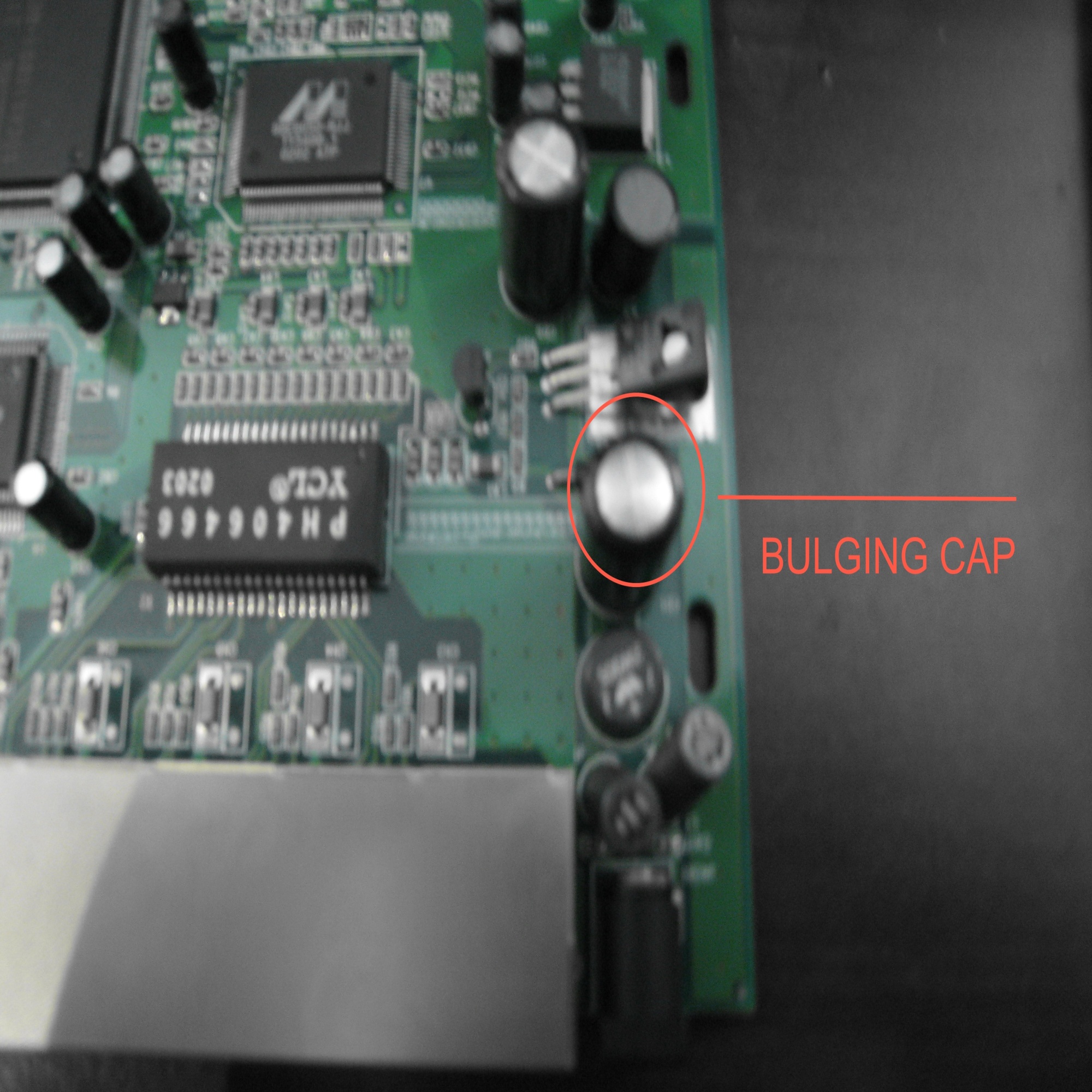

                    HI All,
                    I have dissembled my Linksys BEFSR41v2 to find the same D-Paston caps installed.. Currently when I plug in this router it does not leave diagnostic mode. When you get close to it you can hear a low audible electrical buzz. After inspecting the board I could only visually see 1 bulging on top - D-Paston cap located closest to the power jack.
                    I was planning on replacing the D-Paston caps but I thought of posting here first to get a second opinion.
                    Could the electrical buzz sound be a sign of more serious problems? Should I go ahead and replace the caps and see if it works out? Any other part causing this?
                    Attached is a picture of the bulging cap from above..

                      Re: Linksys BEFSR41 Router Capacitor Solution
                      well don't know the caps but probably crap
                      I would replace those 2 caps pictured and possibly any others around the size
                      (with vents)
                      the smaller ones are normally not to much to worry about even if crap.
                      at a guess I say the bulging is your problem and provided it hasn't caused any other damage it should be OK.
                      From what I can tell it looks like the plug pack is AC (secondary) and there is a bridge rectifier on the PCB
                      That popped cap is the Filter cap for the Bridge rec ...so thats probably the buzzing you can hear is the mains frequency.
                      It appears to be a linear supply so no need to get super low ESR type caps but make sure it a quality brand cap
                      not sure off hand which series would be best suited to this
                      panasonic FC or ruby ZL (probably a little over the top)
                      but should work no worries.
                      what you get may depend a little on whats available to you in your area
                      most Internet places etc ship but the cost will be more then the caps.
                      If what I suspect above is wrong and it is a switcher of some kind (doubt it)
                      that series would most likely be OK anyway.
                      photo is a bit blurred so cant read any details
                      chances are thought replace that cap and it will work ok
                      if you got a General purpose type cap of that value or a little bigger same voltage you can use that for a test.
                      Then do a proper repair once you know its working.
                      you will of course need to know how to remove a cap and solder.
                      if not check FAQ section and practice on junk pcb before hand.
                      lastly these types of caps are polarized so make sure positive goes to positive or you can kiss the cap goodbye.
                      HTH

                        • kc8adu
                          • Nov 2003
                          • 8832
                          • U.S.A!
                          that one is after the bridge and is likely the problem.
                          dpaston is a known crapcap.
