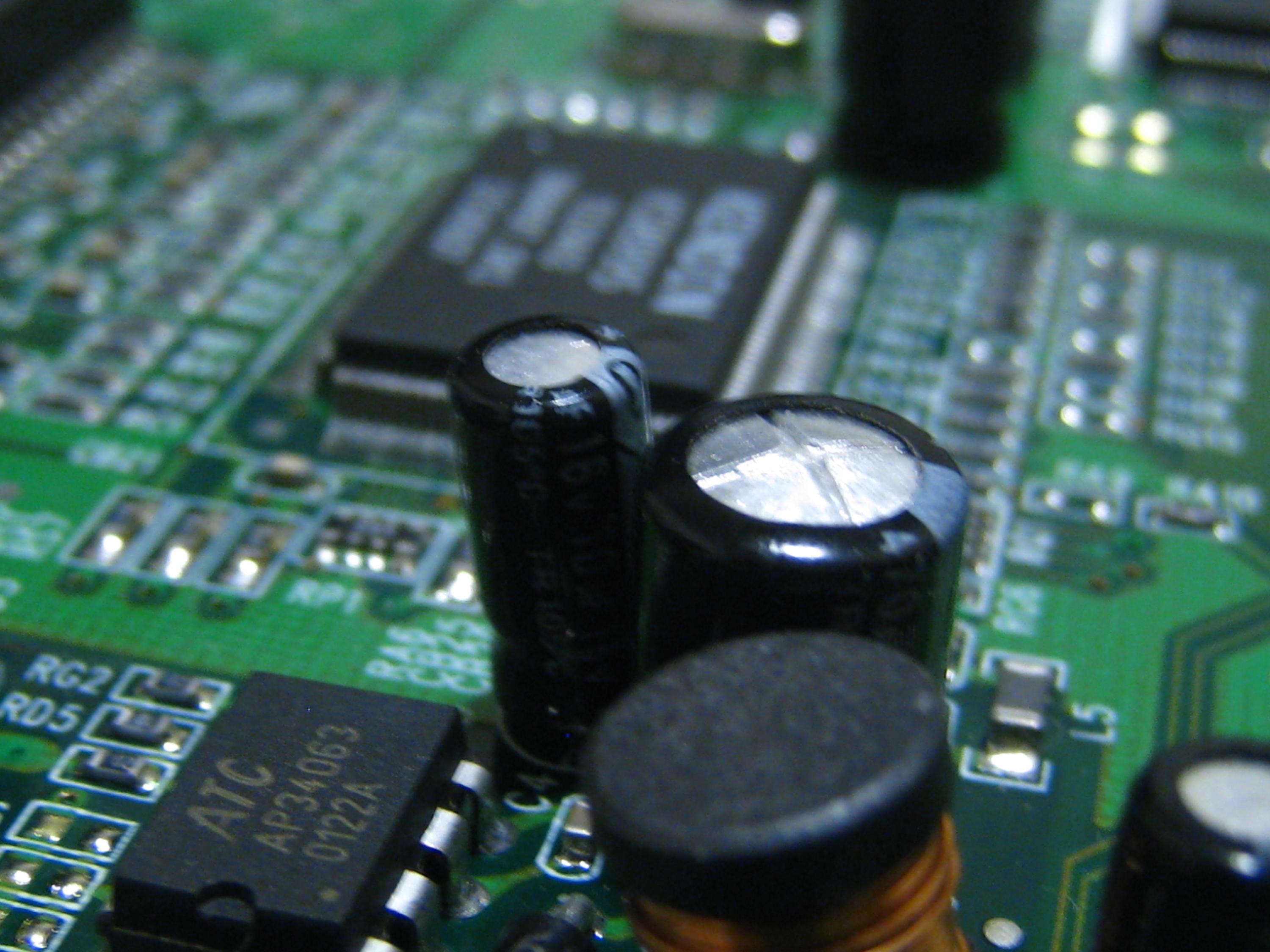

                                        #59
                                        Re: Linksys BEFSR41 Router Capacitor Solution
                                        I dissembled my working linksys that I Recapped awhile back to take quick look.. 1 more cap looks like it needs to be done.. CD7 is fine.. CD6 looks bulged.. Both are 16V 470uF.. Can I replace these with Nichichon VZ(M) Series?
                                        • Yatti420

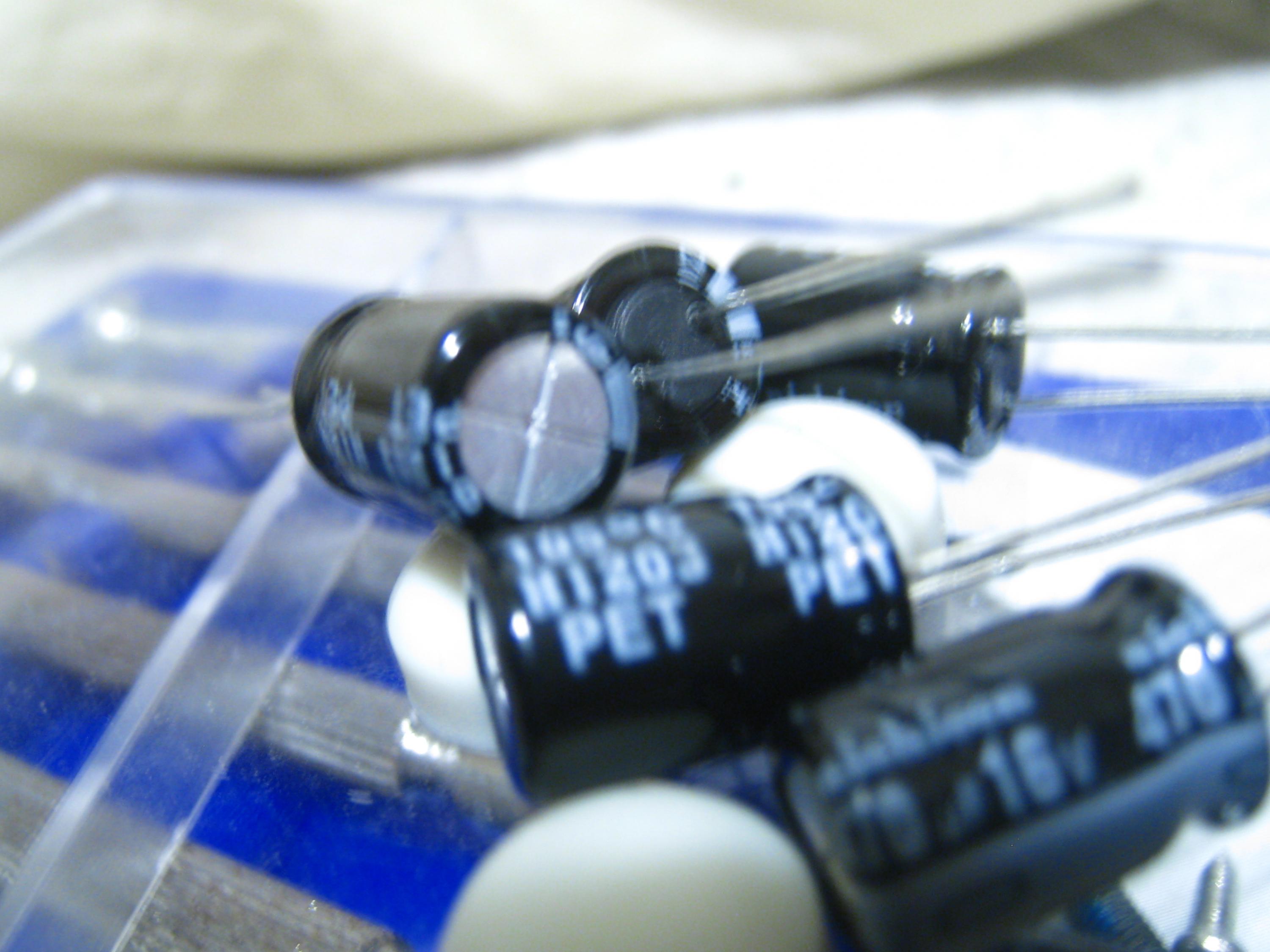

                                          • Mar 2008
                                          • 130

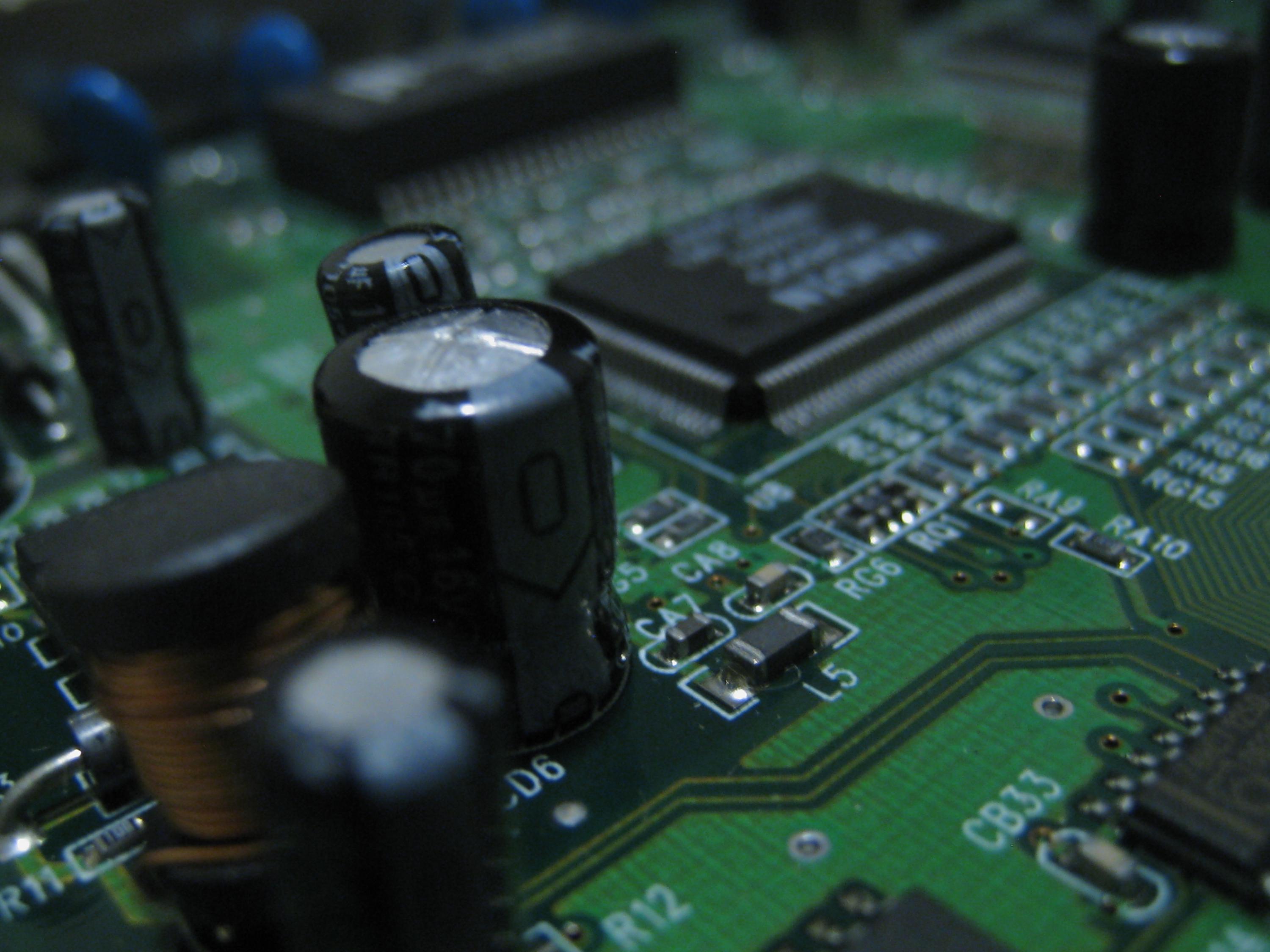

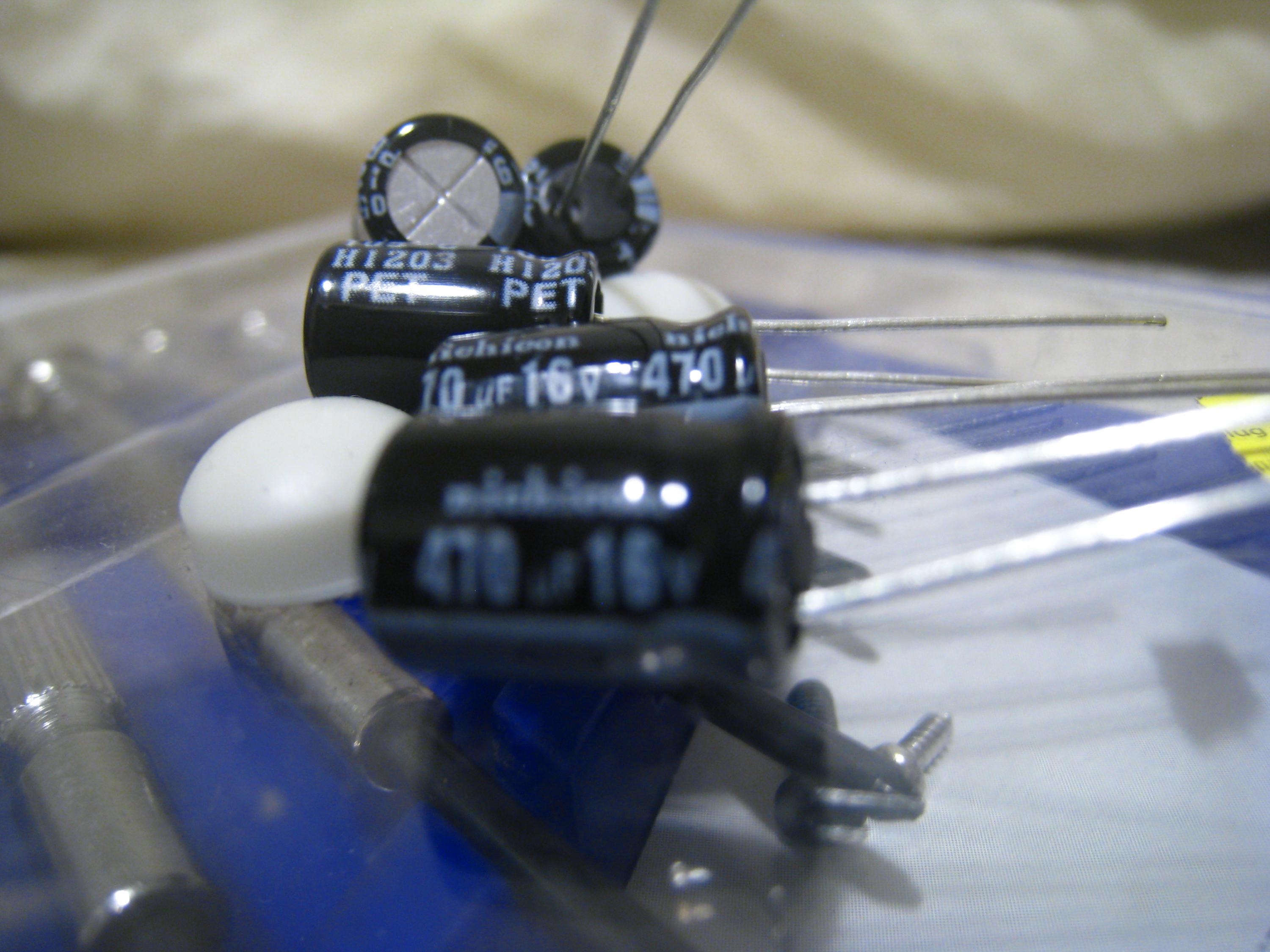

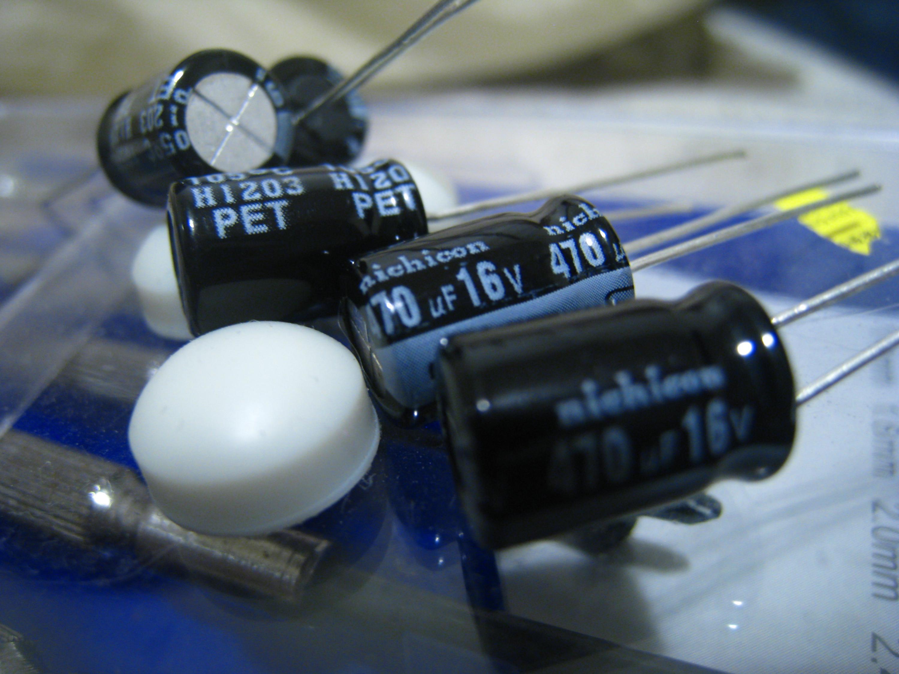

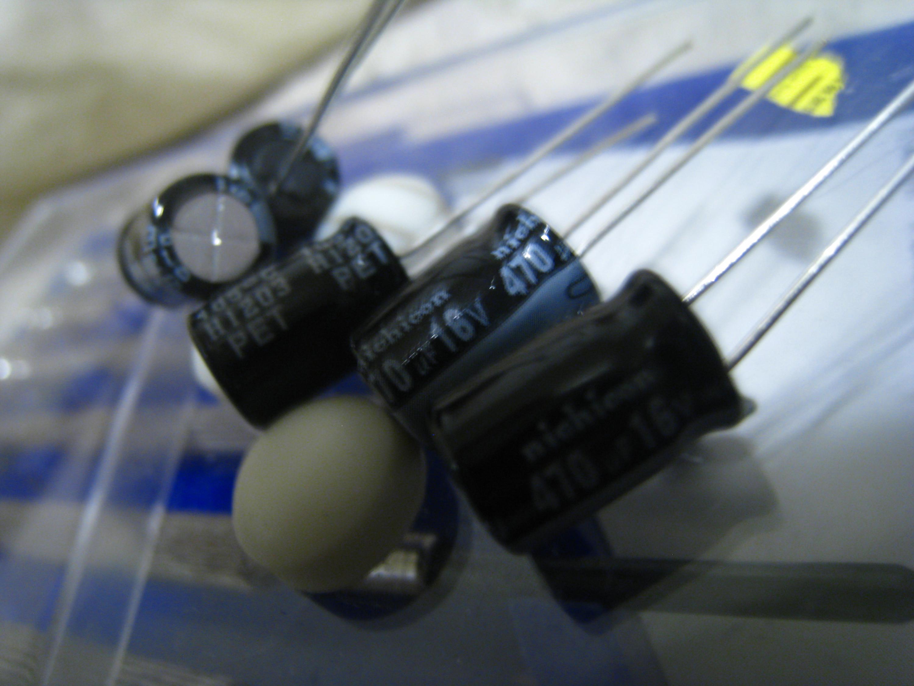

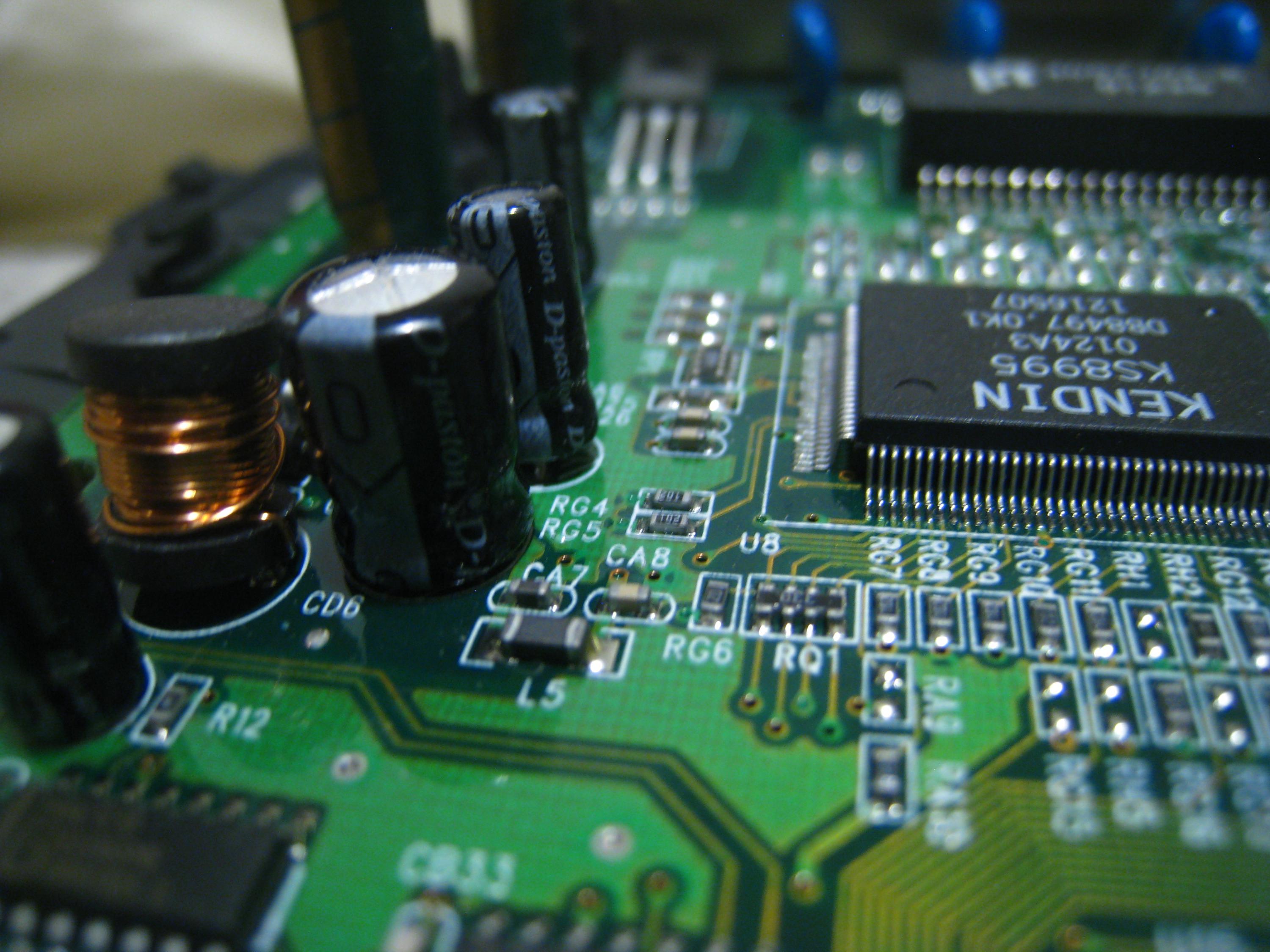

                                          #60
                                          Bump.. CD6/CD7 both D-Paston 16V 470uF.. The remaining 11 D-paston are 16v 10uF..
                                          I was thinking VZ(M) series on the 16V 470uF.. Direct replacements.. They are ebay sourced however .. I need to get pictures up as they look counterfeit.. In the meantime does anybody have high quality recommendations? For CD6/CD7?
                                          Edit: CD6 Pics Included.. You can see the other CD7 16V 470uF which looks fine.. Going to do them both if I have a suitable replacement with the VZ..
