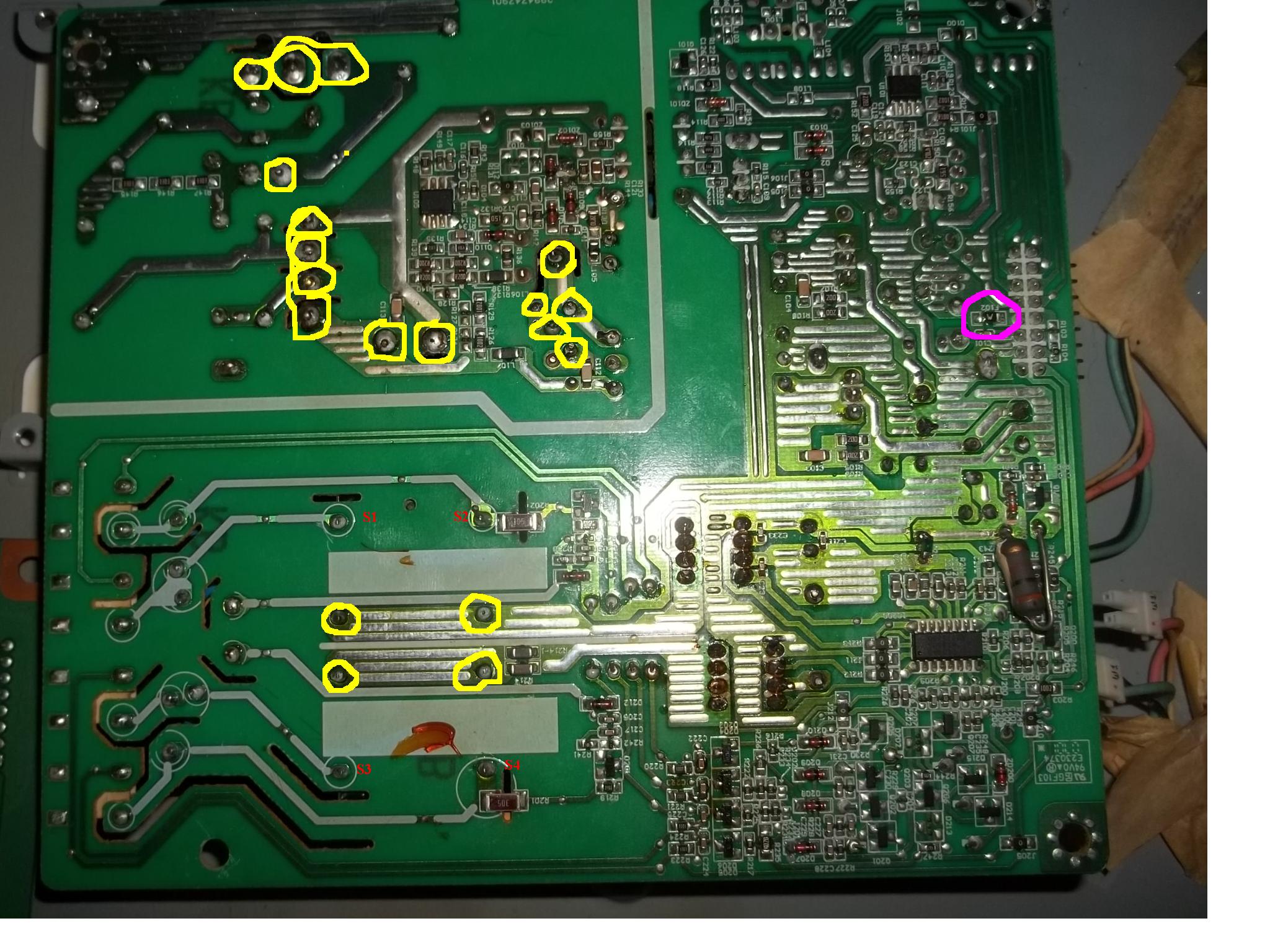

    Ok I have marked a number of things on the board that may help.
    1 The yellow ringed joints "look" a bit odd (it may just be the light or the picture - they often lie) Can you check with a magnifier and if they look bad to you resolder them.
    Recommend adding a bit of new solder removing it all and resoldering.
    2 I have marked in magenta? a fuse Can you test it.
    There may be more but my eyes are tired.
    3 S1 -4 are I think the secondary windings on the Inverter transformer. Power OFF - meter on ohms 2000 - test S1>S2 and S3>S4 and post the results.

      1) that was one of the first things that I resoldered (everything that you circled in yellow). You're right - photos lie.
      2) F102 is good.
      3) S1 --> S2 = .748, S3 --> S4 = .746. So, that means 748 Ohms and 746 Ohms, respectively.

        Oh, F200 is good, also.

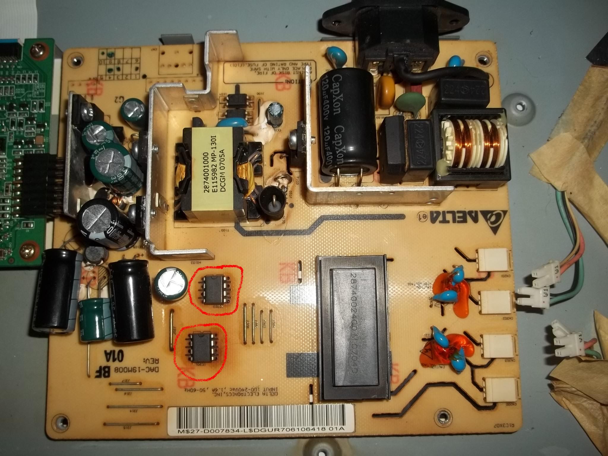

          OK, your problem is almost certainly in the inverter section. The inverter transformer looks good because the 748 ohms and 746 ohms are within 3% of each other. I think I remember this board from one I fixed awhile back. Turned out to be one of the inverter IC's. I replaced them both at that point. You need to check those. They do look very well used, and possibly used up. Circled in red. Good luck.
          *EDIT* Hold your horses. Reading back at the beginning of the thread it appears that OZ9910GN was the culprit. I'd start from the beginning of the thread and run those same tests.
              I thought that I'd posted that I'd replaced both of those Mosfets, but I don't recall off the top of my head. Anyway, they were definitely bad. Once I replaced them, it fired right up. Then, died again shortly thereafter.
              If I unplug one or another of the CCFLs it fires up, albeit briefly.
              I'll go over the thread again to see if I notice anything.

                IC200
                Pin 8, 3.27VDC @ power on, .03 VDC on standby
                Pin 12, 5.05VDC power on, .05 VDC on standby
                Pin 13, ~18 VDC in either state.

                  Eventhough you replaced the mosfets, do a quick to verify they're still good.

                    If I've done this correctly (verified high resistance (VERY high resistance)) then they're still okay.
