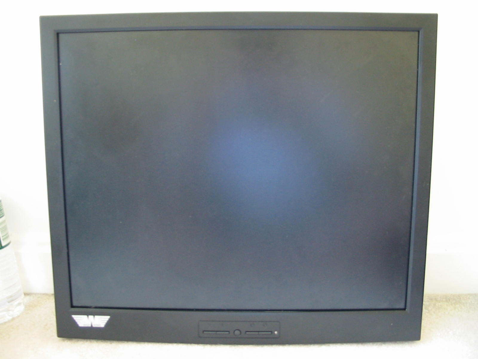

    I'm dedicating this thread to one of the very first LCD monitors I repaired (if not the first one), which was more than 10 years ago now. The monitor is a Wise Wing, model F199. It's a 19” CFL-backlit LCD. I got it for free off of Craigslist in 2009 from a guy, who said he bought it for cheap from Wallmart and the monitor worked only for a little less than 2 years before quitting.
    When I saw the Craigslist post, I wasn't sure if the issue would be bad caps or not. Although I knew what they were and how to identify them, I was fairly new to BCN and recapping back then (started my electronics and PC repair journey around 2007-2008 or so.) But a 19” LCD back then was still considered decent for desktop use. And if nothing else, it seemed worth a shot at repairing, even if just for learning purposes.
    So I got the monitor (and it seemed no one else was interested in it anyways.) This was it:
    A classic “square” 5:4 ratio monitor. No stand was included (original owner had it on a custom mount, IIRC.)
    I tested the monitor as-is first, and it just made a terrible high-pitched squealing noise. LED on front did not light up. So I tore it open (though, it looked like the original owner might have done that too before me, because there were some marks on the case possibly from tampering.)

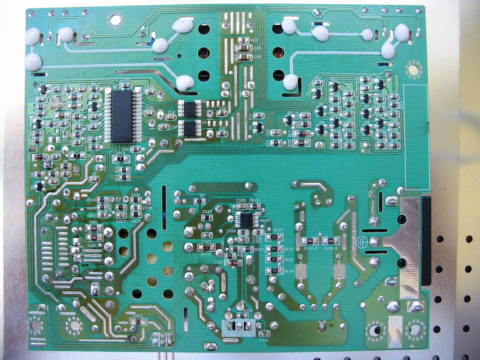

    Unfortunately, I forgot to snap pictures of the monitor boards as I found it (I didn't document repairs as thoroughly as I do now.) But the power+inverter board in this monitor is an FPS035-1Pi01ZT, which seems to be a pretty popular board for bad caps. And of course, the issue on mine did turn out to be bad caps: 3x CapXon KF, 16V, 470 uF, 10 mm dia. and 1x CapXon KF, 16, 470(?) uF, 8 mm dia. - all obviously bulged. I replaced them with 3x Panasonic FM, 16V, 470 uF 10 mm dia. and 1x 16V, 470 uF, 8 mm dia.
    Here is a bottom (solder) side picture, just for component references possibly:
    After this, I reinstalled back the PSU board, put on safety glasses, and plugged the monitor in the wall, half-expecting something to blow, as I had never done a recap before this (remember, this was me 10+ years ago .) Unsurprisingly, though, nothing blew up. Instead the monitor powered up and normally and displayed the usual message about lack of signal.

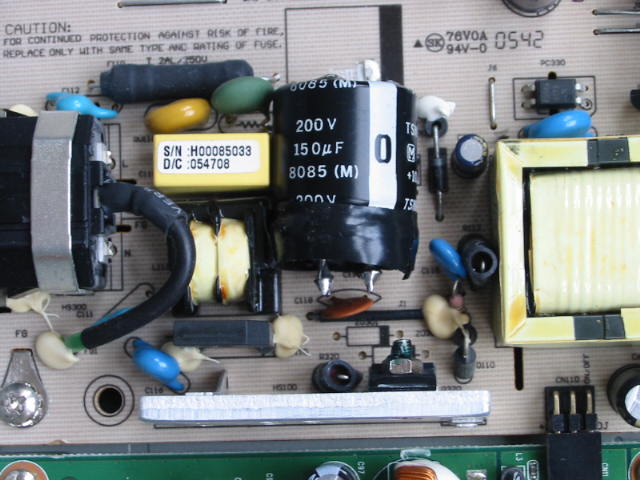

    The monitor worked nice and dandy until I came to do some SW upgrading and maintenance on their desktop one day. As I was using the PC, I noticed there were wavy diagonal lines running across the screen. Reading through posts on BCN suggested this may be a mains cap issue. After all, I didn't change the original primary cap, which was a CapXon KM. And with the PSU still running very hot (despite my attempt at improving the cooling), it didn't go past me that the main cap could be bad. So I tore up the monitor and found this:
    Ah crud!
    Desoldered to take a close look and test:
    Surprisingly, though, that primary CapXon cap still measured fine on my cap meter.
    But then I let it cool down a little. Although still in spec, the ESR did increase slightly:

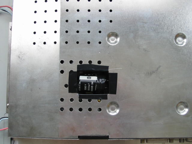

    Unfortunately, I didn't have any 400V caps in stock to replace the CapXon. But there was no way I would put that cruddy CapXon cap back in there. Then it dawned on me : I live in a country with 120V AC line, so I don't technically need to use a 400V. A 200V cap would work just as well, provided I never move this monitor overseas or somewhere with 220/230/240V AC. With that in mind, I took a look through my junk bins, and found this good old Panasonic TSNH cap, rated for 200V and 150 uF.
    https://www.badcaps.net/forum/attach...1&d=1598288510
    And it's still in spec , despite coming from a dumpster-picked early 90's Panasonic TV that was smashed to pieces. I suppose it's never a bad idea to collect PCB boards from old CRT TVs - they always have a ton of useful components.
    Getting the cap soldered to the PSU board was not the hardest part.
    However, putting the metal PSU cover back on the monitor wasn't quite so possible, because the “new” Panasonic primary cap could not fit in any direction without getting in the way of the metal PSU cover. Seeing that I already had drilled ugly holes through the cover, I figured why not take it all the way.
    And while at it, I also widened the holes on the bottom part of the metal case for even more cooling.
    Then I slapped it back together and tested. However, it turned out the wavy diagonal shadow noise on the picture perhaps wasn't caused by the main cap after all, because it was present even with the new primary cap. To isolate the issue further, I tested with another monitor and saw the same wavy shadows. I know the VGA cable (yes, I'm still using analog cables ) is not a cheapo, as it came with the original Dell 17” monitor. So the noise is likely originating from somewhere else (possibly even the PC itself.) Of course, I'm still glad I changed that primary CapXon cap, as it would likely have died in the least expected time and probably ruined the PSU (caps with crud like that often fail open-circuit, as the crud is actually from the terminal lead getting eaten away by the electrolyte and loosing connection to the cap's foil layers.)
