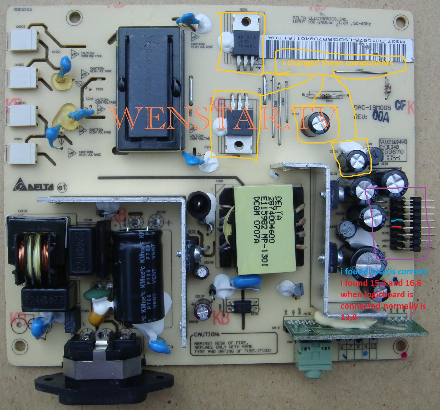

      Hi Guys,
      Just had fun fixing my Acer 1916W, 2 x Mosfets, 2 x Caps, 3 x Fuses. I substituted the AP40T03 with some RFP50N06 from a old UPS.
      If you have problems getting the CFL to work, try replacing both the Mosfets, not just one.

          hello,
          this is very interesting forum.
          I also have a problem with this inverter:
          monitor is dark, LED always orange and power button not risponding.i replaced the two MOSFETs and two capacitors which were bulging (C204, CE101), but the situation as not changed:the problem is not resolved.i measured output voltages:
          I have the 5Vcc, but instead the 13.8 vcc i find
          15.3 vcc, why this? You think that I must replace the logic board?
          wait an help .thanks in advance and sorry for my bad english.

            The 13.8 V output is high because only the 5V output is regulated. With no load on the 13.8 V supply the output will be a little high.
            Pictures of the signal card would be useful. Some of them have a defective reset controller; other times we see a bad LDO regulator.
            There is nothing seriously wrong with your English. You could pass as a product of the American educational system.

              hi,
              These are photos of the inverter and logic board.i asked to myself why i found
              15,3vcc with no load,and 16,8 with logicboard connected:i should found 13,8 !
              maybe it is corrupted the logicboard? or voltage is too high for its smooth operation?

                    The power supply regulates only the 5 volt output. It is designed so under normal load (backlights on), the other output is at 13.8 volts. If the backlights are not on, the 13.8 volt output will be at a higher voltage.
                    This is not the cause of the problem. The logic card does not use the 13.8 volt supply.

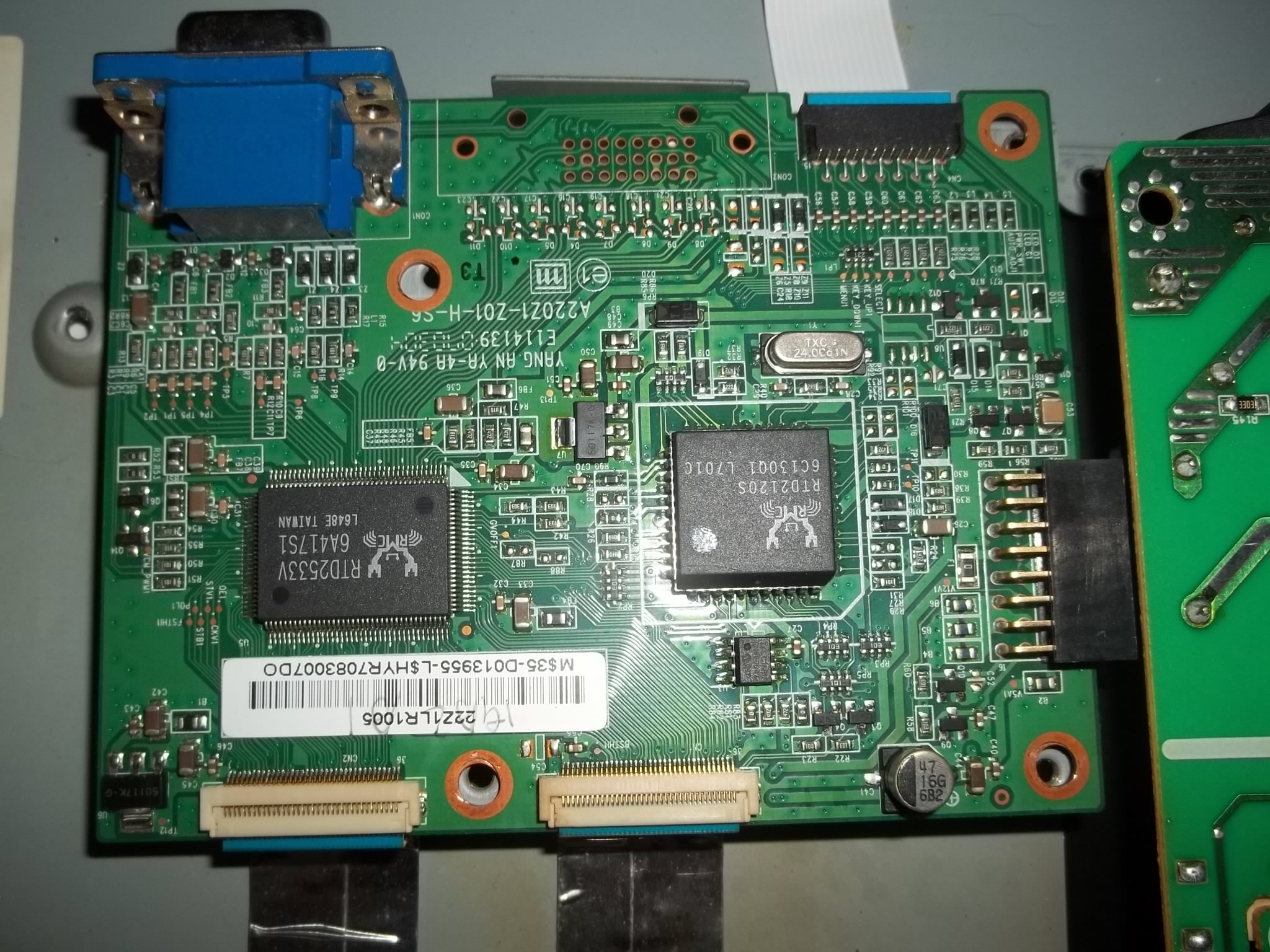

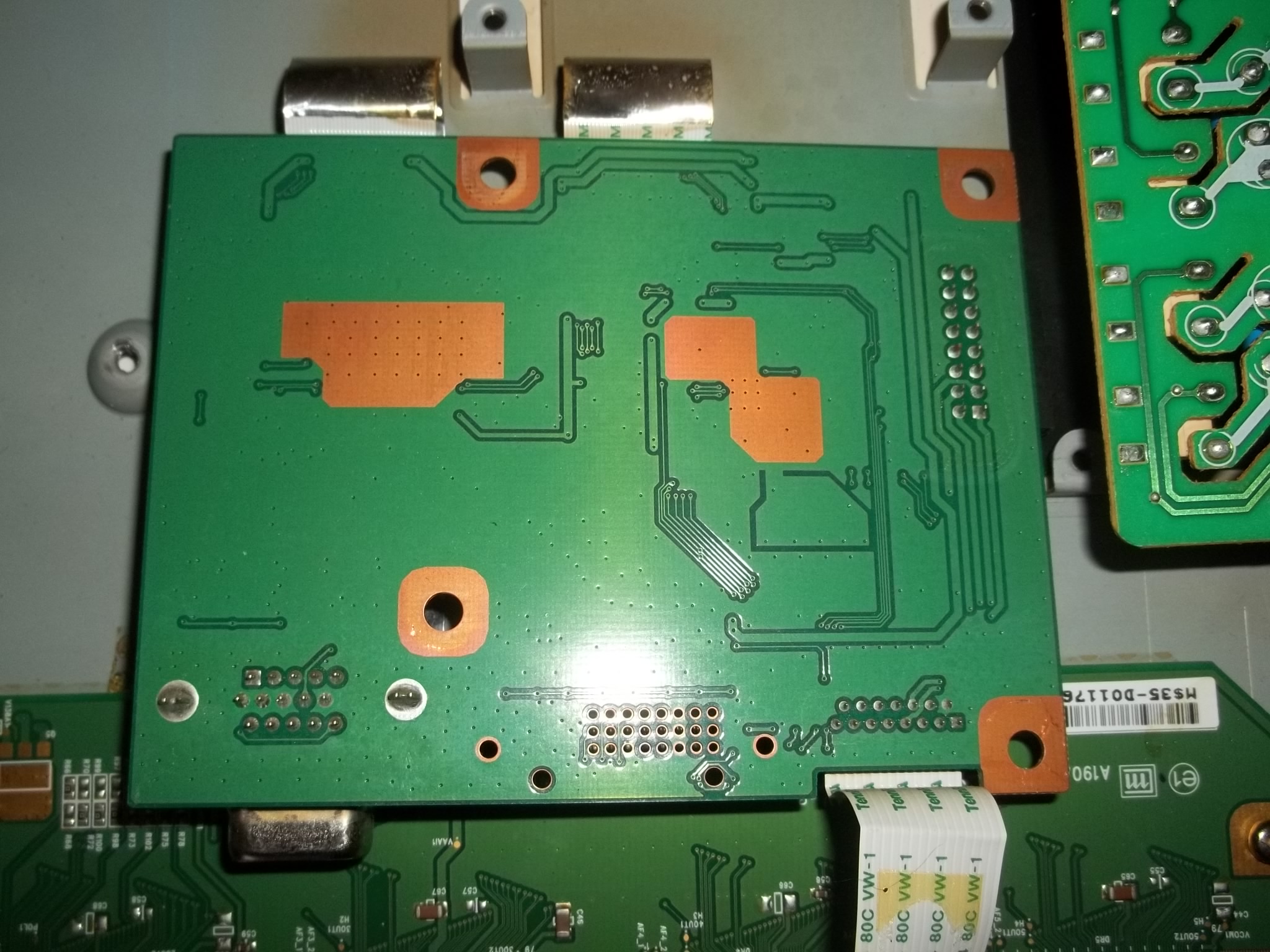

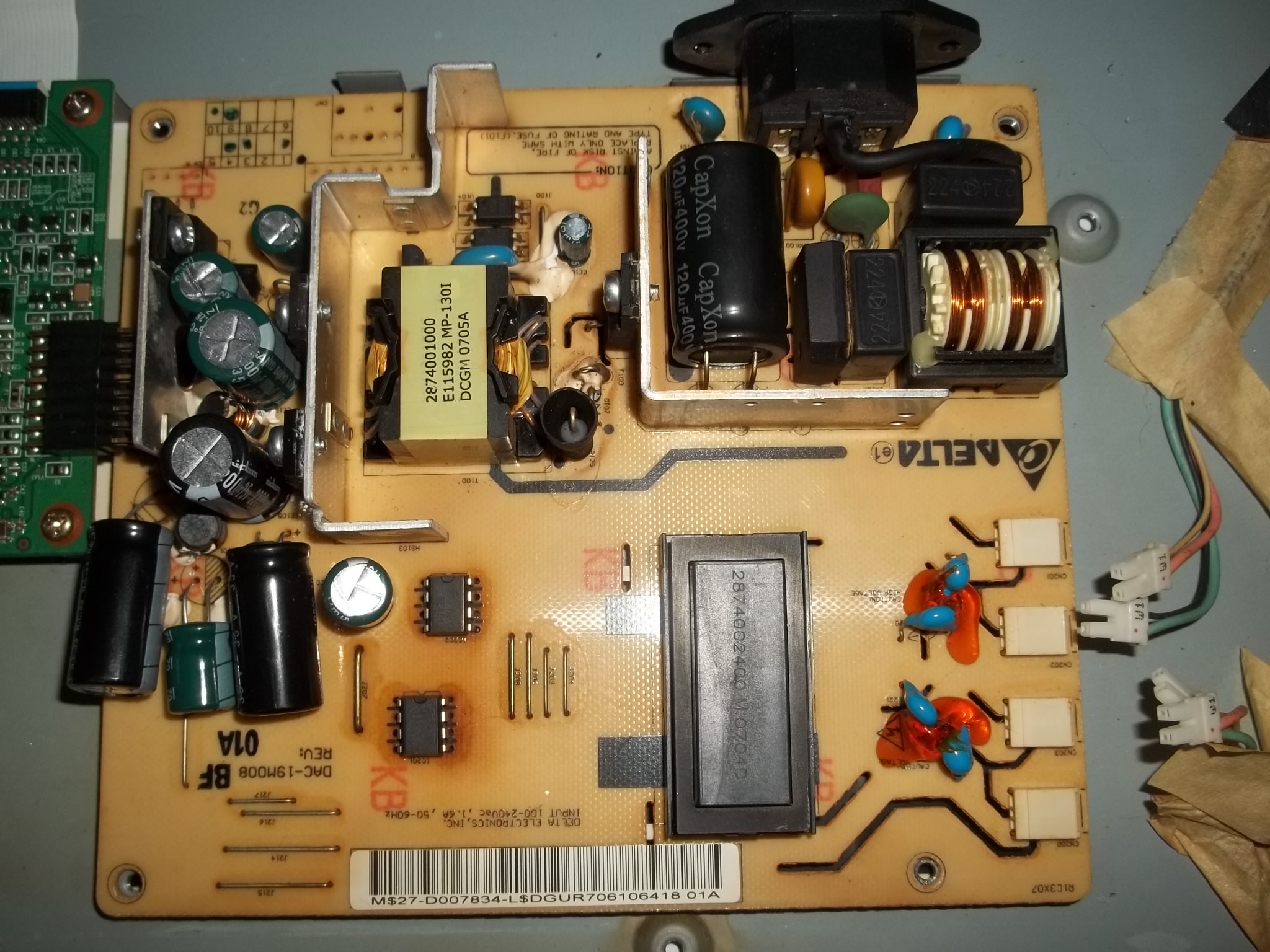

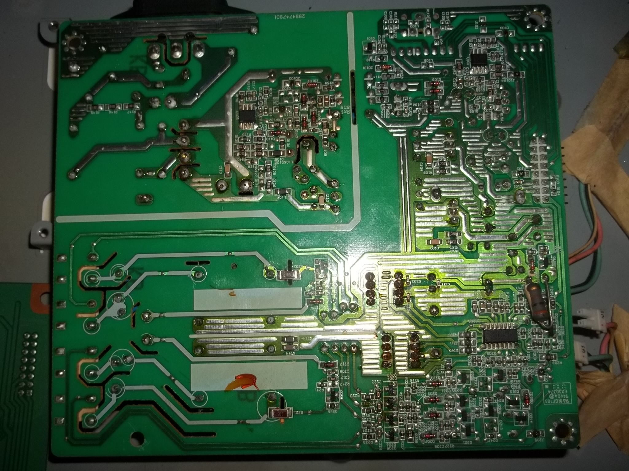

                                Just picked up one of these from a free pile.
                                All the 220uf caps were swollen. Replaced all electrolytic caps except the 120uf @ 400v and the 2200uf cap (and didn't replace that one because I didn't have one on-hand).
                                Found that F200 is blown. Not having one on hand, I put in a regular fuse in the interim, so I could keep testing. I've been using a fast blow, but should I use a slo-blow instead? It blows immediately.
                                I'm guessing a problem with the mosfets (they're not reading as shorted, but one definitely has different readings than the other). I'd order a couple from Mouser (along with the proper fuses) but it seems that Mouser doesn't carry them, unless I'm missing something.

                                        We can help a lot more if you please post good clear pictures of the whole chassis, and then pictures of each board, front and back (in the same orientation) and close up of connectors, (max resolution 2000x2000 and 2MB) using the manage attachments button, which is found by clicking "go advanced" under quick reply.

                                          Absolutely! Let me know if these don't work.
