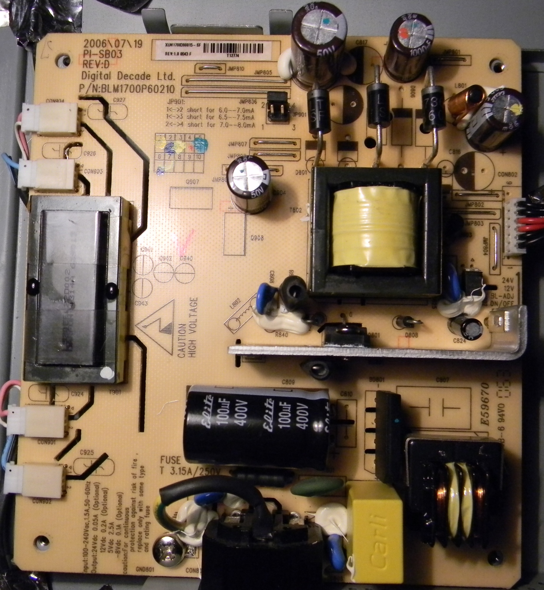

    got the same model monitor.
    power button does nothing, no powerup when power cable attached, no caps bubleing.
    transformer seconderies seem to be ok one 789 second 791.
    what could be the problem?

        Check the main fuse. If the fuse is good, check the voltage on the biiig black filter capacitor.

          main fuse is ok.
          The 400V cap you mean while power is connected ?
            Re: ViewSonic VA903b
            Yes, measure DC volts with power on ...'BE CAREFUL'.
            At the top of your picture there are 3 diodes,with Power OFF put your meter on Diode Test and measure across each.If you have not got Diode test then put on Resistance.At least one of these tend to go short circuit,which results in no voltage out.
              318V it shows.
              big yellow transformer makes hearable static.
              can there be soething?

                318V is OK can you check the volages on the connector to the main board.
                (Black and red wires) You need to have the boards connected and the lights if possible. Set meter on 20 VDC
                Black probe on a ground screw then check each pin on the socket and post the results.
                Did you test the 3 diodes as per Rtechs post no 25
                    Ok for diodes you need to measure in both directions
                    Most tests we use are in this guide written by retiredcaps start at post 19
                    https://www.badcaps.net/forum/showthread.php?t=10419
                    On the voltage picture I notice a 24v on the board. If that is a list of what you are supposed to get on that connector, please can you list it.
                    Also if the top one is 24v you need to test it with meter on higher than 20vDC - sorry.
                    I have been reading the rest of this thread. It seems that on your board the 1000uf
                    caps generally fail and they recommend replacing the startup cap which is a small one on the primary side. 50v 10uf

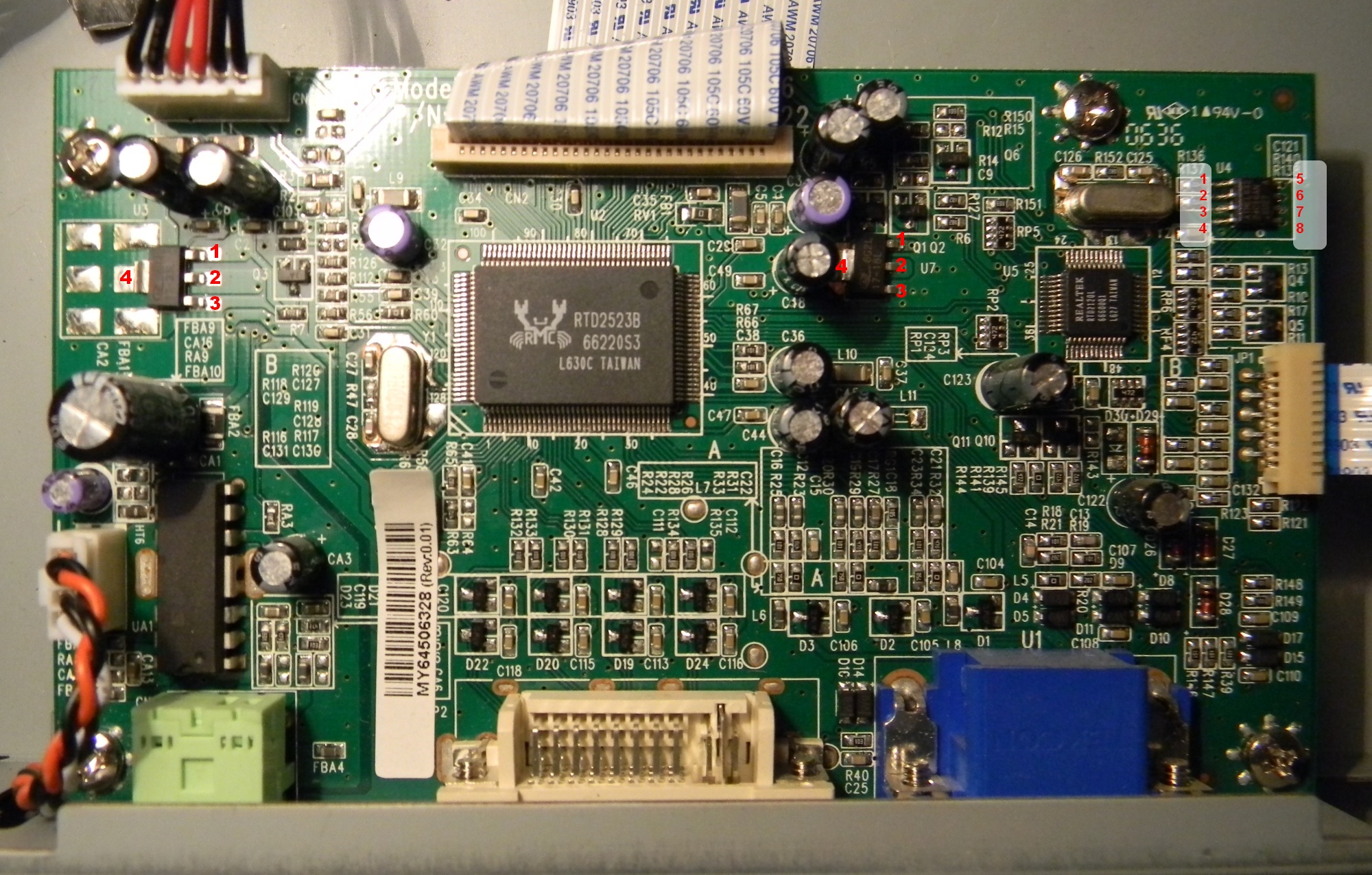

                                Ok Can you disconnect the main board and with the lights plugged in and the board
                                plugged into the mains can you apply 3 volts to the on/off pin. Use 2x 1.5v batteries.
                                negative to a ground pin. Or if you have a 10k resistor connect the 5v to the on/off pin.
                                We are also going to need pictures of the Main Board - can you post them
                                (max resolution 2000x2000 and 2MB) using the manage attachments button, which is found by clicking "go advanced" under quick reply.

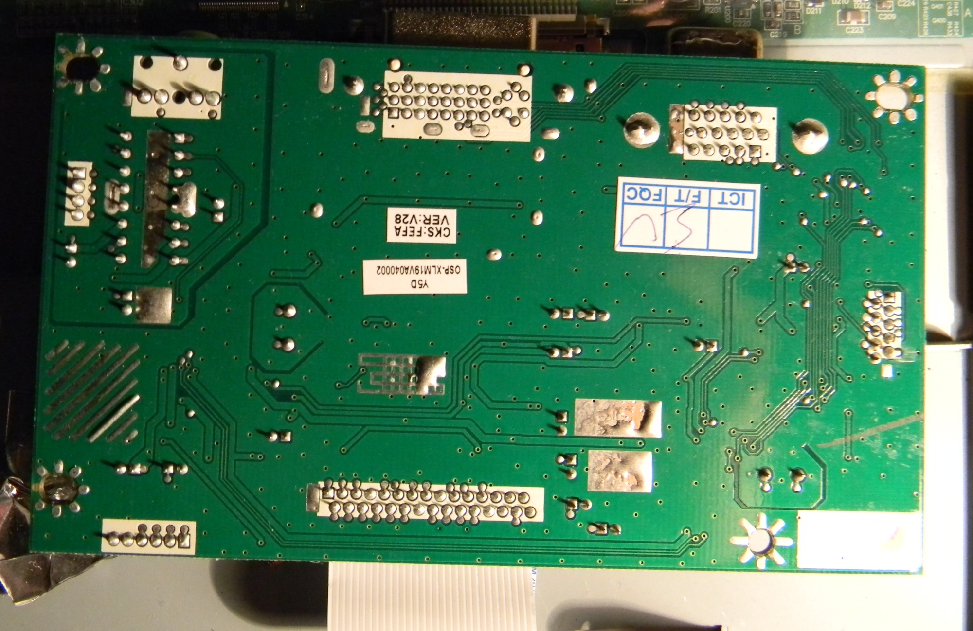

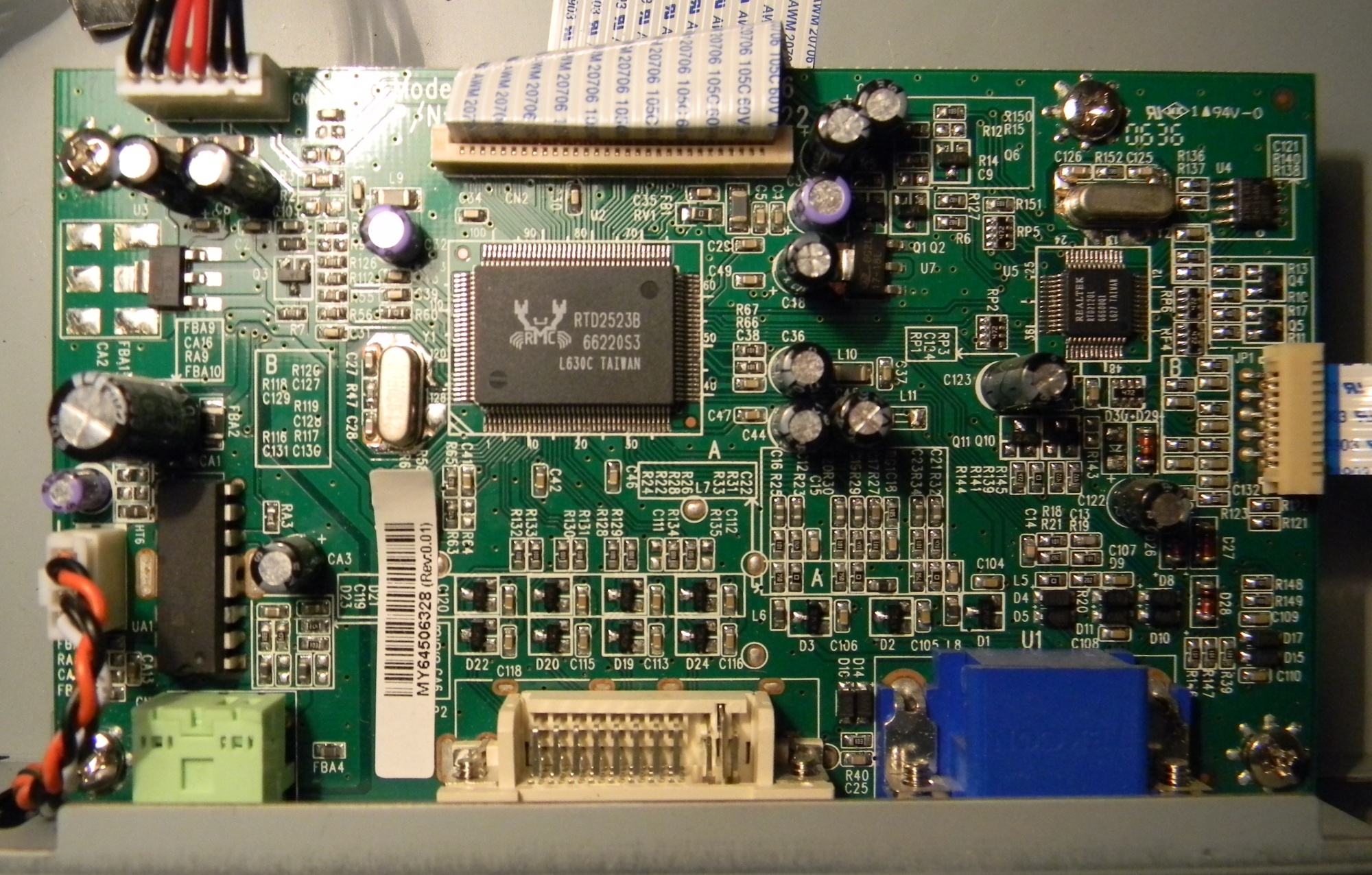

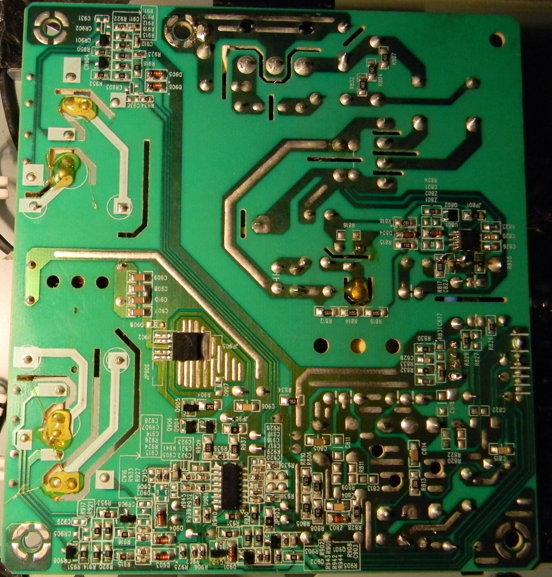

                                  Used some not so full 1,5 batteries on on/off pin. Got 2,7V outof these.
                                  It powered up the LCD - all pixels white.
                                  Here's some pictures:

                                    If the backlights stay on without going black using external force on power source, then your power supply/inverter board is OK. The screen is showing white due to the main board is not getting the power. Now you will have totroubleshoot the main board.

                                      I hate it when we get it down to the mainboard - it does not seem that we get them fixed very often.
                                      Start with testing the voltage regulators - think I see two but look for more.
                                      One is at U3 and one at U7.
                                      Retiredcaps has prepared a guide on how to find ,test and post results.
                                          U3
                                          1. 5.04v
                                          2. 3,30v
                                          3. 0,00v - is this normal ?
                                          4. 3,30v
                                          U7
                                          1. 3,30v
                                          2. 1,80v
                                          3. 0,00v
                                          4. 1,80v
                                          U4
                                          1. 3,20v
                                          2. 3,20v
                                          3. 3,23v
                                          4. 0,00v
                                          5. 0,00v
                                          6. 0,00v
                                          7. 0,00v
                                          8. 0,00v
