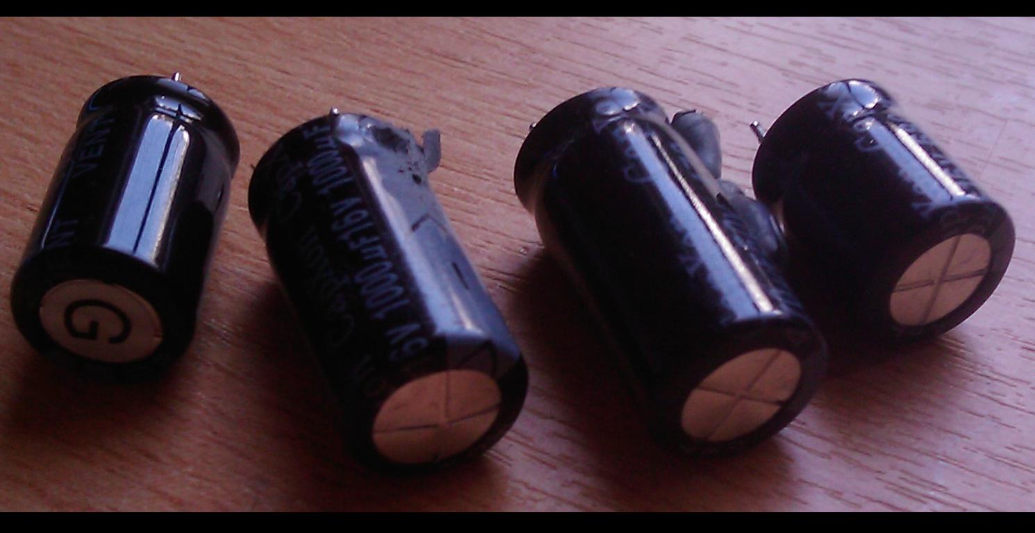

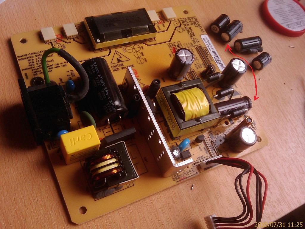

    Finally I got one lcd fixed.
    When I got this 19" monitor it was totally dead. Trying to turn it on caused just some whining sound and it turned of immediately.
    1000uF cap was slightly bulging so I first replaced it only. That was all it took to get it working. Making sure it won't fail again I chose to replace other caps too. Original caps on board were CapXon's.
    Of course I had to buy too big 1000uF cap . Luckily I was able to fit it in by putting it on it's side.

    I just repaired several Viewsonic VG930M-3 with the same power supply and the exact same problem. It seems that the 1000uf cap is a common failure for that supply. The original cap was rated at 1000uf 16V, but I installed a 1000uf 25V cap, since that cap was the only one bulged. I also decided to replace the other Capxon caps (which looked ok) as well. You might also want to replace the small 10uf 50v cap as that supplies the startup circuit.
        Thanks, I did not even notice that cap when I made my purchase list. I will replace it too.

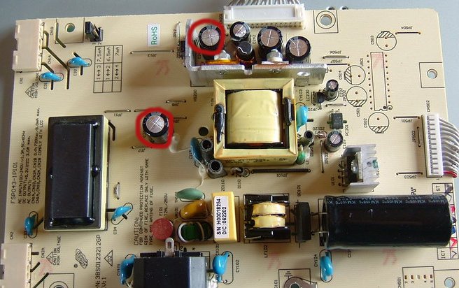

          I have opened up my Viewsonic VA903b and am looking at the capacitors
          You say they can 'bulge'... what does this mean exactly?... bulged on the sides or end?
          When I turn on the monitor it makes a whining sound,shows the picture while whining then clicks off/goes to standby. If I turn it on and off several times eventually it stays on... Does this sound like a capacitor issue?
          I have attached a photo showing the extent of the end bulging on my capacitors. Any advice appreciated.

            "Bulging" generally means the top portion (although I have seen the sides bulged also) of the cap is no longer flat, but curved like in your photo due to internal pressure buildup. Replace ALL 7 of the caps. You can leave the larger one (lying on it's side) alone, since these rarely fail.
            If your next question is "what do I order and how", I suggest Panasonic FM FC series caps from digikey.com if you live in the USA. It should cost under $10 including shipping. Use the directions below:
              C242 is also bulged, but not circled in red.
              Like jetadm123 said, replace them all.
