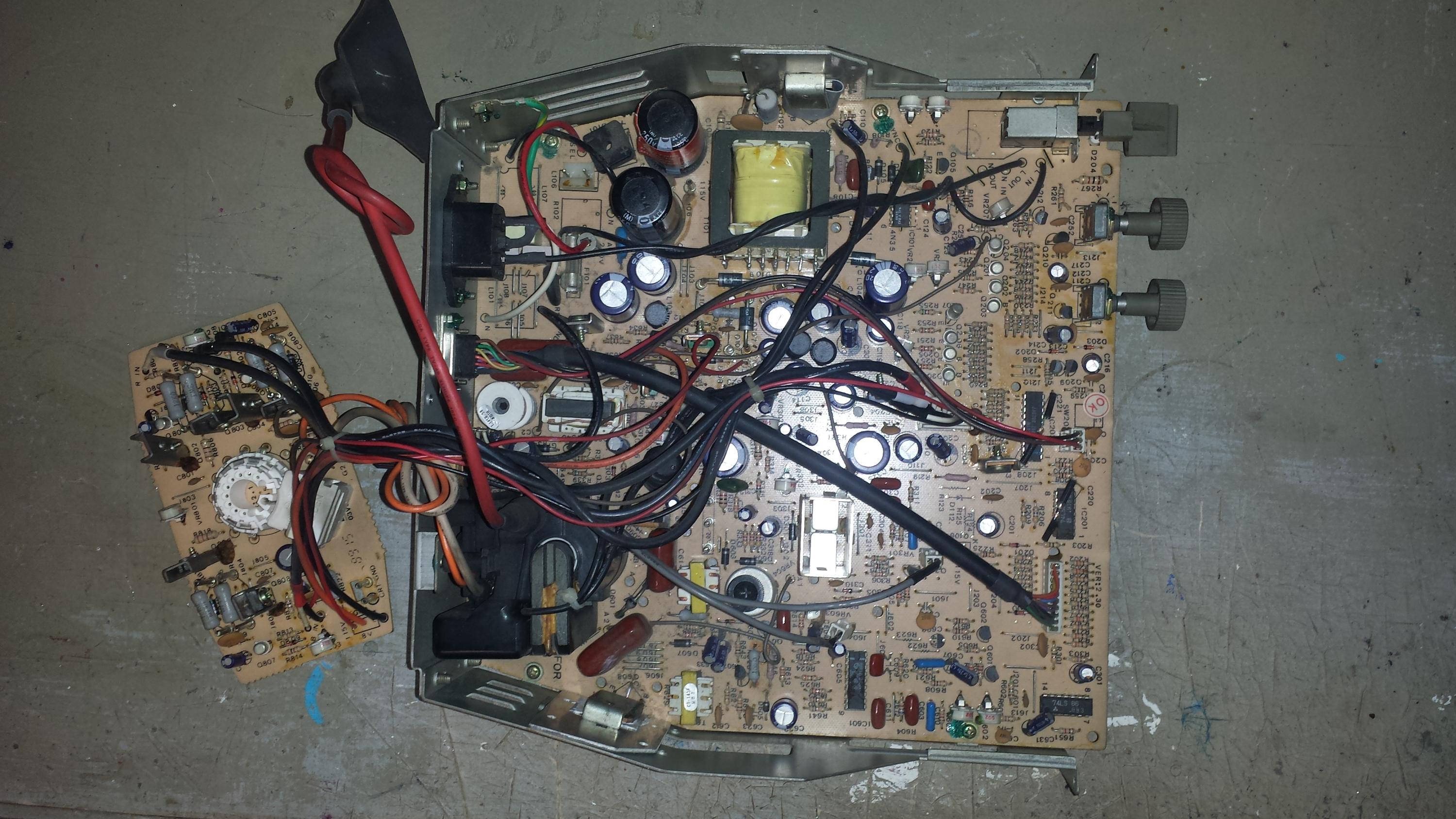

    The picture on this monitor has stated to jump. it does improve a little sometimes when left turned on for a long time. It jerked/jumped/flickered to start with then stopped and the picture was stable for over 3 hours before i turned it off. I turned it on again today and its jumping/flickering etc again and occasionally it will stay steady for ages then give a little flicker. I tried tweaking the pots than can be accessed a little each way to find if any would help and found one pot (one on the right in photo) and when turned to full range both directions, will cause the screen to scroll and then roll round to the right or left. with careful adjustment i can almost stop it jumping/flickering but only lasts until turned off and then on again next day then i have to tweak this pot again to try and stop it. I dont think this pot has anything to do with the fault though. I have up loaded lots of photos of the monitor here:
    https://drive.google.com/drive/folde...WW?usp=sharing
    Please can anyone help me solve this as its a matching monitor for a very old but lovey vintage Viglen VIG1 286 system ive had many years.

    ...will cause the screen to scroll and then roll round to the right or left. with careful adjustment i can almost stop it jumping/flickering but only lasts until turned off and then on again next day then i have to tweak this pot again to try and stop it.
    That's known as loss of horizontal sync, I think that pot sets a frequency which is used to lock the horizontal frequency of the monitor to the video source. When you turn it too far the difference in the monitor and source horizontal frequencies is too large and the sync is lost.
    With regards to the problem, when it jumps, is it also to the right/left? or up/down?
    Also, what do you have it connected to? I think this can also be caused by a bad computer graphics card too.

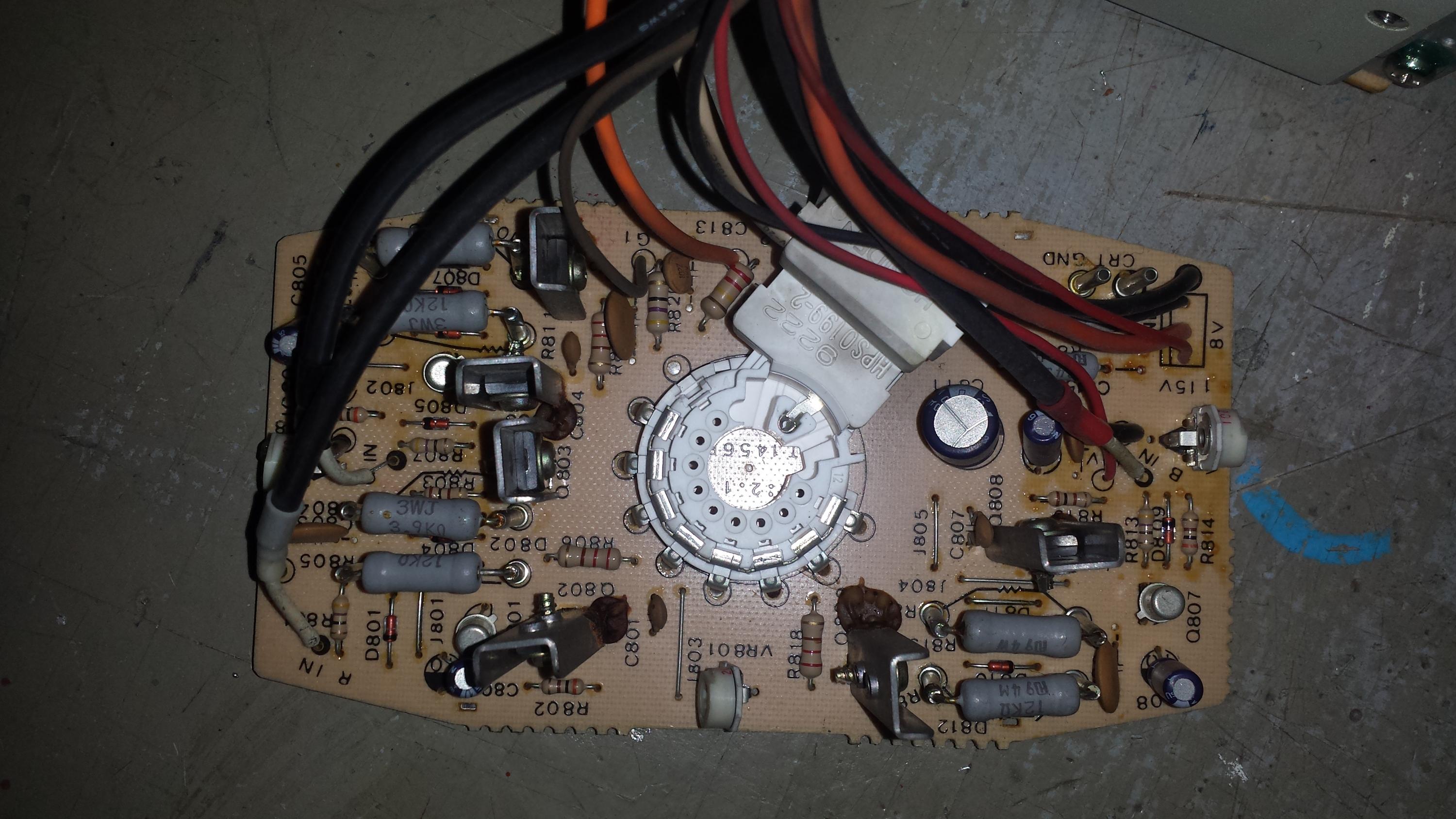

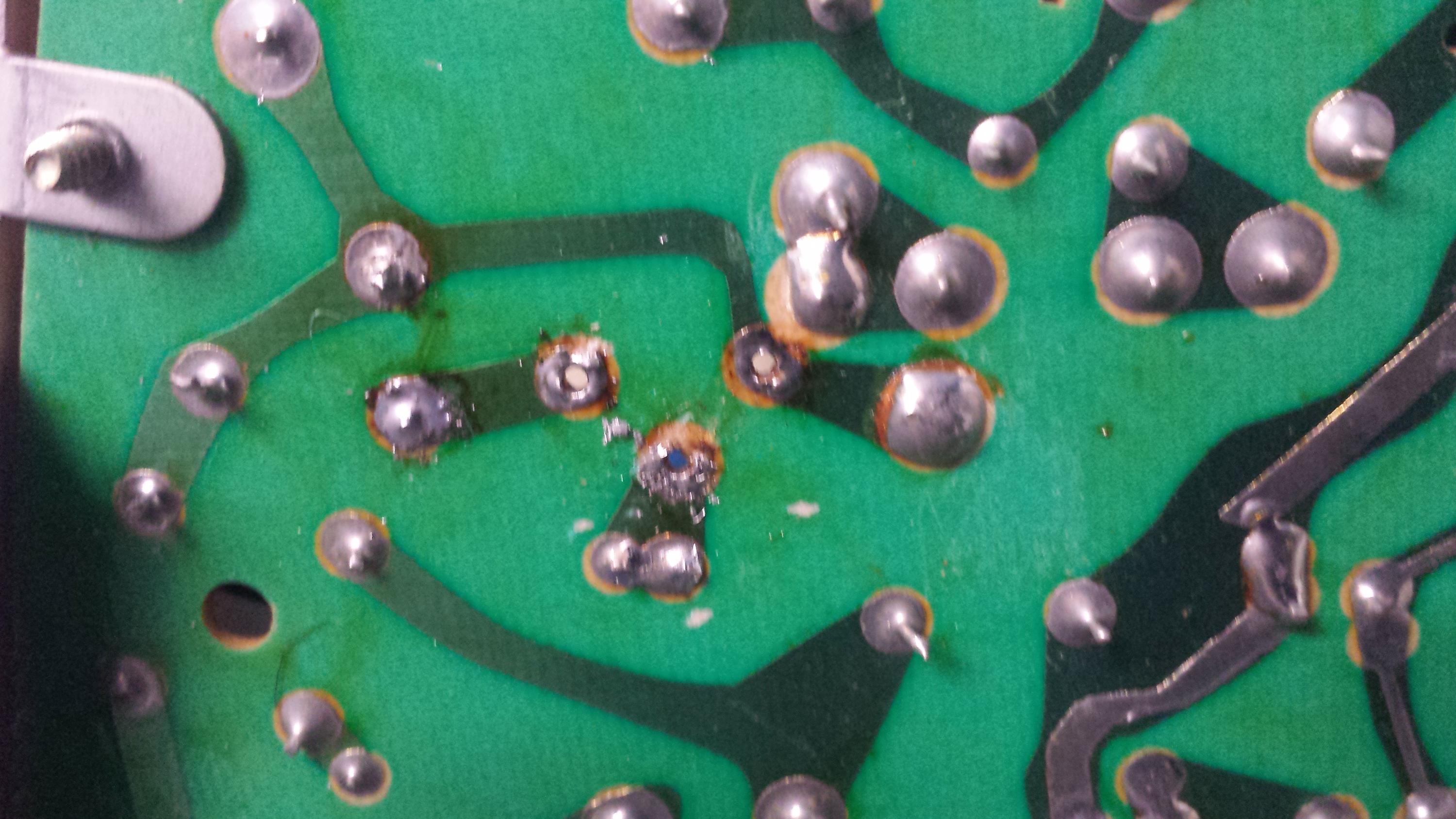

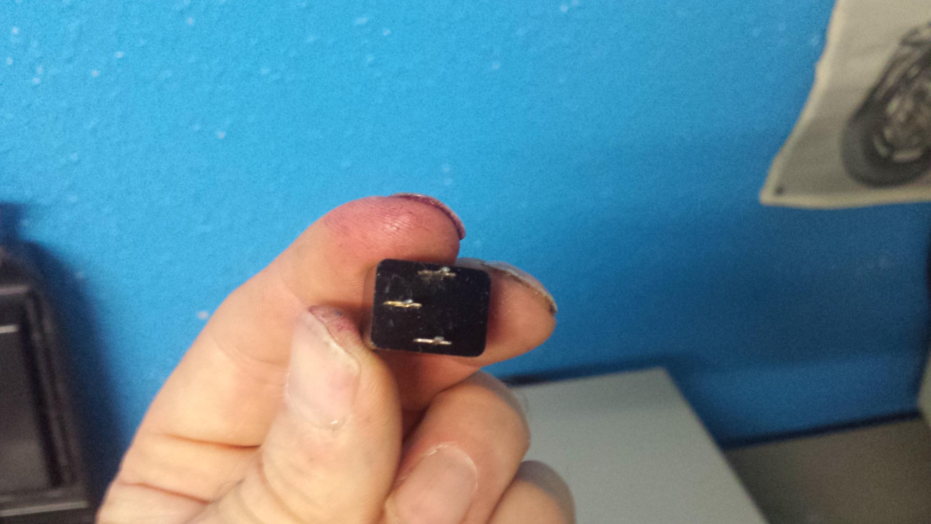

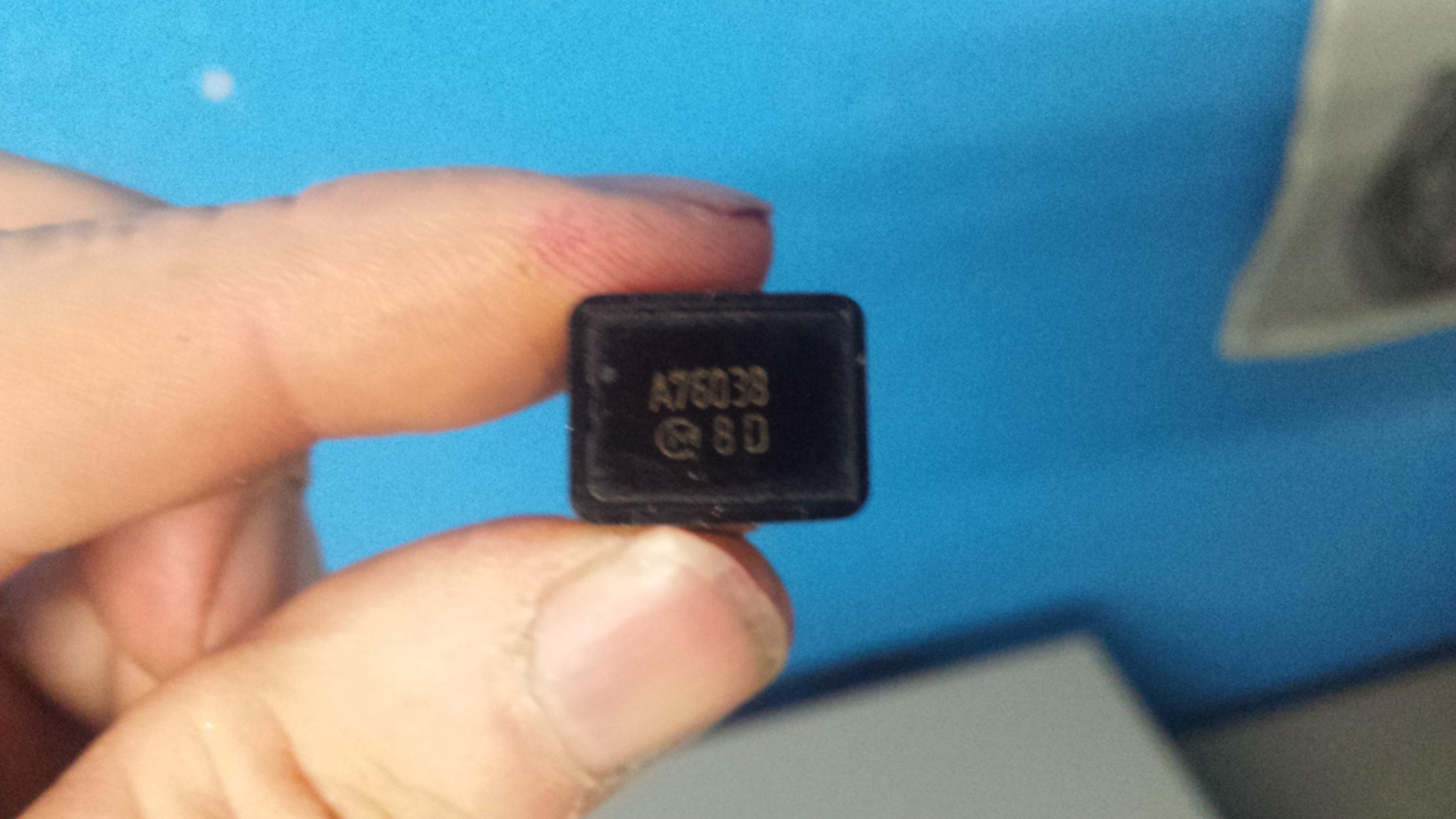

          I had another look at this monitor today and when checking the solder side of the pcb I found a very bad connection where the solder hadn't fused to one leg of a 3 legged
          component. Not sure what it is but its marked as R102 on the pcb but it dont look like any resistor ive seen. You can see it in the picures, its just behind the AC power socket.
          When I first tried the monitor after soldering the contact on one of its legs, the monitor had a nice steady & stable display and then after a few minutes or so it started to jump and I put my finger on the top of the component and it was pretty hot and hotter than I would say is normal. Can anyone tell me what this little black plastic box with 3 legs is and Should it get really hot and should all 3 of the legs have been soldered properly? Is there any way of testing it?

            Thats the degausing thermistor. there are two thermistors inside, one across ac line I believe and one in series with the degausing coil, The one in series with the coil is 8Ω ptc, It has nothing to do with anything other than crt deqausing.
            Do like the others have said and replace the caps in the vertical circuit.
            Also replace any caps in the sync seperator circuit, The vert. and Horz. sync. signals are carried on the green video input line. In the case of the vertical, the pulse needs to be seperated from the video and fed to the vertical osc. (part ofthe vert ic likely) for synchronization. If the video signal is poor this can also effect the vertical sync signal. IE: a poor cap in the G video signal path can clip the vertical pulse causing poor sync.

              there is probably a lot of cracked solder joints - check everything large or bolted to a heatsink.

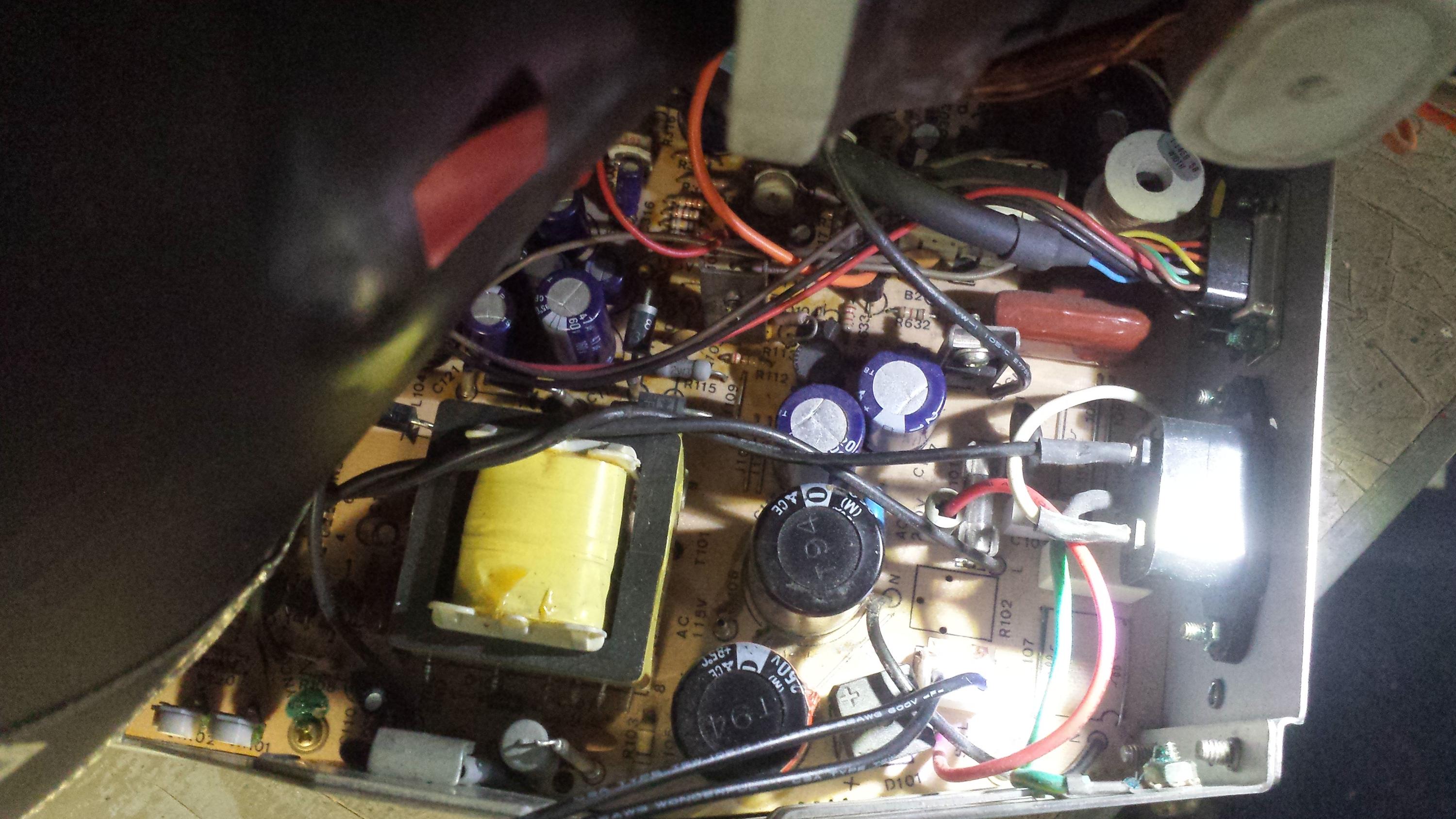

                also noticed it has panasonic caps and crt.
                lower probability of dead caps.
                looks like the mfr tried to make a decent unit.
                add to the above list of stuff to resolder anything that runs hot.
                like higher wattage resistors.
                  Thank RJ I did measure it and it measures like two resistors a 631.3 and a 20.8Ω one. Do those values sound OK?

                  The soldering on the PCB is excellent and I could only find a few that I had to resolder.

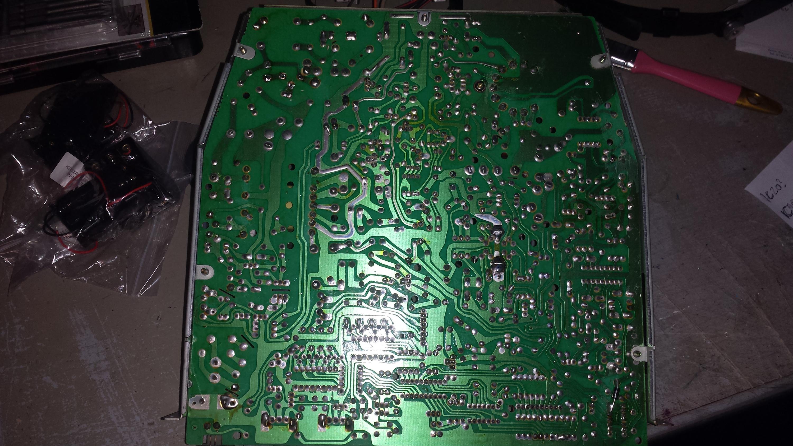

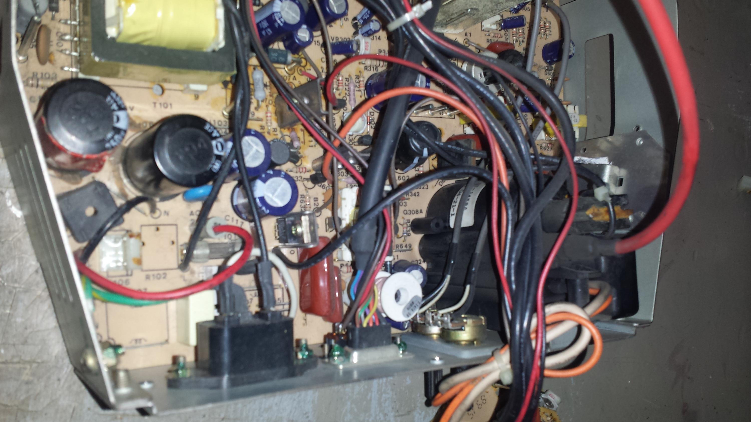

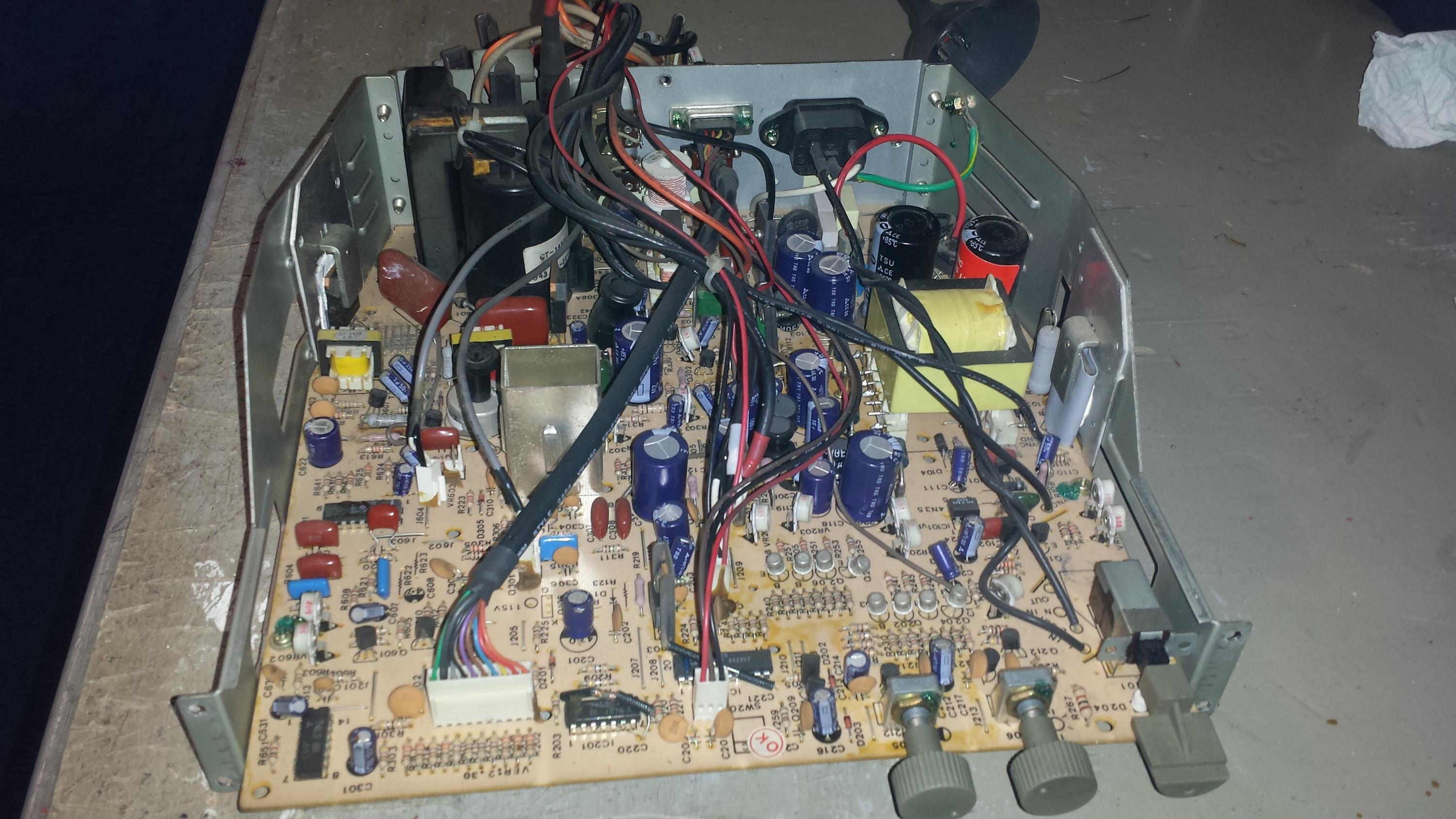

                  Can you point me where this section is on the attached pictures with the PCB now removed from the chassis. Someone might now recognise this monitor. Its certainly very well made.

                    The values for the thermistor are ok, they do change over time/use. Like I said, it is only for degausing the crt at startup, thats it.
                    You can see where the rear video plug connects to the board and near it is the plug that feeds the rgb signal to the crt board, there are a couple ic's around there, ic20? and ic201, also give the number of ic601
                    Also a nice picture of the trace side of the board for that area.
                    It looks like this monitor uses a combined horz/vert drive ic (ic601) and the vertical output are two seperate transistors

                      Re: Viglen CRT monitor intermittent jumping
                      IC601 = TDA2595
                      IC204 = MC 7812C
                      IC203 = MC 7805CT
                      IC202 = N825147N
                      IC201 = 74LS04

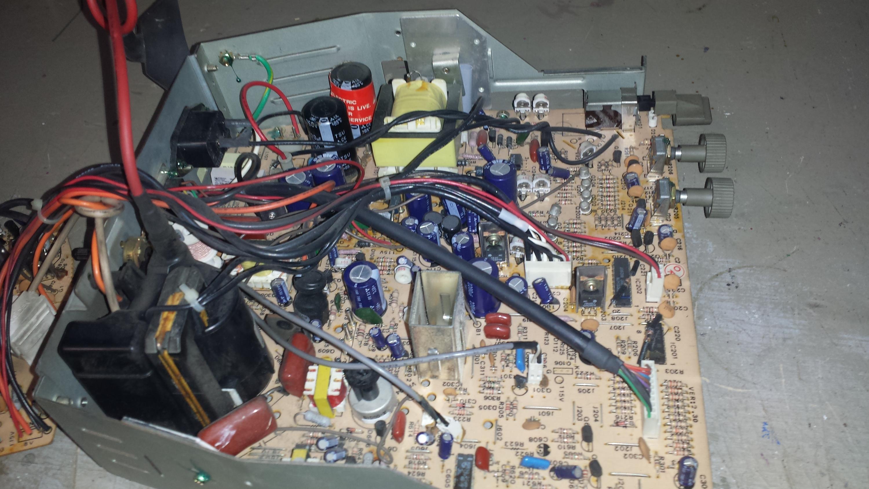

                      Here is another picture of the PCB hope its better this time.
                      IC604 is on the right hand side of ths picture about half way up.

                        The vertical output is hidding, it is under the square metal heatsink next to vr604 Likely a tda1170
                        It looks like they are not using the vertical section of ic601 as there is no trace to pin #9
                        What is the ic next to ic201, the one near the OK sticker? the plug wires are covering the last digit in the ic20?
                          Its IC202 so a N825147N. It has a diode across the top linking two pins.

                            That is an S not a 5 N82S147N, thats why I could'nt find any info on it.

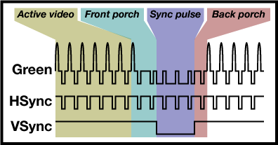

                              I was wrong about the sync on green It has seperate vertical and horzontal sync inputs. So the vertical sync signal comes from the rear connector and is fed to the vertical ic sync input. likely pin 8 of the vertical ic
                              I would try replacing C318 and the other small elec. next to it
                              Its a pita without a schematic.
