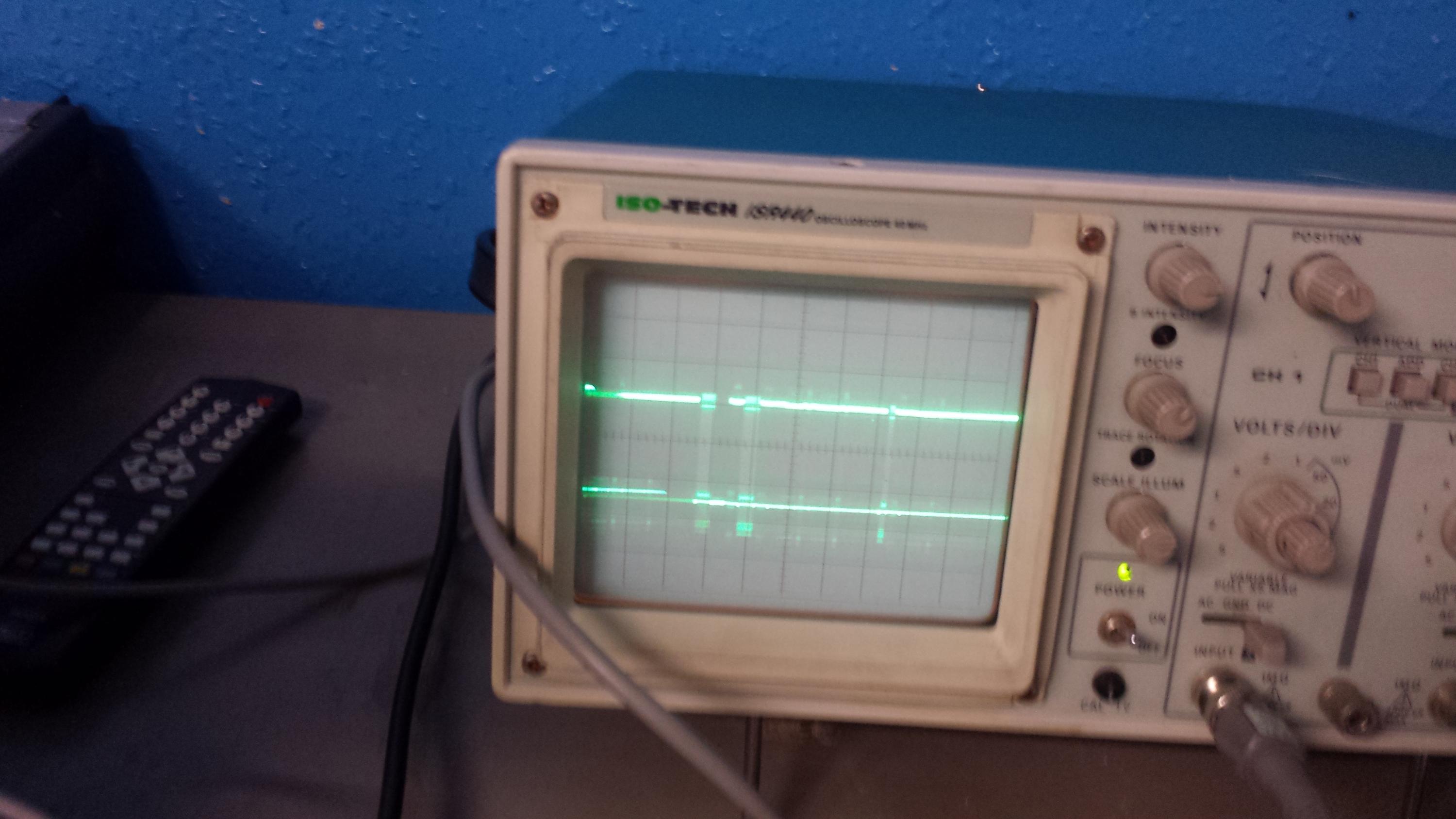

    Ive got it all back together and powered up and it seems quite happy and tube lit up. Still no picture when connected to PC though. I had a another go at testing for a video signal on the pins that carry the RGB signals. I used the Isotech scope this time and I got this display that does look different to what I get from the pins on the dsub connector. I read a article online that covered measuring video signals on a anolouigue and digital scop[e and it says its very hard to get a decent display with out something call a video trigger which I dont think this scope has. Anyway does this picture look anything even remotely useabe?
      Re: Viglen CRT monitor intermittent jumping
      If you really want the video to be stable and triggered you are just looking to see where it is being lost.
      If you really want a stable video signal for one video frame or one line, feed the vertcal sync pulse from the pc into channel 2 of the scope and have the scope set to trigger on channel 2
      That could be good video? what is the pc outputing? a single c:> prompt a bios menu?
      Adjust the variable on the trigger control should provide a single frame of video.
      Type stuff on the keyboard and you should see the waveform change
      Remember this is a video signal that has NO sync pulses within it so it is hard to display a steady pattern. It is NOT like a regular broadcast composite video signal, that has the sync as part of the video waveform.
      On the computer the vertical and horizontal sync pulses are on seperate pins.
      I will take a guess at the video displayed on the scope and also guess that the scope trace did not start at the start of the scan (likely triggerd by some part of the video)

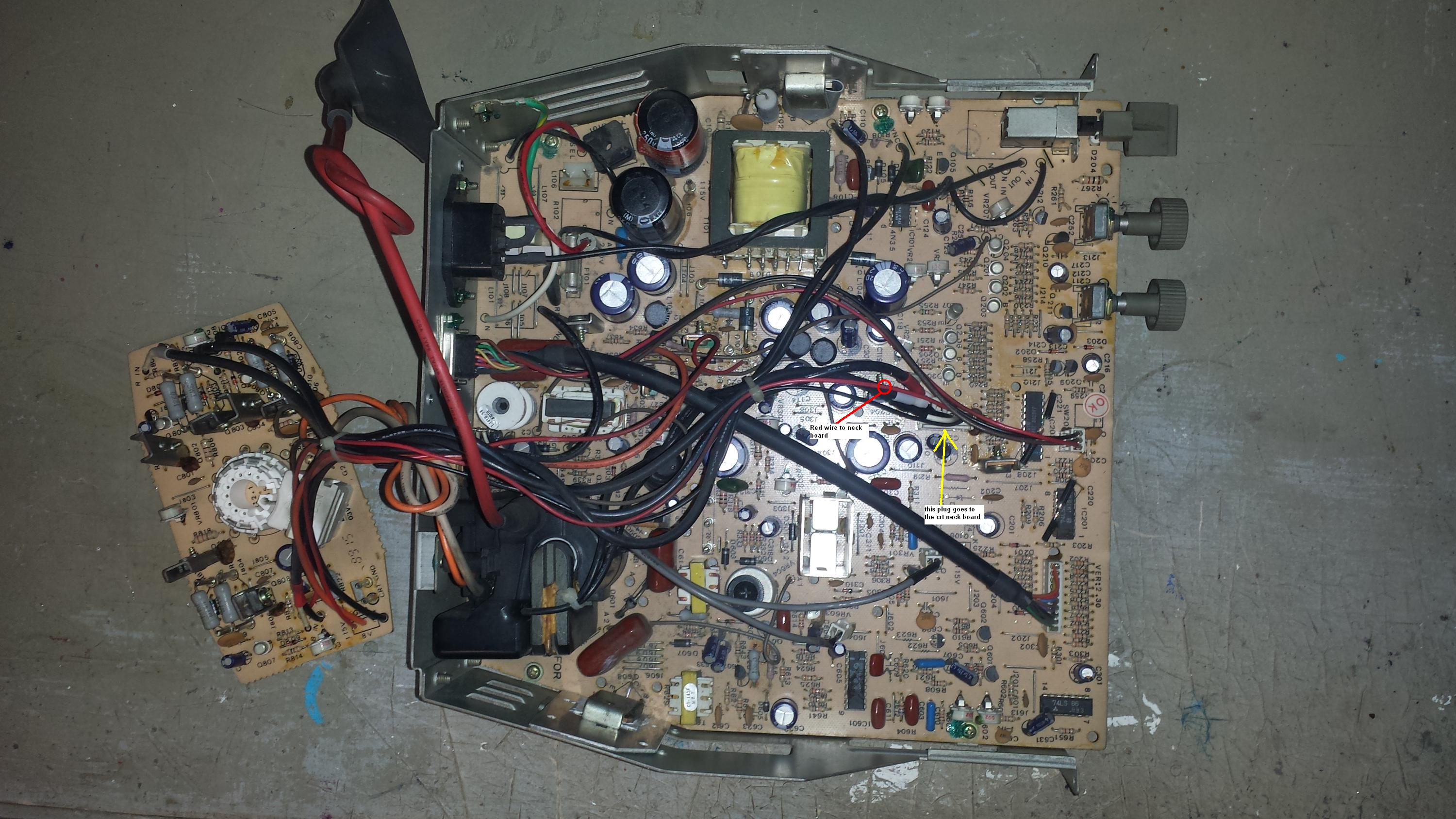

        Check if there is any video on the neck board, R in, G in, and B in. also check if you have voltages on Q807 e-b-c.
          Q807 has between 2.4 & 3.6v on all pins
          The RGB wires conected around the tube dont show any signal. The scope screen goes blank. (There is a Red, Green, Blue, & Yellow on that group of wires, is the yellow a sync or something?
          The PC boots straight to a graphical type desktop call GEM (graphical environment manager)

            You say the scope screen goes blank when checking for a signal on these 3 points? What is the input voltage range on the scope set to and is it also set to AC and NOT DC.
            You should have a similar signal on the neck board as you measured where the DB9 connector connects to the mainboard, only the amplitude would likely be larger.
            I am starting to suspect there are no or low voltages to the area that does the signal processing on the main board.
            I also don't see any yellow wire going to the neck board, The r,g,b wires between the neck board and main board are thin coax cables.
            There are no sync signals that go to the crt board.

              Looks like a misunderstanding, I was thinking when you said neck you meant around the base of the tube where where are 4 wires RGBY solderd on. These come up from the 4 pin connector on the pcb. Sorry about that I ested the right 3 coax wires on the tube pcb and they do have the same signal as that on the 9 pin D connector.
                So you are getting the video signal to the crt neck board (the board that plugs onto the crt). Now see if you are getting it to the transistors on that board.
                On the plug that goes to the neck board that has the 3 video signals, there is also a red wire, what is the voltage on it?
                That picture you provided is the side of the deflection yoke, you don't need to check anything on it.

                    I had him check the +115 and he said it was there, I also asked about Q807 "Q807 has between 2.4 & 3.6v on all pins" which seems low?
                    So now I am asking about a lead (red wire)that goes from the main to the neck board as I think it could be a supply for the board.
                    Its hard to trace based on the pictures that are obscured by wires, and no schematic.

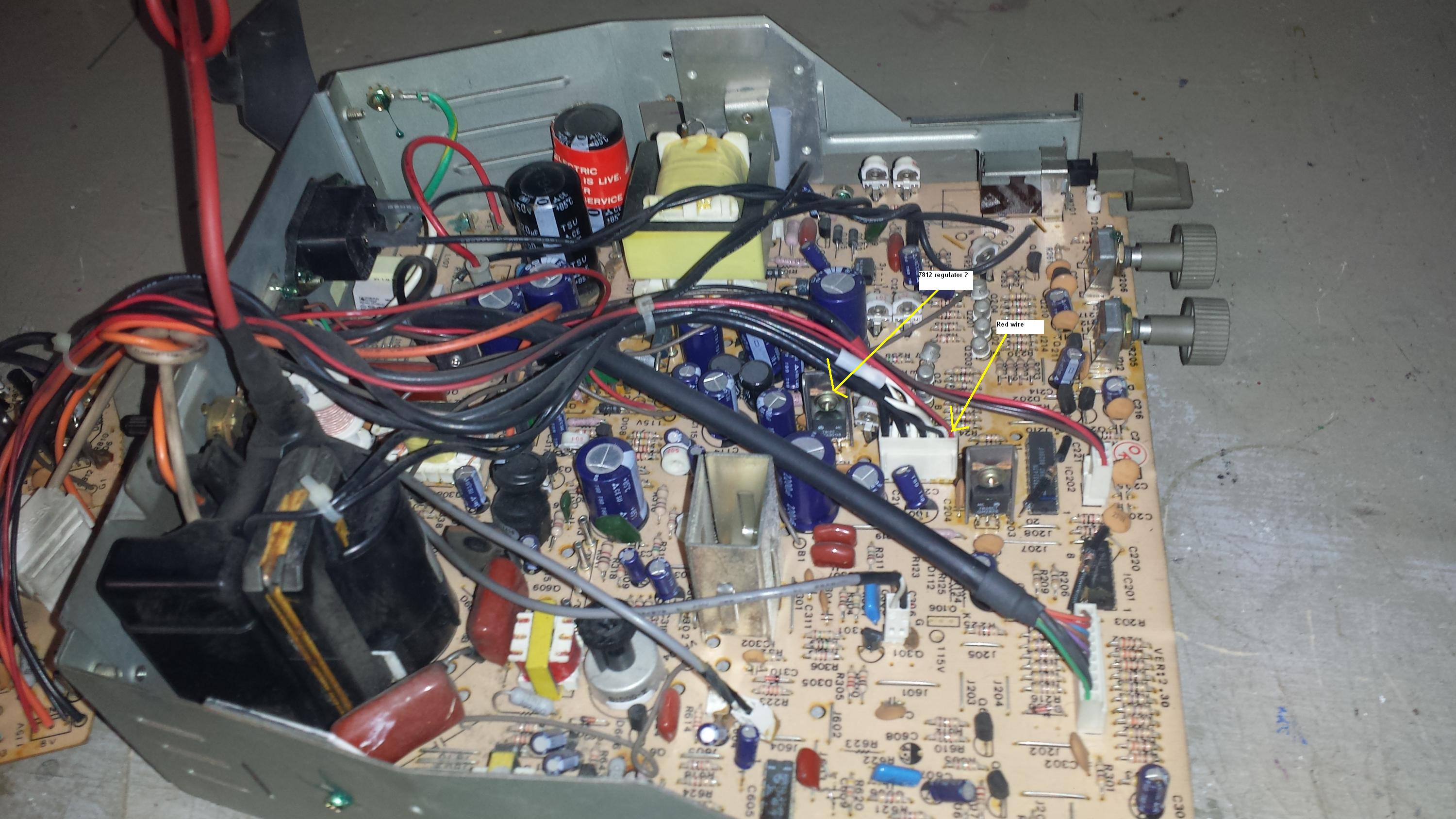

                              Ok thats good, now whats the voltage on the other RED wire I asked about? It supples a lower voltage to the video circuit on the main baord and also up to the crt neck board
                              On one of your pictures that regulator ic looks like it could be a 7812, so the red wire should have 12 volts on it
                                The other red wire on the neck board has 11.8v.
