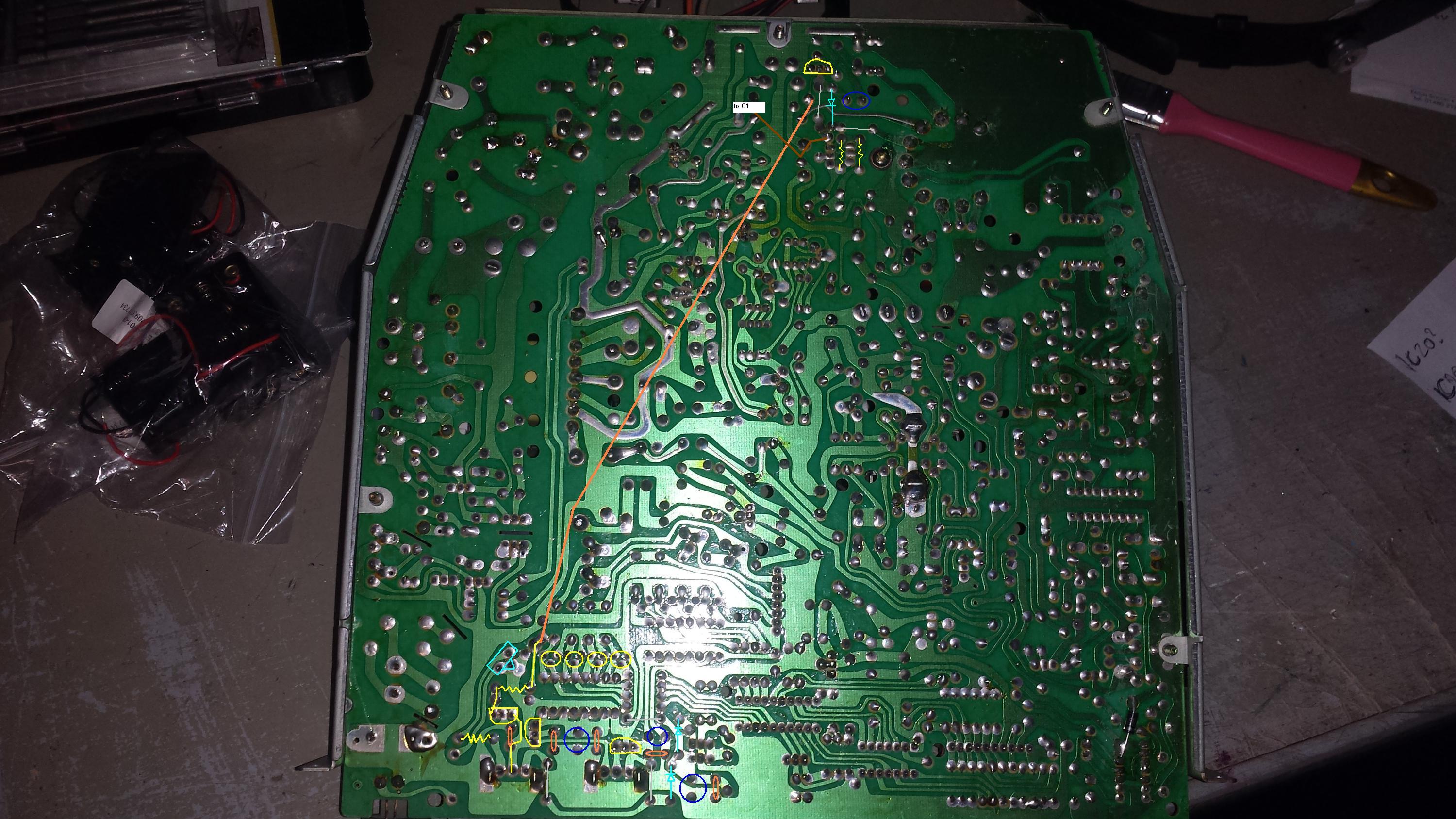

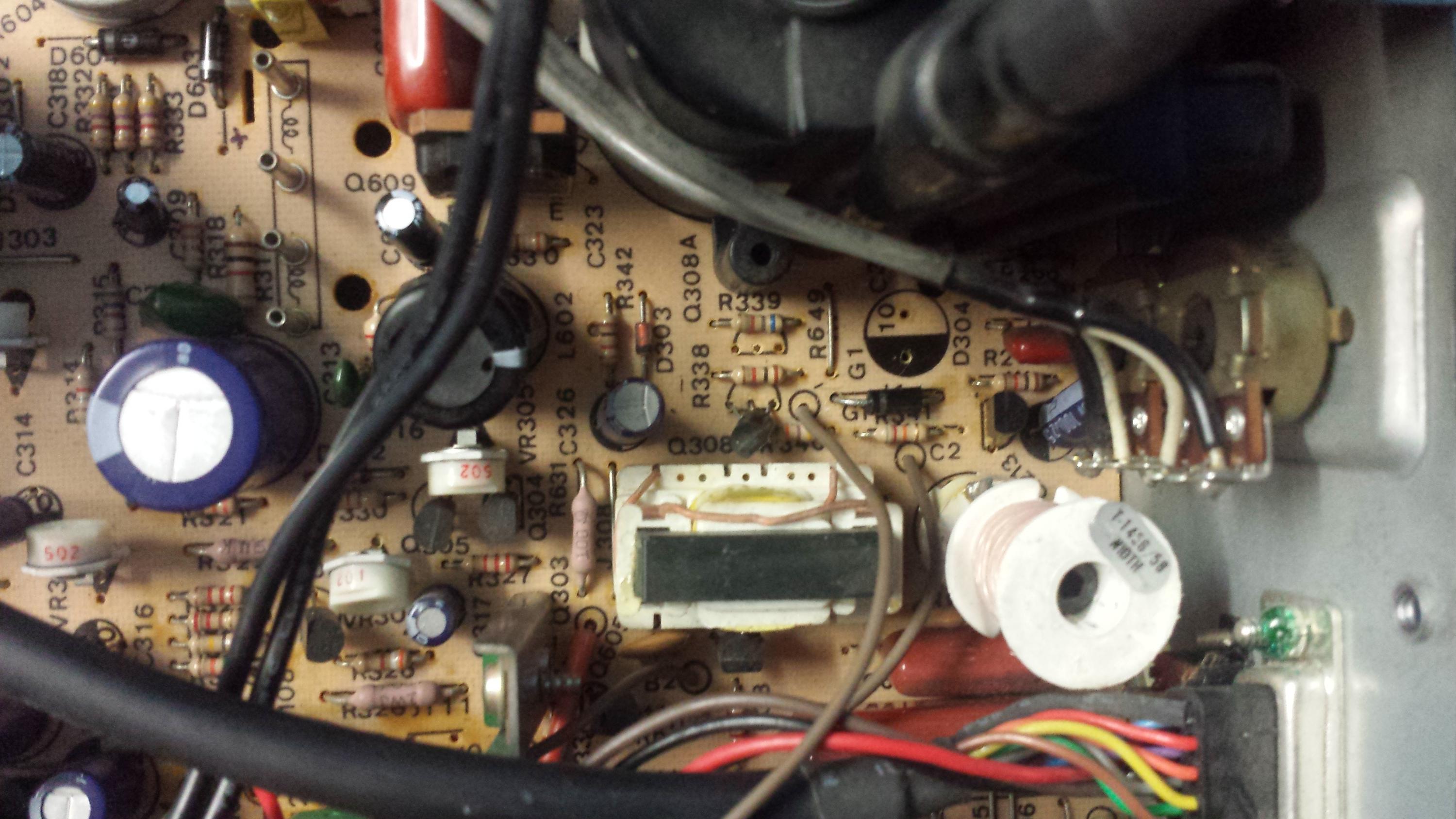

          Where the G1 wire is on the pcb can be seen in the attached picture marked in RED (zoom in) Near to HT transormer. I checked voltage at Q212 & it has vey little. 0v on the centre pin and 0.1v on the outer pins.

            I think we are getting somewhere, there is a transistor near the flyback that is connected with a wire from the brightness control circuit. There must be something in that area that is bad. transistors don't work too well with .1 volts on them
            Due to the wires etc. around the flyback I can't see how things are connected in that area, this is my best guess, so far

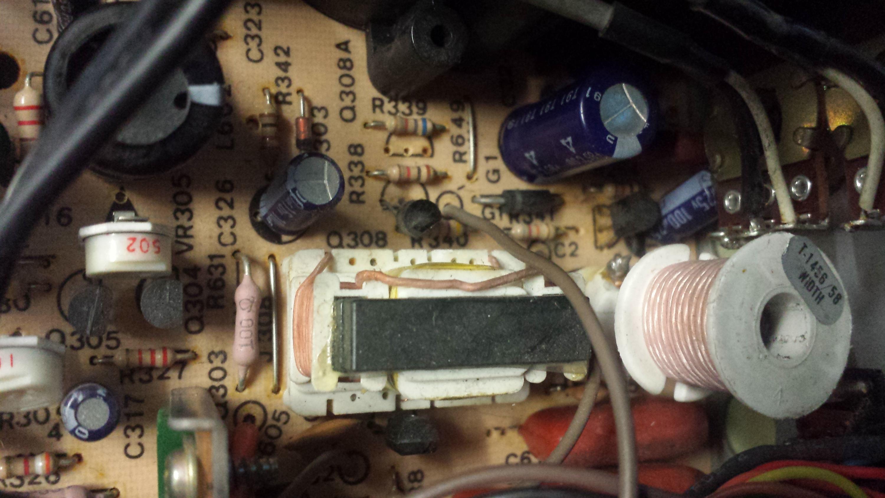

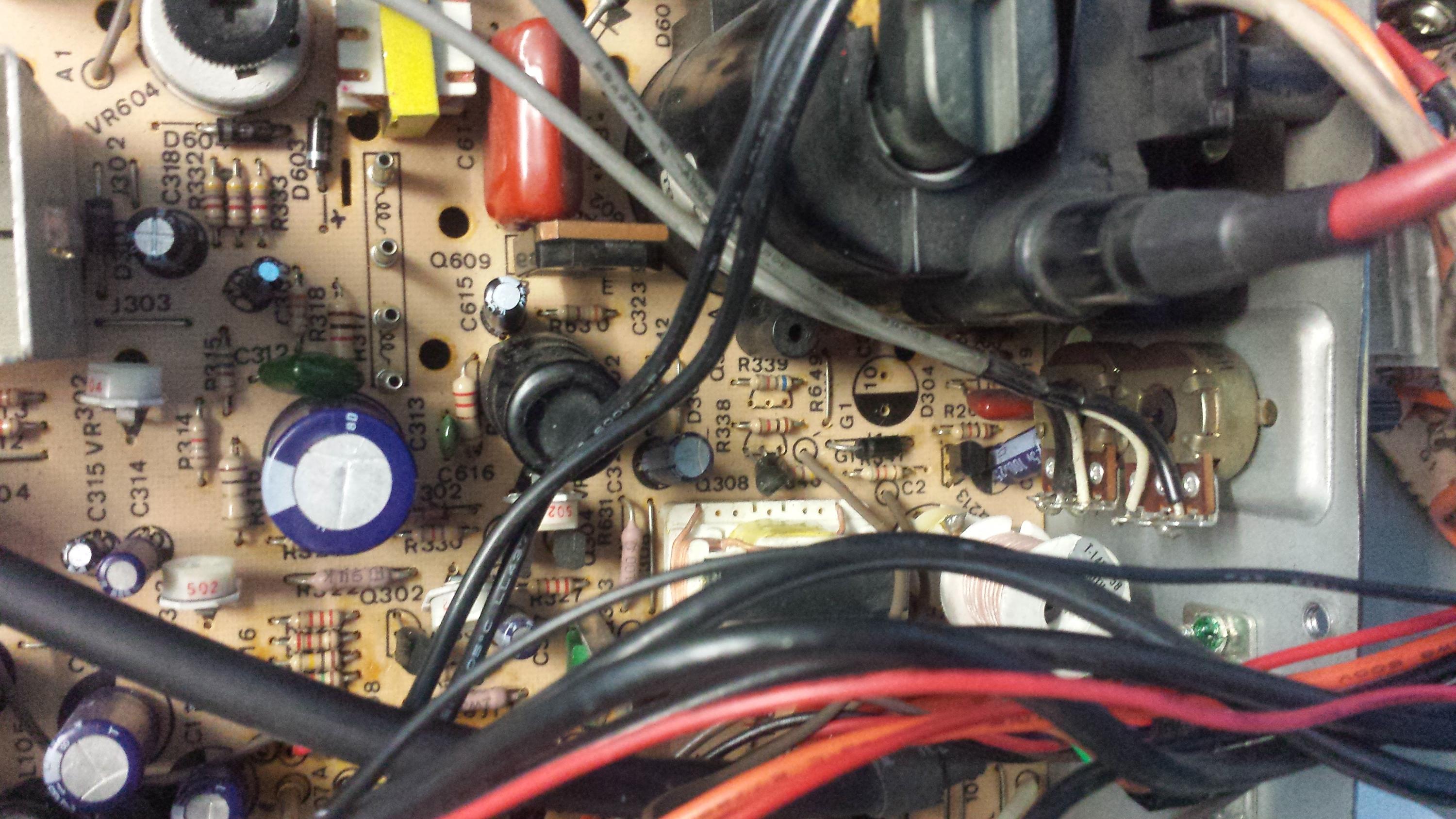

              Here is a picture I took in that area and there are 2 trasistors there. One right aty the back Q203 and Q308 forward of it. Does this help?
                Re: Viglen CRT monitor intermittent jumping
                Yes it does, now if I could only get my meter leads in there to check them I would check Q203 first
                Q308 seems to be part of a different circuit,
                The G1 voltage does not seem to be controlled and is feed straight to the crt neck board. That Q203 circuit could be the ABL circuit (automatic beam limiter)
                There are 2 components I can't see, likely a diode and disc cap.

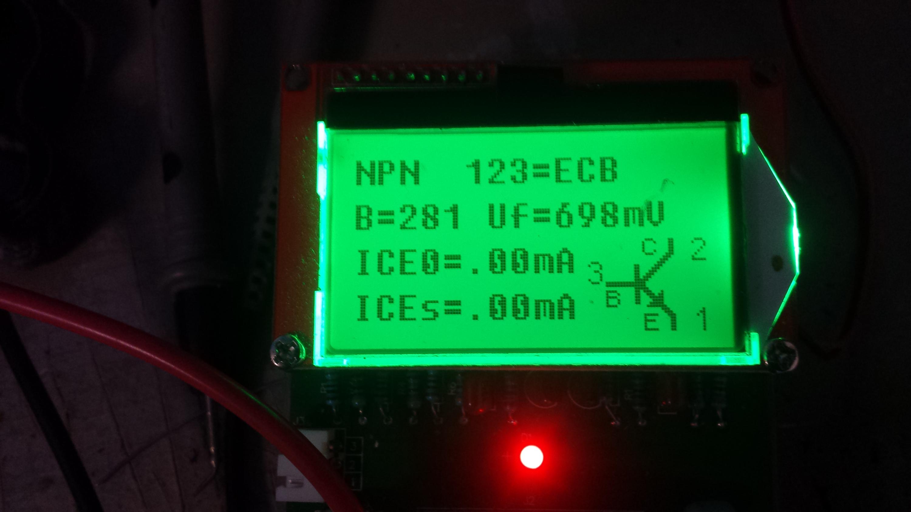

                  Q203 is a LC245P and it appears its OK. Ive checked it on my tester and the multimeter.
                  I also checked the diode below it and it is ok too.
                  Do you want me to check all the components on the other side of that circuit? There are 7 or more transistors there with 4 in small metal cans.

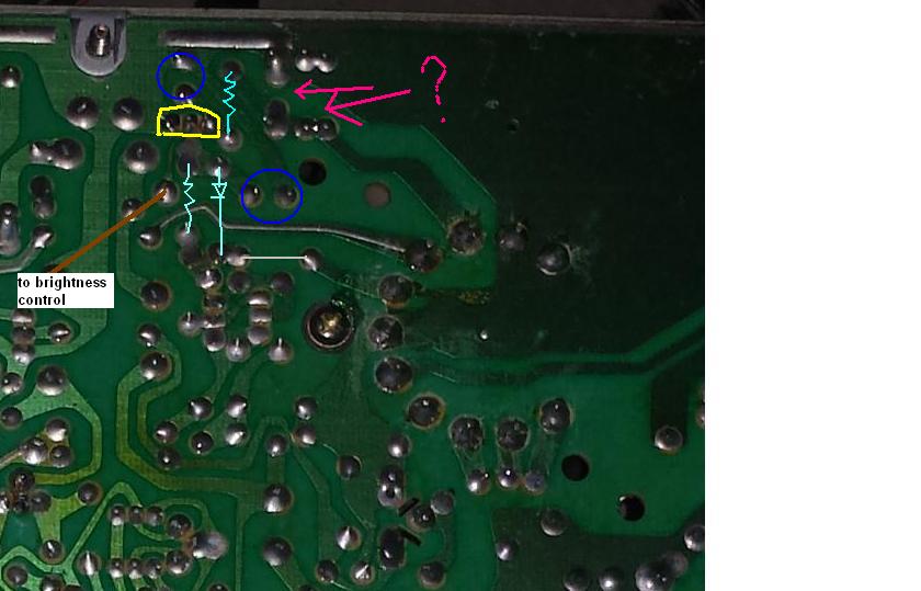

                    What about the 2 components I could not see? what are they ? they come straight from the flyback and go to Q203
                      Not sure but is looks like a couple of resistors and whatever that is next to R264 (a cap I believe not sure what type). See pictures here now electrolytic caps are not in the way you can see.
                        Yes thats a cap, It will likely be ok, I would check the transistor, just check it in circuit to make sure its not shorted.
                        They take the small changes in voltage from the flyback, and apply it to that Q213 base and the collector varies the voltage over by the brightness control via the wire connected to C2.
                        If that part of the circuit is ok, I would check the transistors around the brightness and contrast controls, They should have some voltage on them that varies on the center pin of the control when the control is turned. that should vary the amplitude of the video signal.
                        It seems like the brightness is turned down to minimum thats why there is no video.
