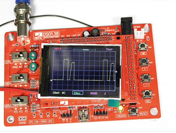

                  Talking of a scope, until I can find a good quality scope would one of these little hand scopes make do?
                  Review here:
                  https://www.elektormagazine.com/news/review-mini-scope

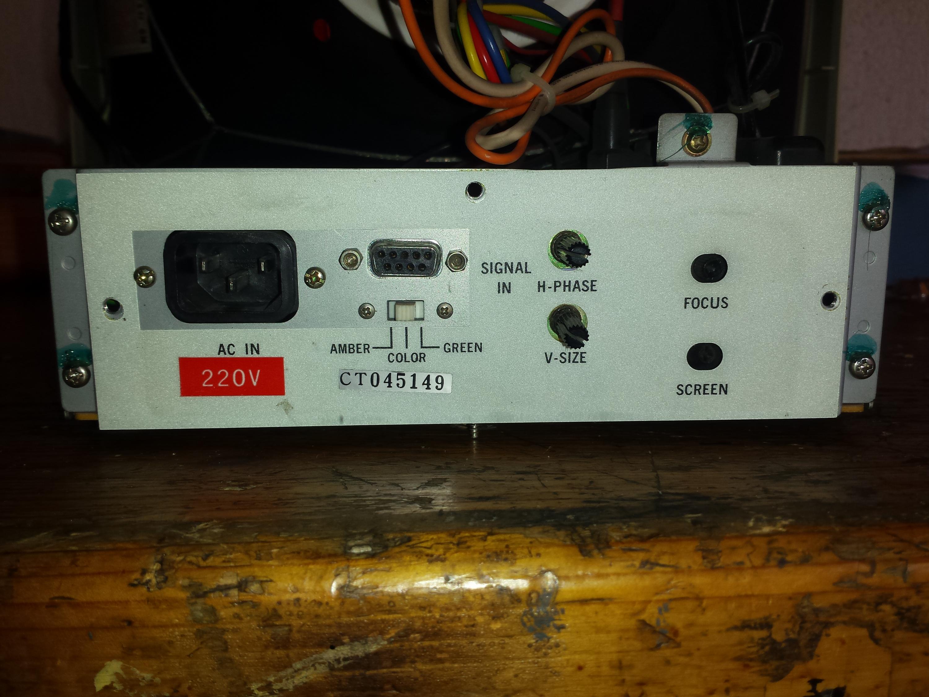

                    Here is a picture that might help locate the screen control.
                    By turning up the screen control it should display a white raster, that will indicate you have High voltage, and horzontal and vertical deflection.
                    If you have those, then the loss of video is in the video signal path somewhere. Make sure the transistors or ic's in the signal path have voltage, maybe the short took out a supply resistor for one of the low voltages

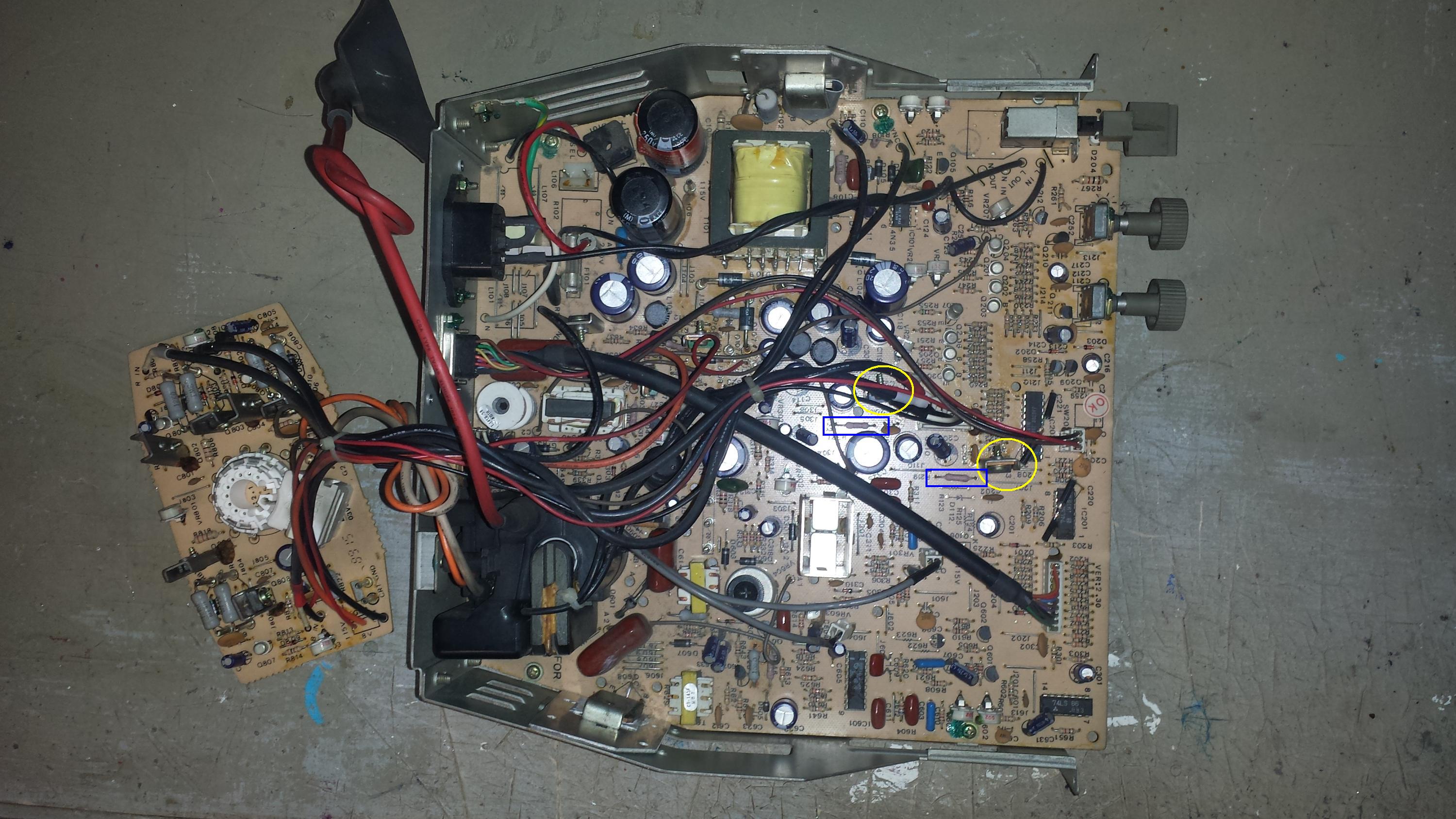

                    Do you have any voltage on R219 for example?
                    I have marked what look like voltage regulator ic's and a couple resistors, If those are regulators, do they have there voltages in and out?
                    I have never used one of those scope boards, It might be ok for audio or low frequency data, (its only 200Khz) It might work for tracing the video signal.
                      Yes have a raster when U turn it up a bit
                      R219 has 8.4v and the other resistor you marked has 18.4v
                      One IC has 4.93v at one leg and the other 11.88v

                          If I was working on it I would connect the crt, and lay the monitor on its face or its side so I could access the botom of the board.
                          I marked two ic's, I suspect one you measured 4.93v is likely a 5 volt regulator that syupplies the ic's in that area. The other ic I marked also looks like a regulator as it has the center pin at ground.

                          I took your picture number 20181015_123005 and flipped and rotated it. that way the components match the bottom picture 20181015_205603. then with them side by each you can figure out what components connect to the traces.
