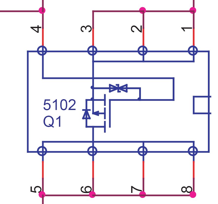

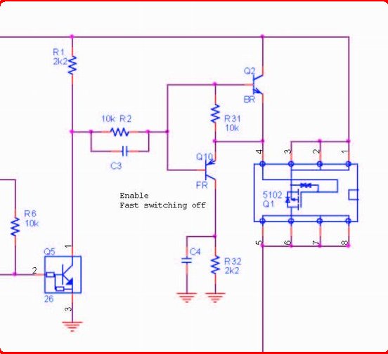

                        Using this chematic , I traced the 12.29v that get to the inverter up to this IC, labeled 5102. It is a 8 pin (4/4) Ic. I can't find a datasheet for it (I only found 10 pins versions and I don't know if it is the same).
                        Here is a section of the schematic showing only the IC and its surrounding components.
                        This is the internal schematic/diagram of the IC in question, according to the schematic:
                        There's Voltage reaching pins 1~3.I tested with an ohmeter, and there is no resistance between them, as the picture suggests.
                        12v reach pin 4 too, but come from another source (Q2 output).
                        BUT NOTHING COMES OUT OF 5~8. No voltage reaches L1, so no voltage reaches the Transformer(s) and no backlights.
                        May I conclude that the IC is bad because there's no output?
                        That is a MOSFET but with 8 pins instead of 3 (1~3 - 1st Pin, 4=2nd pin, and 5~8=3rd pin).
                        Also, in case this is damaged, where can I find a replacement if I can't find a datasheet? The last pic is of the IC under suspicion. It has only 5102 , and two more characters that I cant see if they are DL, 01, or something like that.

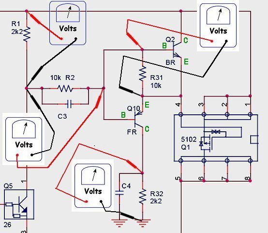

                          Check transistors Q2, Q10, and diode D1 with ohmmeter.
                          Conclusion correct. Transformers match and are fine.
                          >>May I conclude that the IC is bad because there's no output?<<
                          No. You can only conclude there is no output.
                          After (if) transistors and diode check out, then hook it back together with tubes in place. Turn it on and with DMM give me voltages ACROSS the following resistors:
                          R1 (-) probe to R1-R2 junction
                          R2 (-) probe to R1-R2-Q5 collector junction
                          R31 (-) probe to Q10 emitter
                          R32 (-) probe to Ground (+) to Q10 collector

                            Its one of those mosfets like on motherboards maybe. Like one of these:
                            http://www.st.com/stonline/products/...sts4c3f30l.htm

                              I'll make that notes and post back the result of the test. But now I have another question.
                              So far, the transformers are ok, there's input on pins 1~3, and in pin 4 too, and all are 12v (12.29v), but no output.

                                  I WAS measuring. Just was interrupted while posting...
                                  The question is : if there's input, why there's no output?
                                  I don't disagree with your conclusion that I cannot conclude it is bad, just I don't understand it. But well.....
                                  1.- I tested the diode (off circuit). In Diode Test Mode (DMM) it shows 158 in one way and nothing the other way.
                                  3.- As references to R1,R2,R31 & R32 I checked them to see if the values were equal to the ones specified in the schematic, and they were (R2 & R31:10K, and R2 & R32 : 2K) - Not asked for, but I was there anyway.
                                  2.- Q2 & Q10 are too small, so I took another board with similar components and tried desoldering them and then putting them back: I can't, so the readings are IN circuit
                                  Q10:
                                  • E-C+ : 400 ohms
                                  • E+C- : 400 ohms
                                  • B+E- : 10,000 ohms
                                  • B+C- : 20,000 ohms
                                  Q2:
                                  • E-C+ : 10,000 ohms
                                  • E+C- : 400 ohms
                                  • B+E- : 400 ohms
                                  • B+C- : 1500 ohms
                                  Voltages:
                                  • Q2 has 12v in all 3 contacts (11.99~12.06)
                                  • Q10 has 11.91v in C and 12.03v in E, and B is GND (???)
                                  • R1,R2 & R31 had 12v. R32 has no V applied to it
                                  • (+) on V input of the inverter and (-) on D1,I get 12v.
                                  • (+) on V input of the inverter and (-) on 5102 pins 5~8,I get 12v.
                                  • (+) 5102 pins 1~4 and (-) on 5102 pins 5~8,I get 12v.
                                  • (-) Probe on R2, I get -12v on Q5 C & E & R31 had 12v. R32 has no V applied to it
                                  Between Q10 base and GND there's no resistance (or too low to measure).
                                  I tried to do what you asked, just remember I'm a software developer, not an EE, and I'm trying to keep up with you guys....
                                  And as for the 5 inverters lot you saw on eBay, the lady has like 70~80 dead inverters, so maybe I'll invest $20 on getting 5 of those, or I can invest the same $20 to get a VL150 4 outputs inverter from her, adapt it and get the 1830 going.

                                    Okay, I am not getting through. I have to think of another way to get you to measure the voltages ACROSS the components.
                                    The diode check looks good and the 2 transistors do too.

                                        Completely back together, all hooked up, and powered on.
                                        See the attached pic. Read voltages as shown with your DMM.
                                        Voltages ACROSS the following resistors:
                                        1) R1 (-) probe to R1-R2-Q5 collector junction
                                        2) R2 (-) probe to R1-R2-Q5 collector junction
                                        3) R31 (-) probe to Q10 emitter
                                        4) R32 (-) probe to Ground (+) to Q10 collector
                                        Voltages:
                                        1 =
                                        2 =
                                        3 =
                                        4 =
                                        LMK

                                          I guess got the idea the first time. The problem was finding that damn junctions in the circuit : everything is so small. 1st Round was a draw cause at least I got the readings for the diode & the Qs. I want to win the 2nd.
